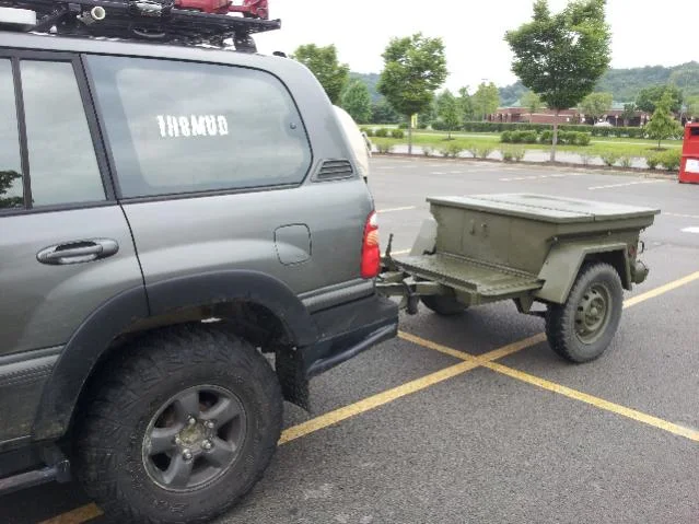

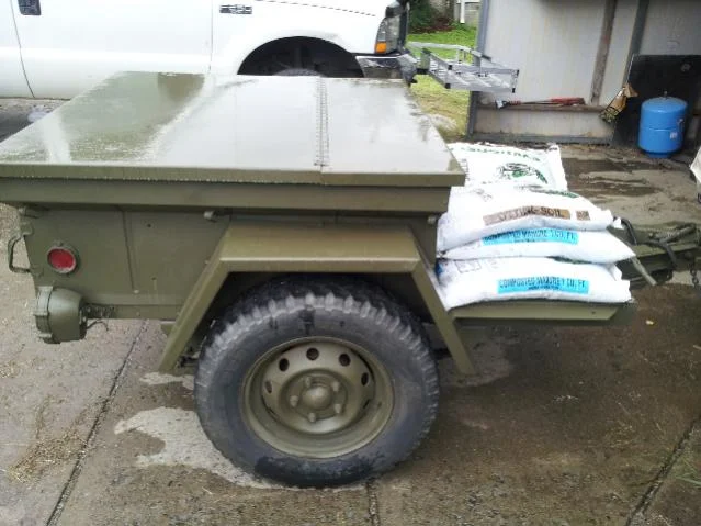

Got a new trailer m416

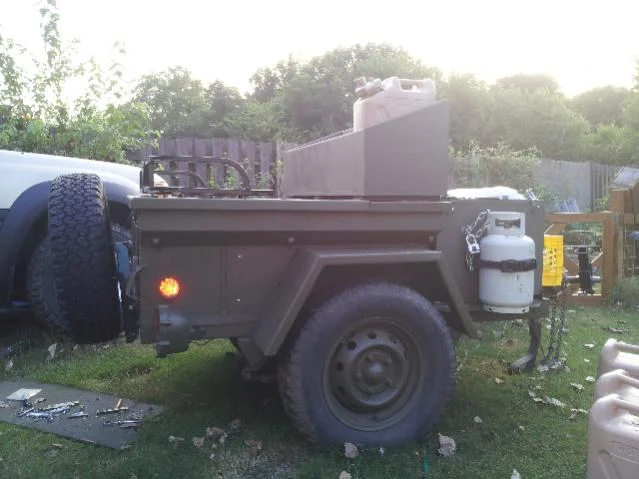

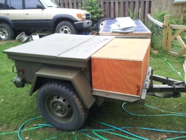

Went to pick it up this morning.Gonna put a box on the front.
No spare wheel ,but will get one soon.
Any tips for power to work on cruiser?
That's a bird of a different color. Makes me wonder if it met with an accident and the chop job made the best of a bad situation.
The front rack would be good if you had a buck or doe to bring home. Not too high to lift and hoses off easy. Just throw a tarp over it if you have lots of unpaved road before the blacktop starts.
Cool trailer. (nice decal in the back side window too)
My much better half would like the ability to haul yard or any smelly stuff outside our rig.

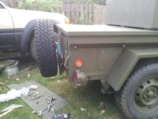

If the spare tire takes up to much room, one of those self tire repair kits may be a good choice. (IMHO)

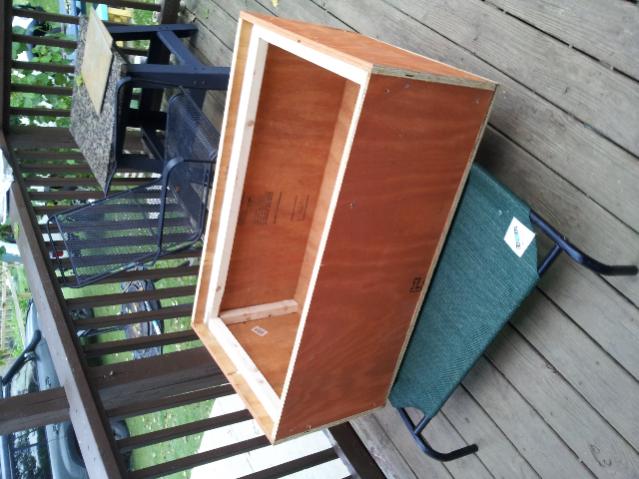

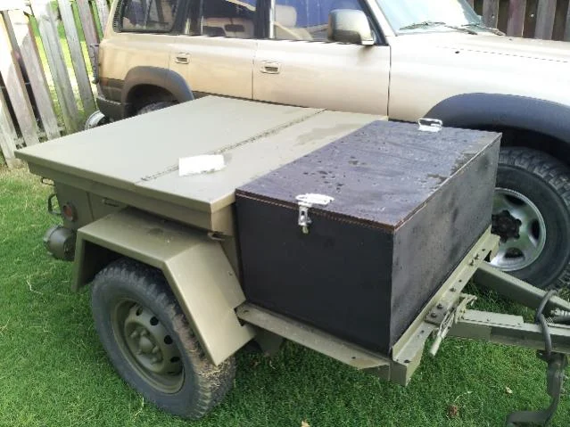

Sweet box build. Like the fact that its removable too.

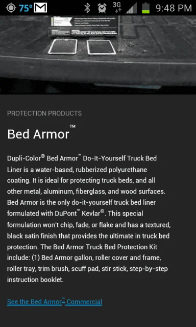

Started to build a box lastnight.gonna put bedlinner on it
I didn't know you could put a bed liner on wood. Does the wood must be prepped differently than metal?
I am envious of your wood working skill.
Dankie man.

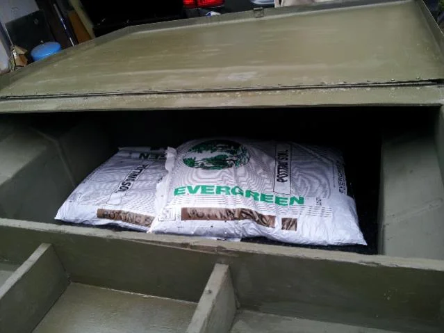

I have put weather stripping on the inside of the lid and it had been raining a few hrs sins then ,all dry inside ,should keep dust out also

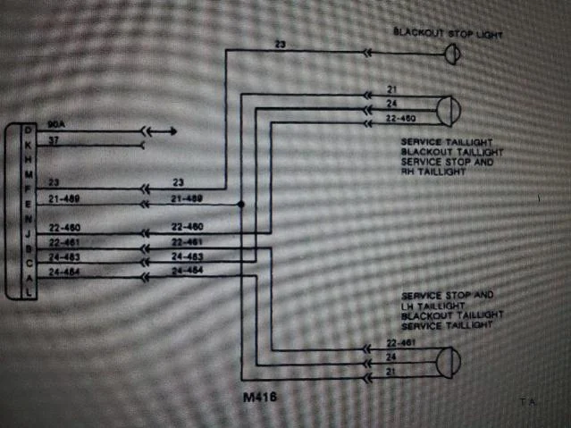

This may help someone.
E=21 nighttime running lights.
J=22-460 =rh brake and turn.
B=22-461=lh brake and turn.
D = ground

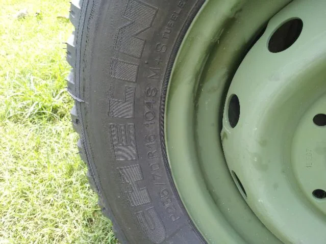

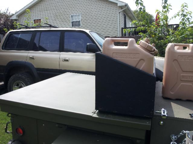

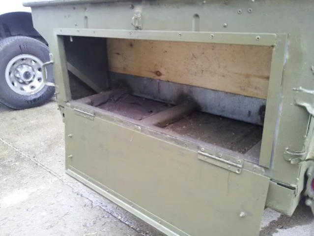

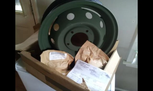

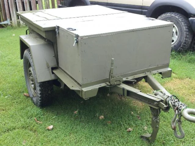

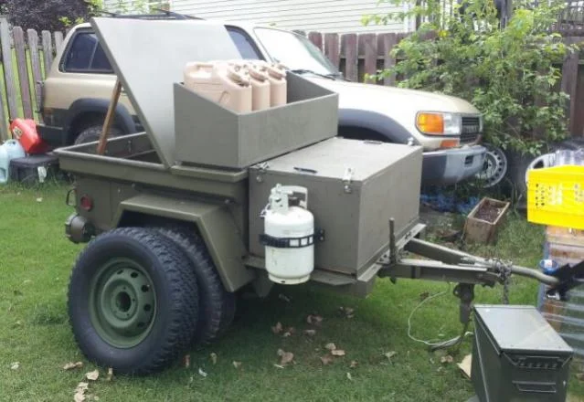

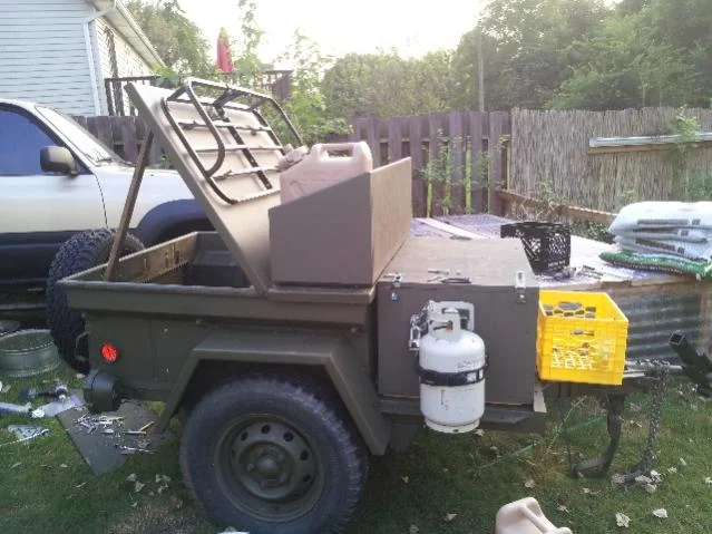

Its done for now.Gonna order a spare wheel today . I think I got all the space back from the chop job and its all waterproof

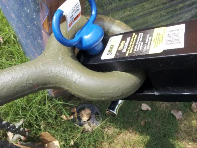

Added a few things.It will hold 6 cans and I may cut it a bit lower .Got a retreat for a spare ,$68 from shop that make them in nashville.made a lock with clevis hitch .gonna put cargo carrier on as a little roofrack
