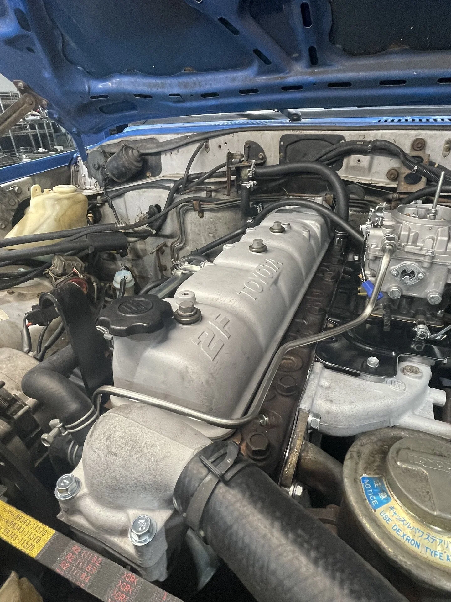

The good news is I successfully installed a new carb, changed the oil pan gasket and have no leaks, and got the valves adjusted. All of this is new knowledge to me. The bad news is I have a coolant leak on a hose that I think may be discontinued…
Using this thread I think I need hose 87245A.
Is that hose still available? If not what are my options?
I think m replacing all hoses may just be my next project and using the above thread to source parts is my plan.
Yes, that hose is discontinued. Just use a high-quality 90* replacement ( and cut-to-length).

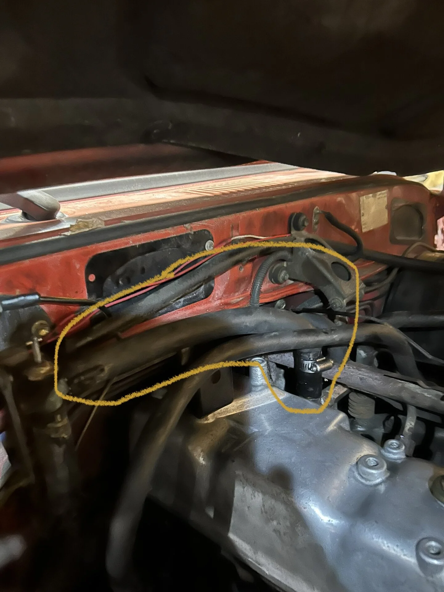

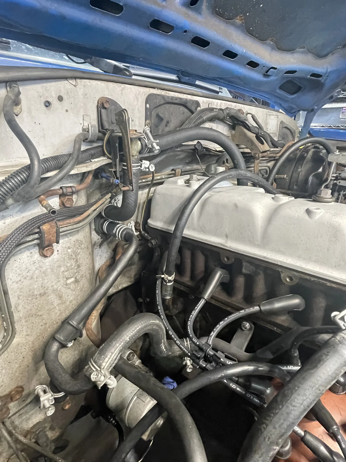

For those deleting the rear heater, buy this from @ToyotaMatt and use it to replace the double “tee” to feeds to the heater valve and pipe that runs behind the head and just run a straight 5/8” hose from the head to the heater valve.
Eliminate a bunch of leak points and hard to reach hoses.

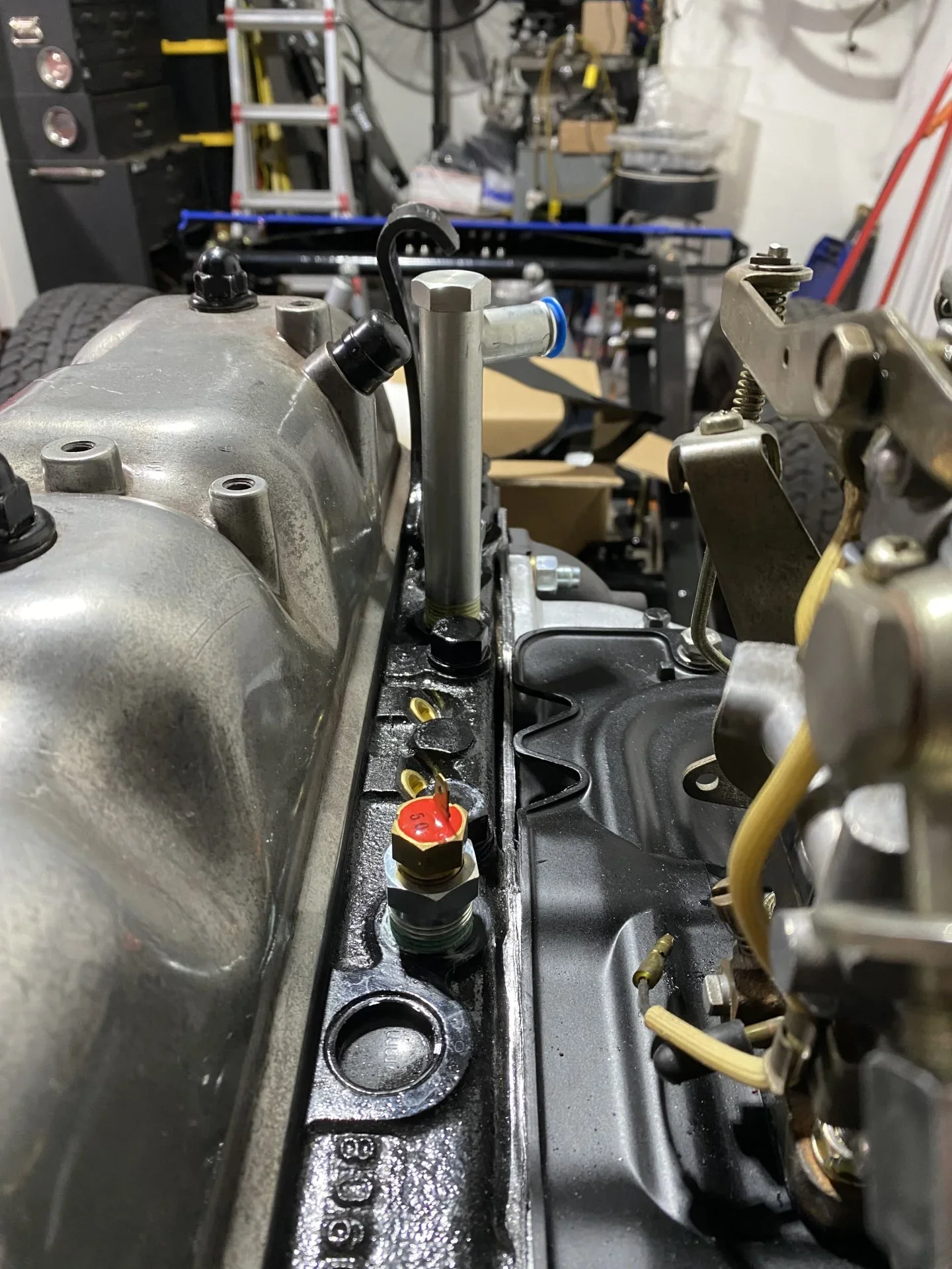

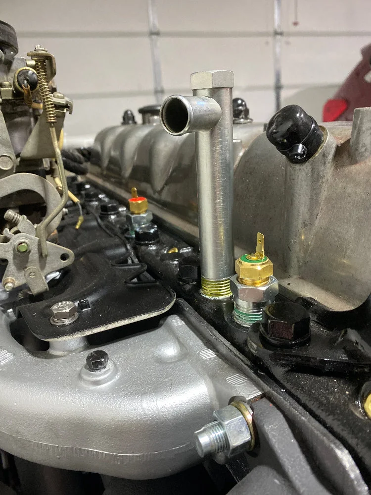

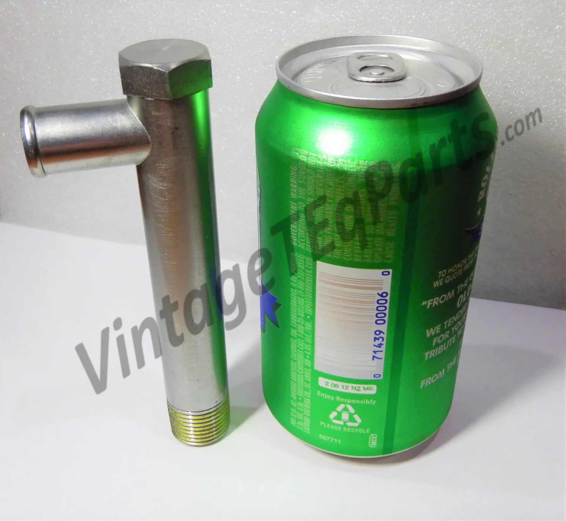

in the past , this would be the more desirable solution , as @cruisermatt outlines very well here , ....
things like this rear heater delete Technical topic are constantly evolving , as all things do in the Land Cruiser universe we all share ,,,,,,
i plan to incorporate my new and absolutely killer kool little oem buddy here below ...
- it WILL clear the TOP of ALL 2F valve covers , NO need to pull it off here ,
- NOTE : this is a FJ40 2F , hence the the top port facing away like it is .....fyi
- also , the top port sets you and your now STRAIGHT-LIKE heater hose for nothing less the fundamental success ....
- i like when things constantly get better , i like this alot :D
.View attachment 3481540
