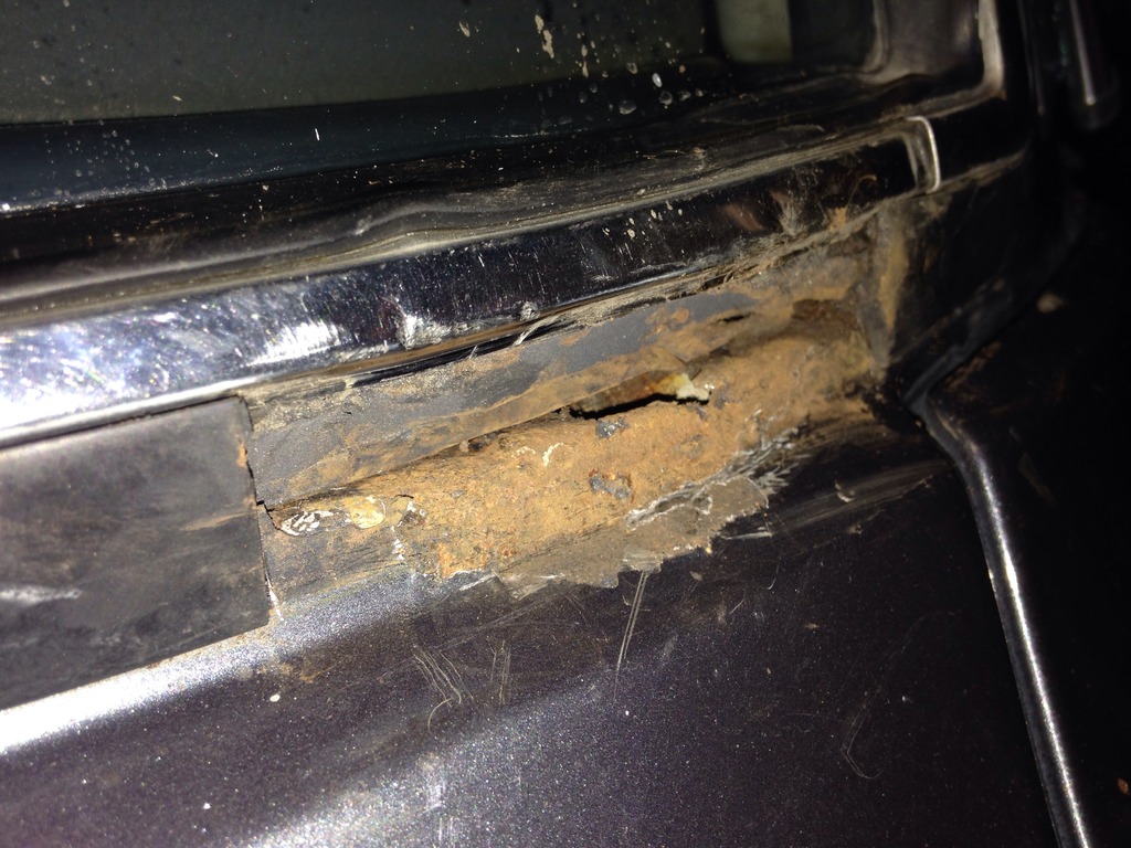

My 62 is pretty much rust free. I did a good wash today and found a nice section of rust forming on the lower drivers side, right below the windshield. I cut a section of the gasket and found I really should have it repaired correctly. I need to come up with a quick fix for now so I can go wheelin next weekend. Ive had some work done on other cars at other places, and I was very unhappy with them. Here is the damage and any suggestions for a temp fix?
Careful, if you start picking at that you will not be on the trail next weekend, you'll be pulling your dashboard and shopping for a new windshield gasket... Let it be this week, spray some ATF, or rust prep stuff and forget it for now.
