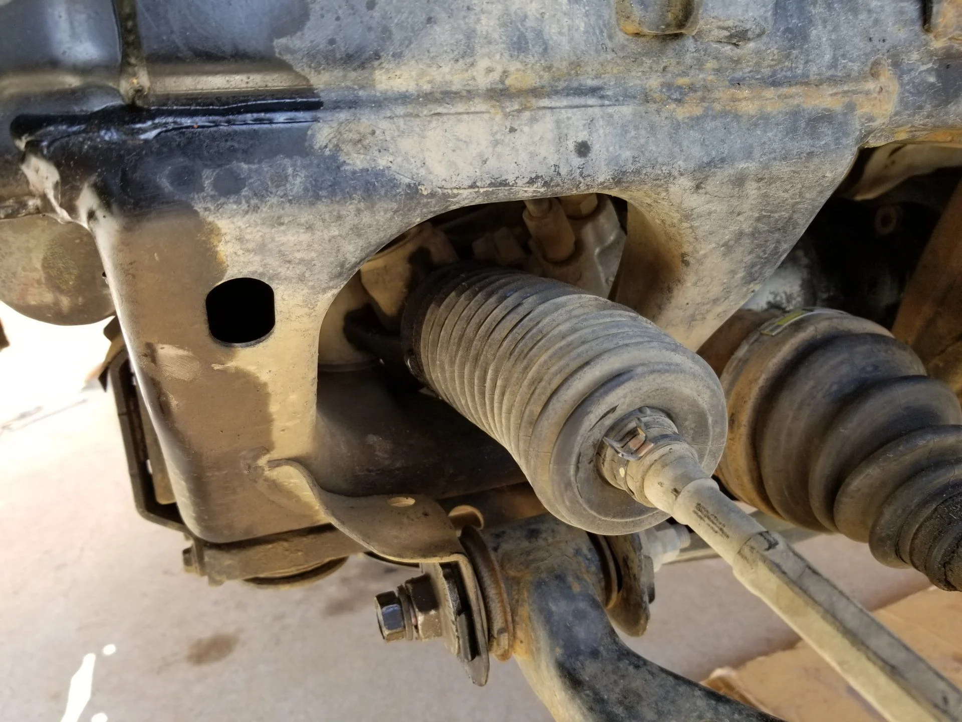

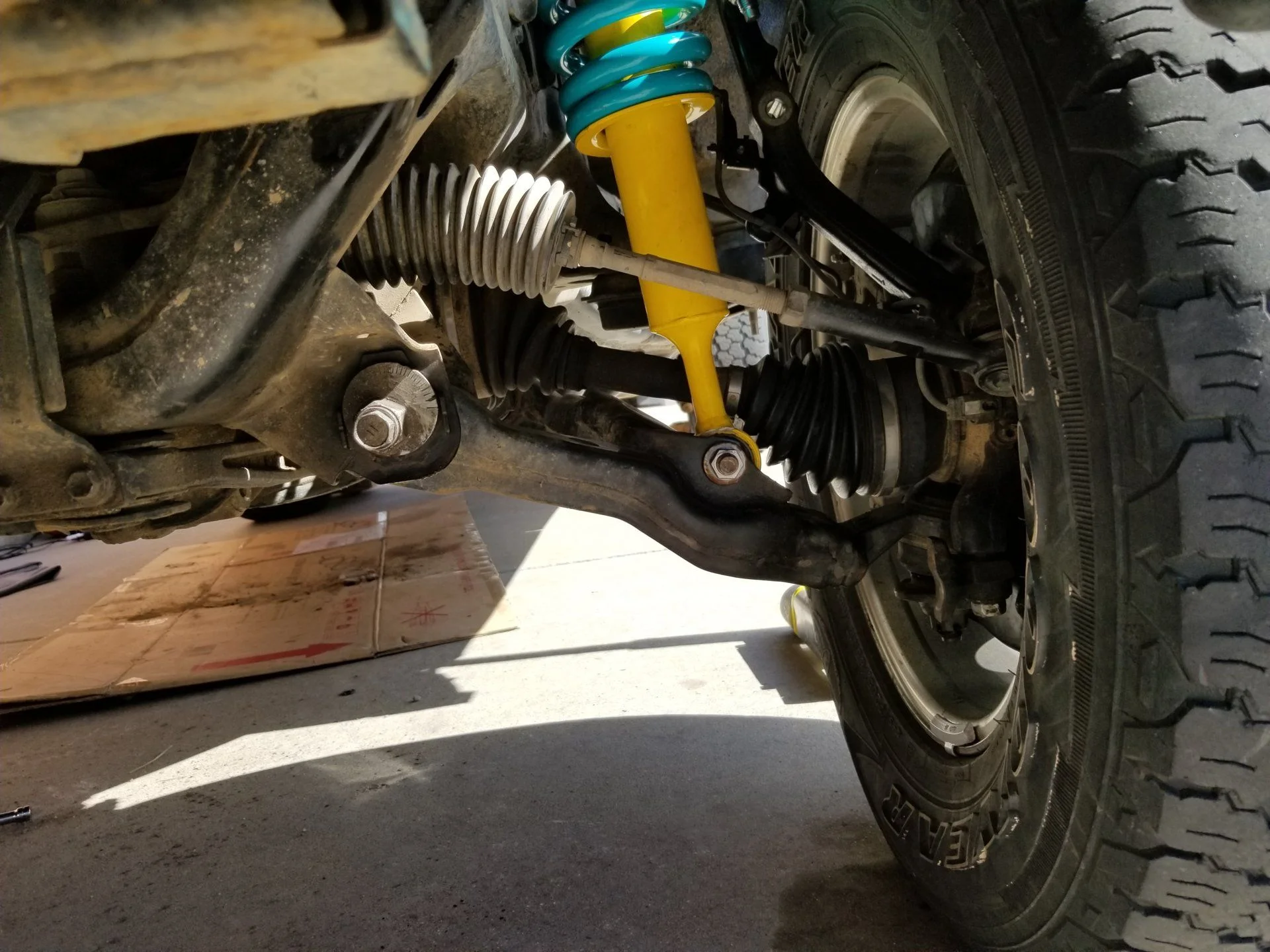

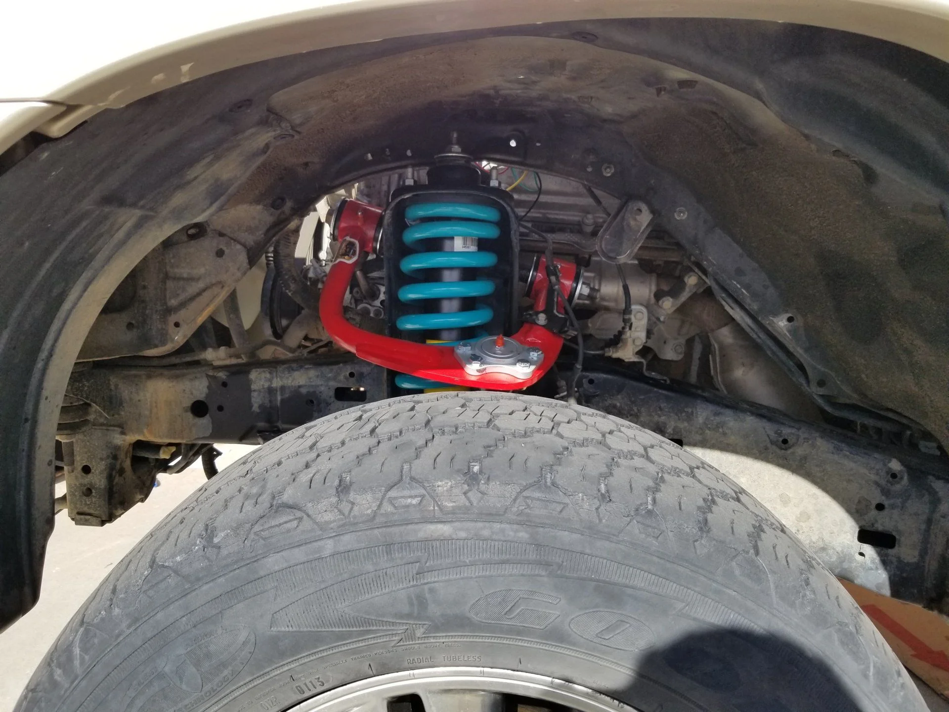

Got the JBA and 3in dobinsons front today. The height control hex screws weren't fun at all!
Took about 14 hours between two days with hand tools and Jack stands. Made sure to grease all 6 zerks on the UCAs and torque everything down to manufacture specs when wheels were back on ground.

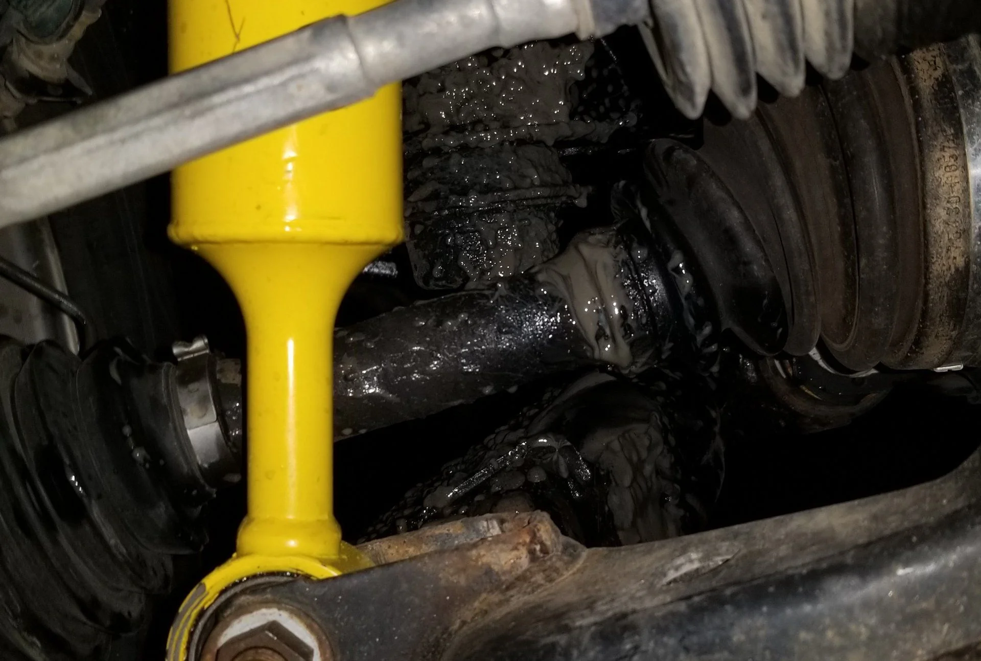

Couple things. I noticed one of the boots on the driver side looks kind of wet. I'm no mechanic so I'm not sure if I need to do something about it. Doesn't leak on the ground or anything. (Pics all below)
Also maybe I should do the diff drop, CV angle looks ridiculous, but again I am no expert. Would it be fine to ride around with for a couple days like that in the city streets?

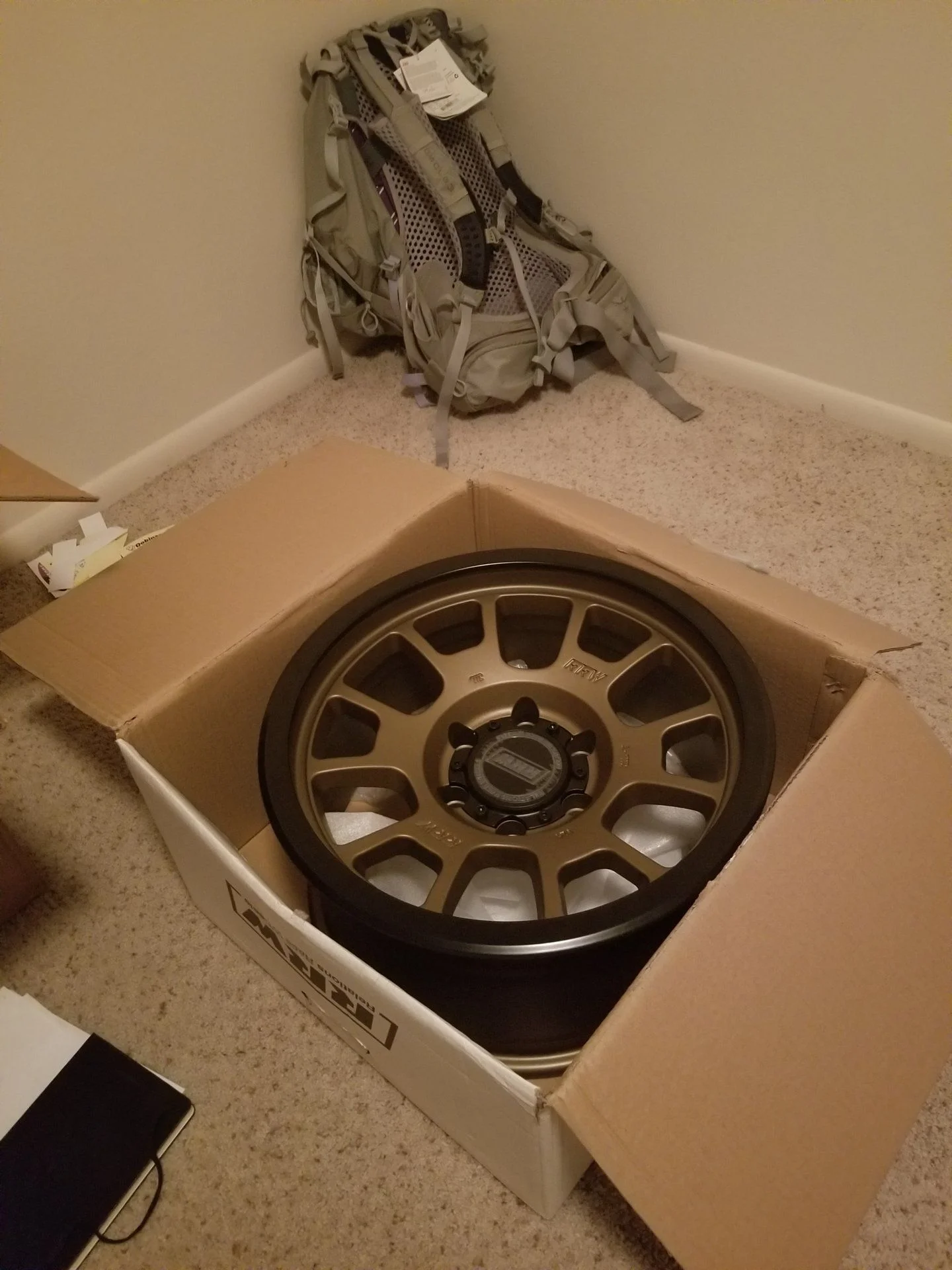

Also got some RRW wheels in. Still deciding on what tires to go with.. pretty set on the 285 75s 17. The wheels are 17x8.5 with -12 offset. The finish looks and feels well done.

Keep an eye on your CV boots to make sure they are still clamped tightly around the shaft. Mine leaked after lift install so I threw in some CVJ axles with high the angle boots.
Sure enough my boots started leaking. I didn't have the time or patients to replace them myself so I had les Schwab do them. We also noticed the passenger side tie rod needed replacement so I had that done as well.

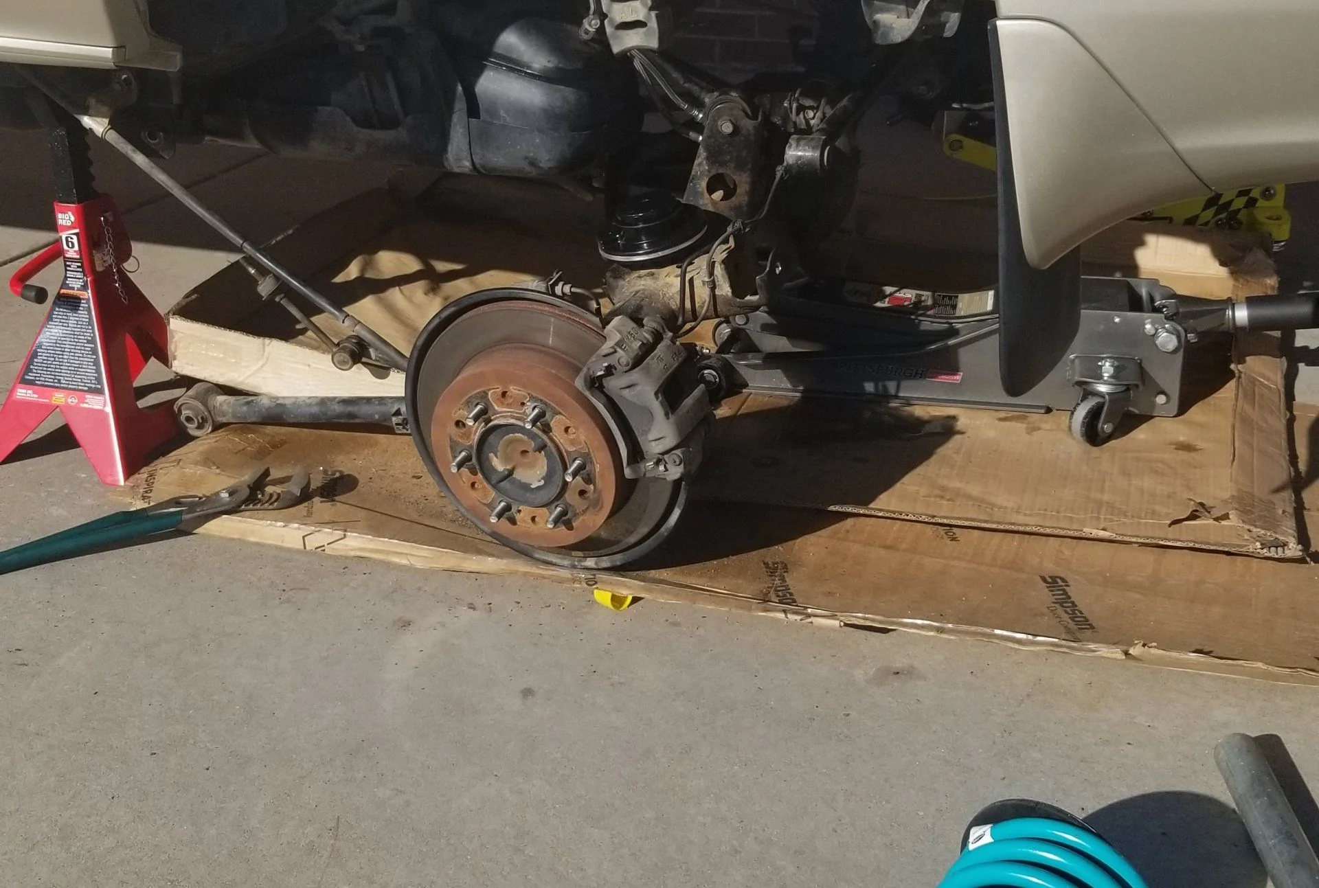

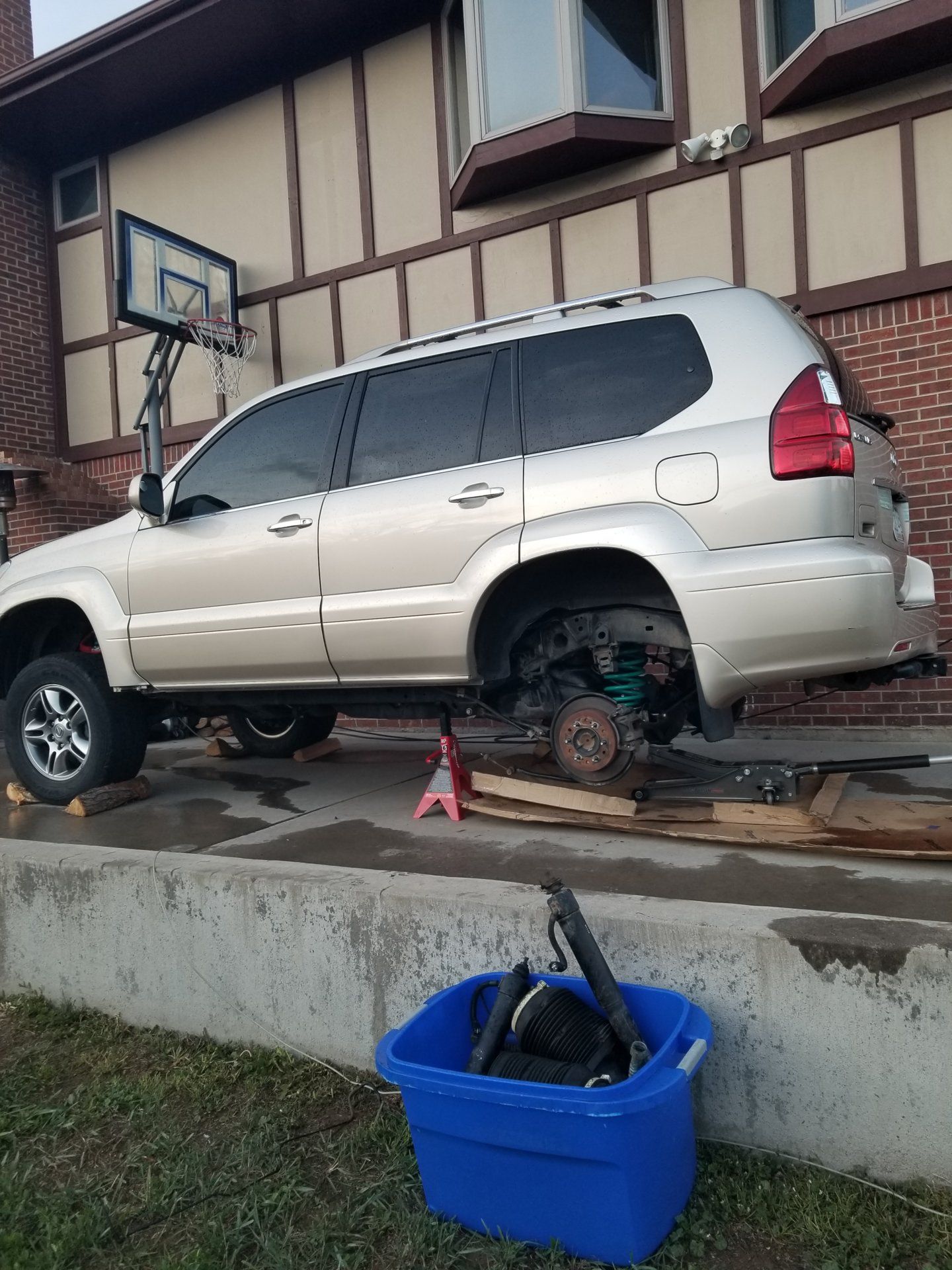

Getting the rear done was quite challenging because I had never done it before. In order to fit the dobinson gs59-677v springs I had to undo the panhard bar and both upper and lower control arms and lower the diff as far as the Jack could go. The most difficult part was getting the links back in place. I have had no lights or codes from removing the air suspension.

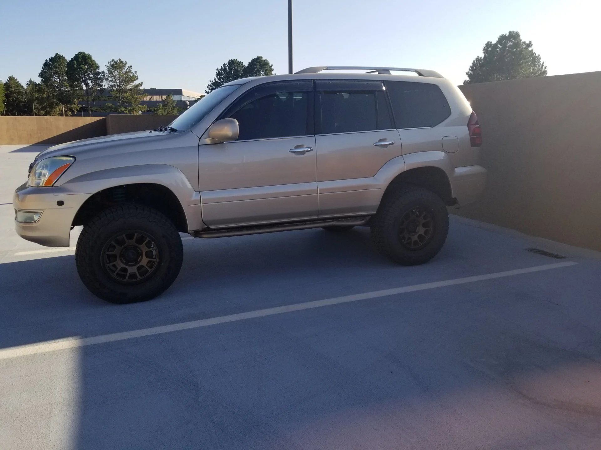

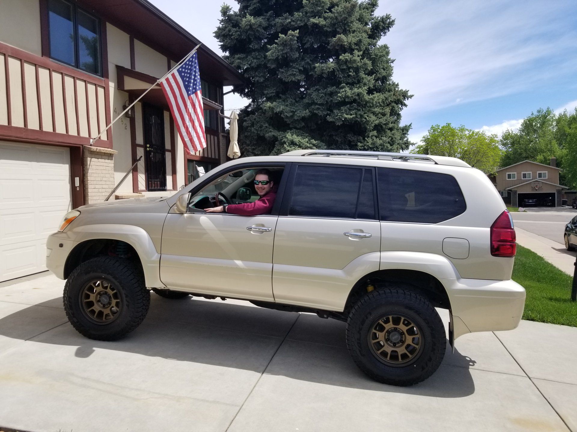

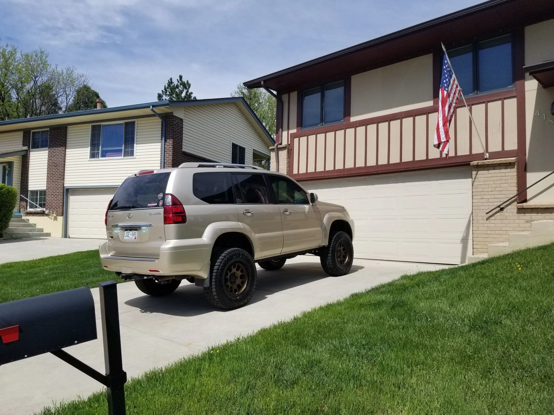

Today this is how she sits. I'm very pleased.
Next I will get the SSO woodgrain warrior sliders out on, radio rubber guards, and wheeler bump stops measured and installed.

Shout out to Steve (co4wheel). This job would have been far more frustrating if it wasn't for his rear long travel expertise and willingness to walk me through the steps.

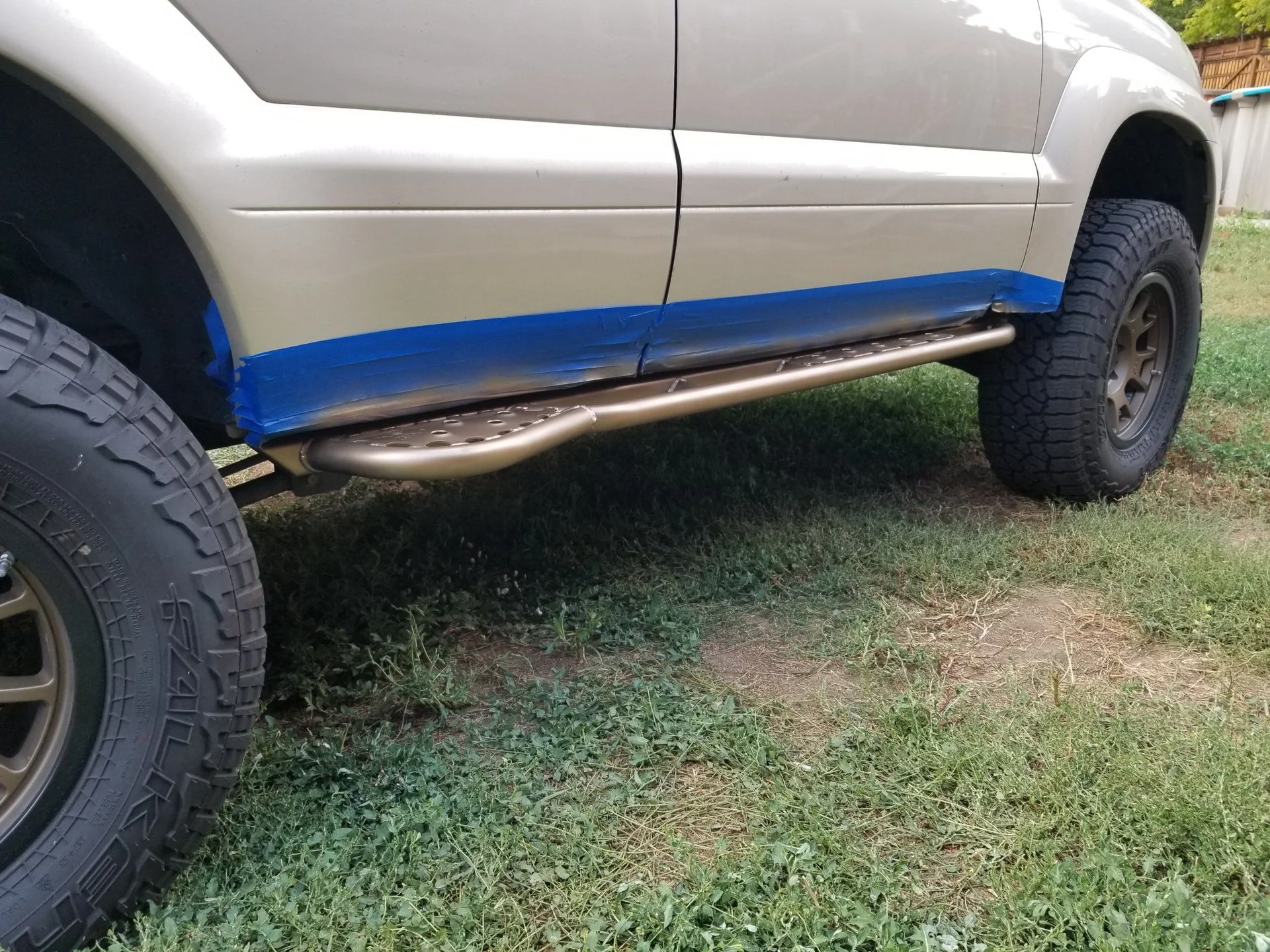

Next update will be woodgrain warrior sliders welded on. Going to paint them bronze. Still deciding on which skid plates to get. Might get ARB and paint them because I could get two pairs for the price of budbuilt and RCI and have one on hand to replace if damaged too hard. Considered ASFIR but I've researched other running into fitment issues...

Since my last post. I have added SSO sliders (big thanks to Steve), put whiteline bushings in my LCA,s and had RSG do a complete fluid overhaul and TC cam tabs. I had been riding without my front and rear sway bars for a while and kept having my stability control come on during long highway sweepers. I have put both front and rear sway bars on and my steering is so much tighter and the body roll went away. I am debating taking the front off and leaving the rear on

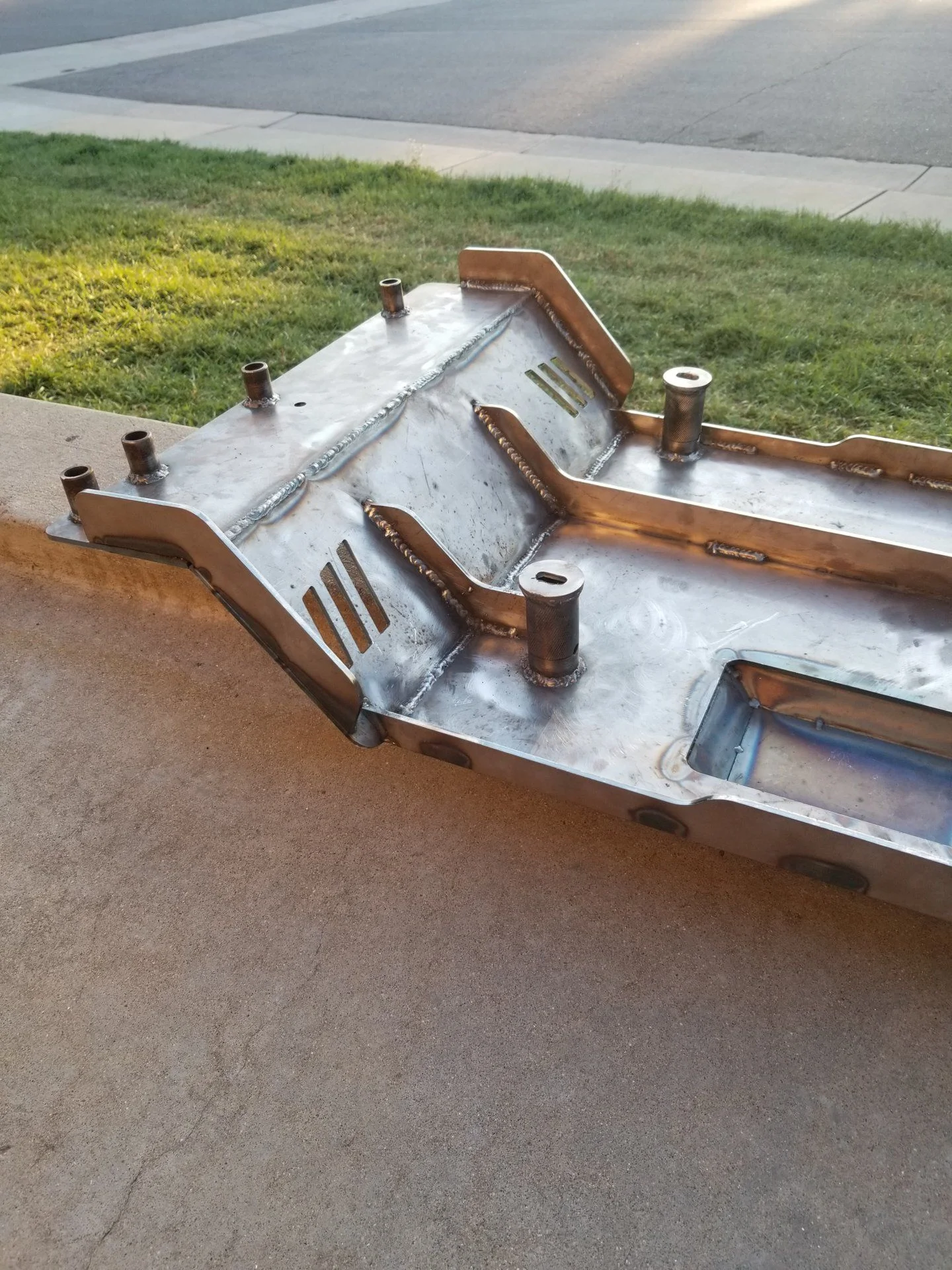

That is because I had a buddy weld together my coastal offroad DIY skid plates for a welding school project (yes he did them right) and they do not work with front sway bar.... of course they don't tell you this. Pretty frustrating actually.
In order to get them to fit with my diff drop (still not sure if I should have done that) I didn't want to use dinky toytec spacers and welded on DOM tubing to extend the mounting points to account for the skid plate.
Anyone else have this problem with the coastal offroad skid plates? I wish I had just went with a different skid plate set up. It will work without the front sway but I feel like I need it on...
Brandon's truck does not run front swaybar. Its a mistake on their own that they forgot to account for the swaybar.
Would it fit of you cut the side vertical brace completely? Most skidplate does not have that reinforcement.
