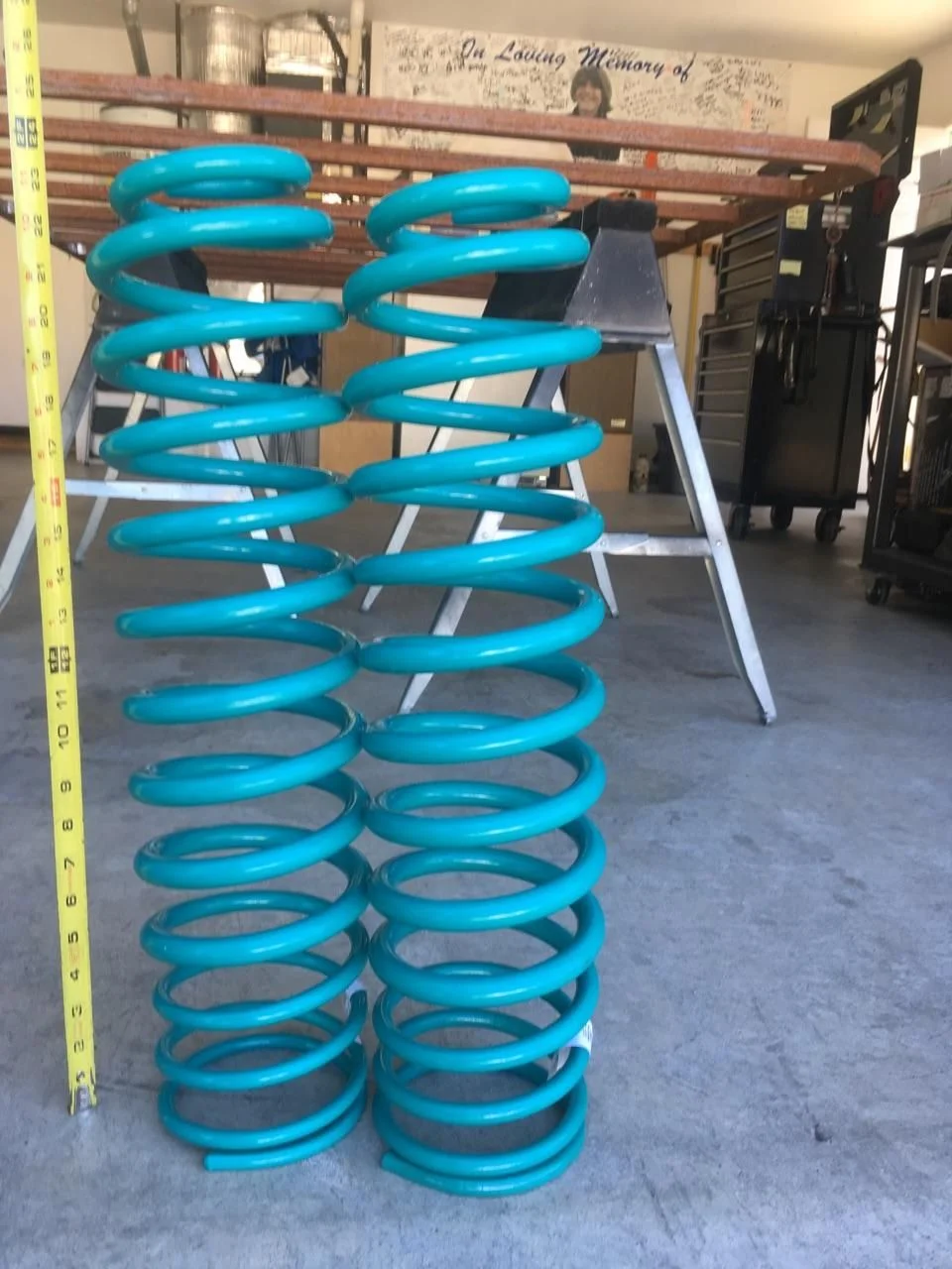

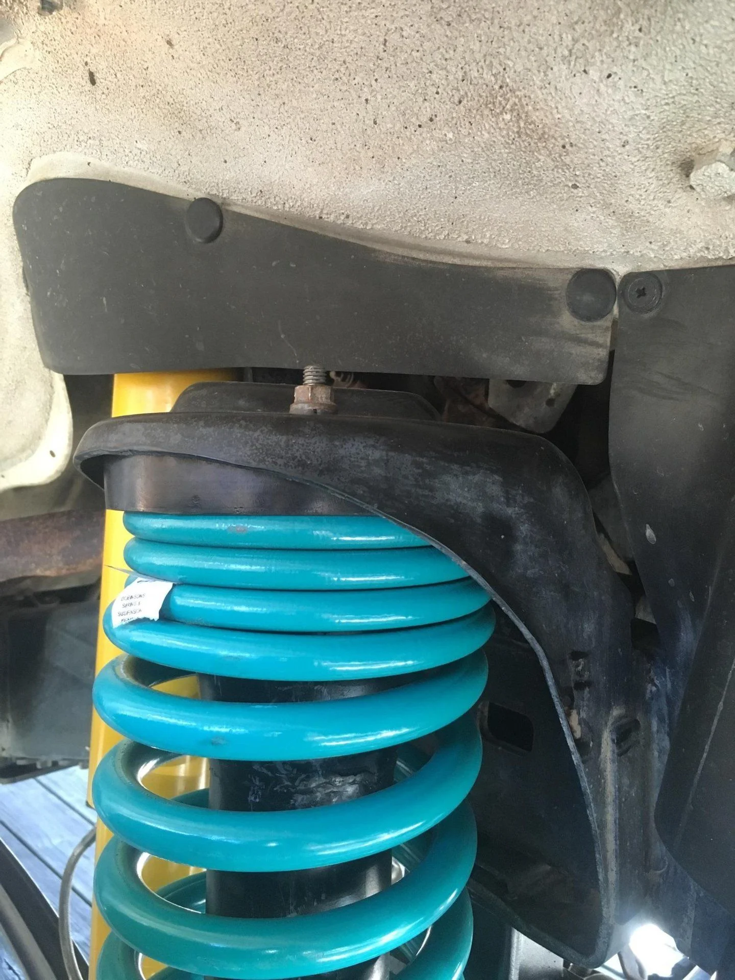

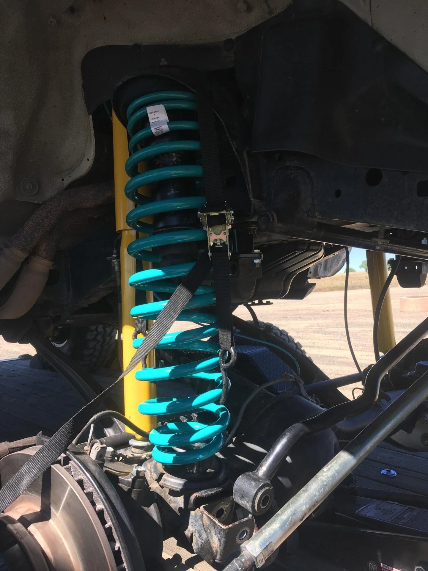

Below are @baldilocks coils.
View attachment 1555435 View attachment 1555436 View attachment 1555437
