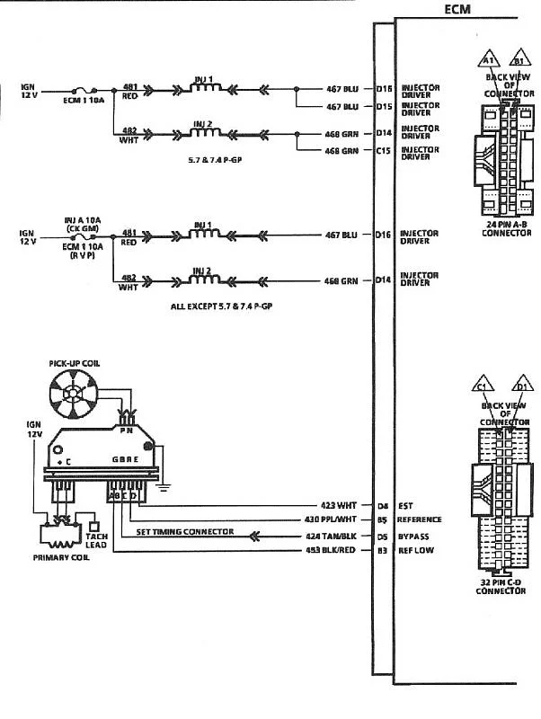

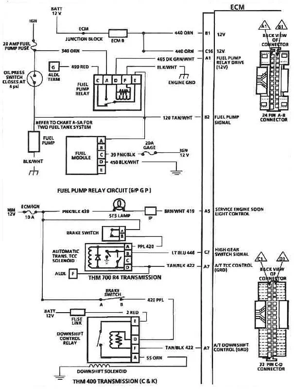

TBI wiring diagram (partial). I don't know how your truck is wired, but have you got 12V (as designated by IGN or 12V IGN) to the fuel pump circuit, ECM fuse, and the primary coil (all as shown down the left side of the diagram) with your ignition on? Perhaps it's fused or perhaps it's hardwired and the connection(s) failed. Also make sure you have the Batt 12v as shown at pin B1 of the ECM.

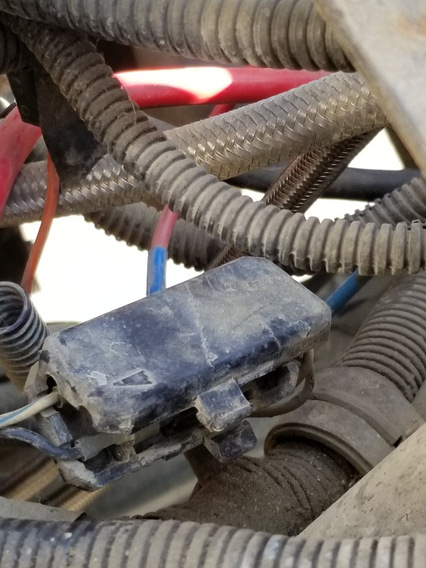

I also went nuts looking over many connections and checking every fuse I saw. I found this unknown fuse and found that it was blown. Replaced it and have not noticed any difference. I will have to find what it goes to.

Reference is a voltage reference signal - which is just a silly way of saying it's a lower voltage signal from the ecu usually its 5v.
Reference low is the ground that runs back to the ecu.
+ is 12v
C is to the coil
Like I said earlier- if you aren't getting fuel nor spark this is where I would look.... the only way the ECU knows what the engine is doing in order to provide fuel is through the distributor.
