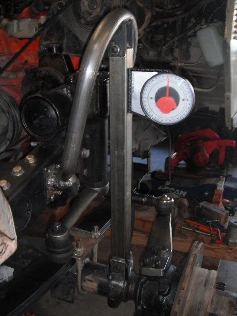

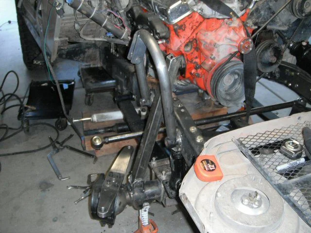

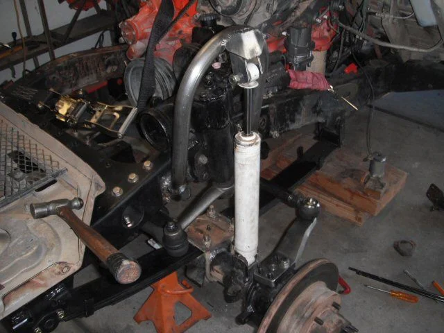

Found some more garage time this weekend. Finally, a complete shock hoop! After many trial and error attempts to get just the right spot for the shock all through the suspension travel, I think I got it. Now the other side should be easy breezy.
pics:
finding the spot
final set up
Thanks for the comments. I'm needing a little encouragement after the time it's taken to get past this power steering and drivers side shock mount. Lot's of this :hhmm::bang::hhmm::bang: Wouldn't be this far without the help of my good neighbor the fab guy loaning some key tools.

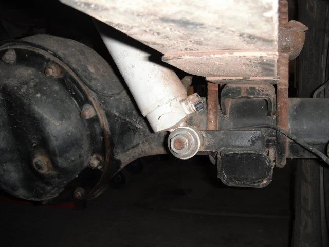

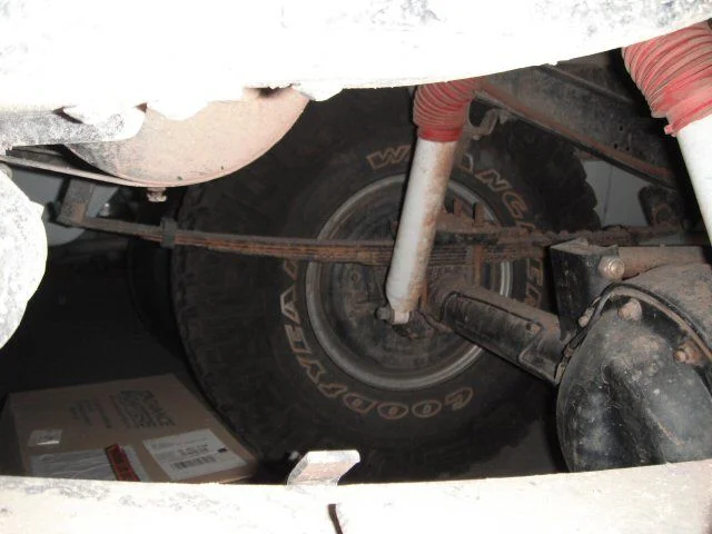

My rear shocks are pretty much mounted the same as stock. Except I added a tab to mount move the lower mount when I did the rear SOA. Been working okay like that for a long time.
Passenger side front hoop 90% done in one day! Man it goes a lot faster when you know what the parts are supposed to look like before hand. :rolleyes:

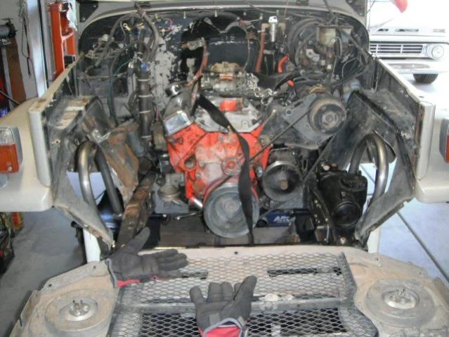

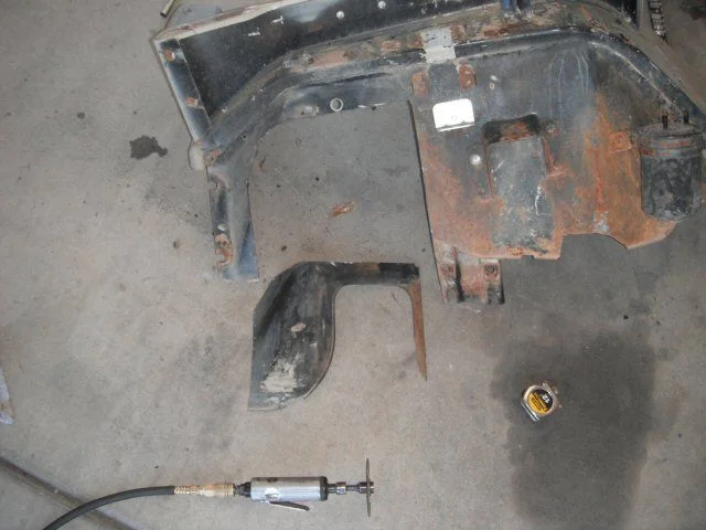

So I think I've passed the fab hurdle of Scout power steering/SOA/Hi steer/shock relocate. Minus some final welding and painting once some things are out of the way. Next stop is to revisit the radiator. I need to cut some stock brackets off yet. The plasma cutter was unavailable this weekend so I shifted back to the putting the Orion together and started tearing down the organ donor.
pics:
Big trim on the passenger fender well.
Final hoop and fender mockup.
Mr. Orion & transplants on the bench.
Your build is coming along nicely,the hoops look great
Thanks! I'm happy with the results. I hope they work out ;)
I'm pretty sure that I'll add a bar between the tops of the hoops once the radiator is re situated. They are very stiff, but can still flex them with my puny human input.

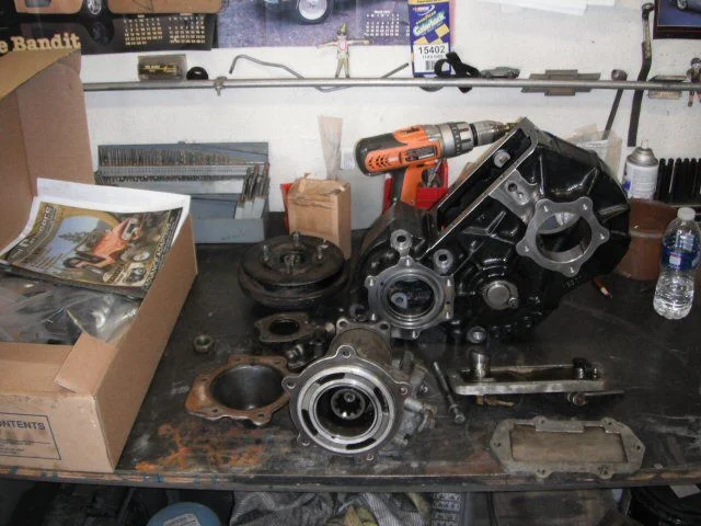

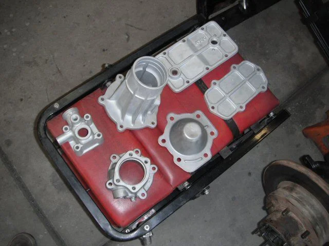

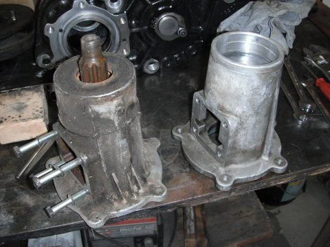

Which nose? In the picture I have on the right, the nose cone from the early "3spd" case I was running. On the left is one from an unknown year bone yard piece I got many years ago when I needed a shift housing.
The left looks to be improved with strengthening ribs from a later model. Probably "4spd".
Interchangeable parts? I'm going to clean it up and use it unless I hear otherwise.
The worst part about rebuilding old junk is all the time you have to spend on clean up. :frown:

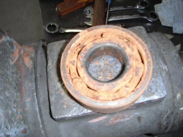

Found a real nice bearing on the front output shaft of my junkyard nose cone. :rolleyes:
A little oven cleaner, parts washer and sand blast treatment has this stuff ready.
