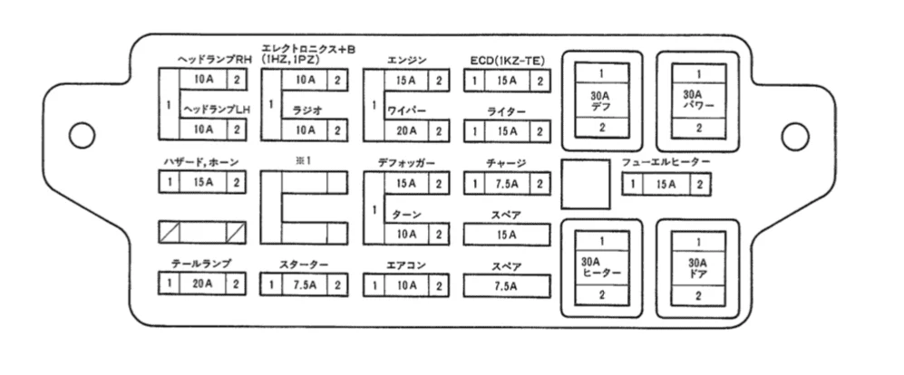

From what I can tell in the as-yet untranslated JDM wiring diagram, the KZJ78 never had a fuse in the 'Glow' position. Not sure why it was there in the first place, because it doesn't look like the 1HZ/1PZ powered cruisers had it either. Normally the power for the glow plug system has a dedicated fusible link rather than a fuse, because it draws a lot of power.
Good to know. Truck starts fine and quick so I think you’re right! Thanks!
