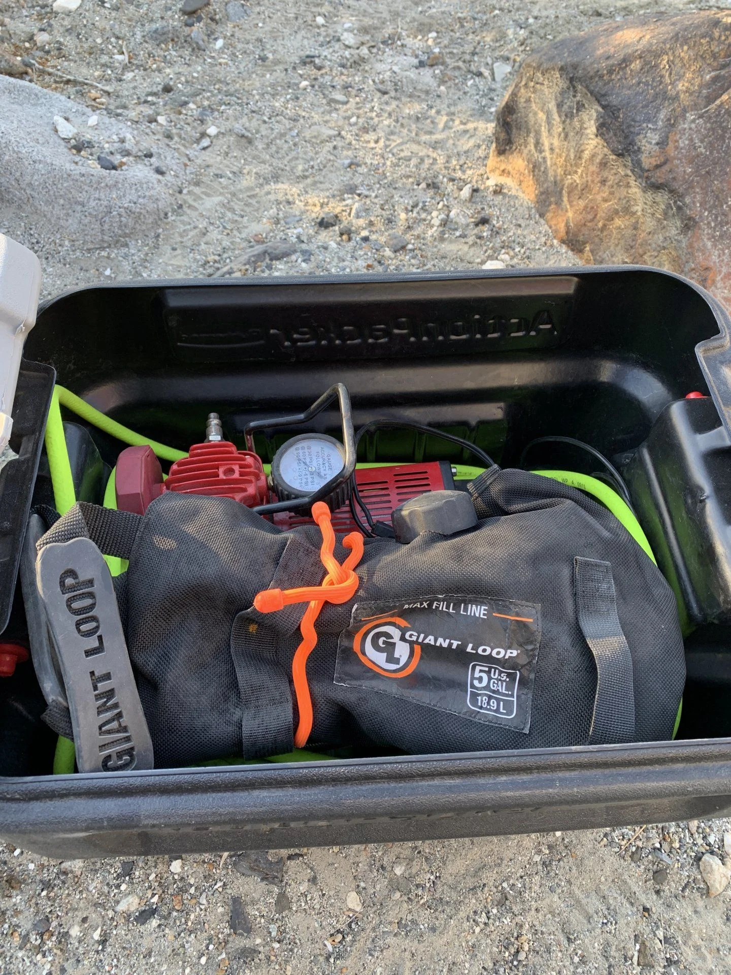

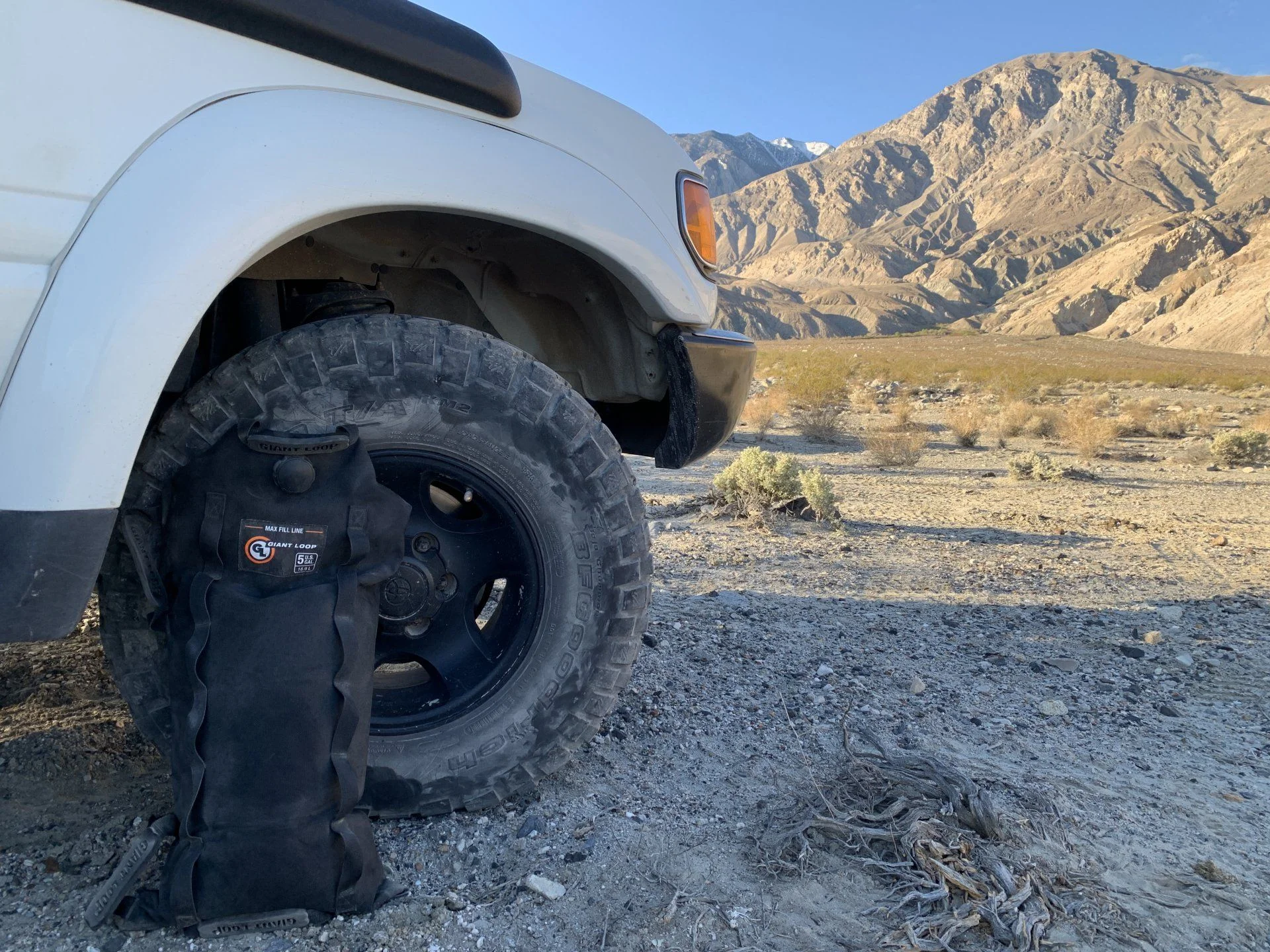

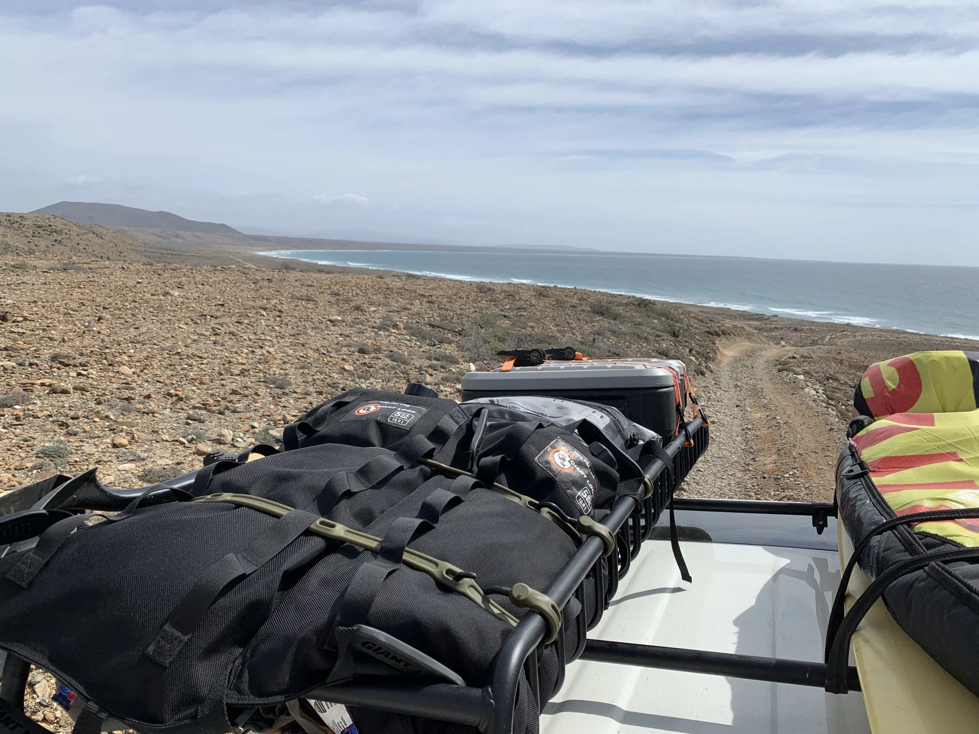

In an effort to lighten the load and make space on longer trips, I’ve made the switch from Scepter cans to the Giant Loop 5 gallon gas bags and have used them on my last two trips. With a few hundred miles off road (and too many of those washboard), so far I can attest to how well made these bags are made. They've baked in the sun, been from 300 feet below sea level to 7500 feet in a day, tossed hard and rattled extensively without spilling a drop. I keep them rolled up until the last fill up before heading out on the trail and then pull them out, fill them up, and tie them down on my roof basket. They’re easy to fill up and with multiple handles, easy to move up and down off the roof. Giant Loop sells a spout that goes on easy and tight. With huge handles on the top and sides, fill up is easy. The daisy chain loops provide a variety of attachment points and I used two of the Perfect Bungee adjust-a-strap to lash them down. Once they’re drained, I roll them up and toss them back into my compressor box. Throwing this out there as another option to keep your gas hungry beasts fed!

These are awesome, thank you for the review and for making me aware! Is that a yakima skinny basket? Thanks!
It is the Skinny Warrior. After running through just about every configuration of rack - from Yakima to Con Ferr to ARB - I'm now back to Yakima with some configuration of the Skinny Warrior, Rocketbox, or board pads on any trips.
