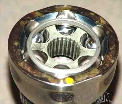

I had trouble getting the driver's side birfield apart. Now that it is apart and clean, I am really having trouble getting the birfield back together. I know that a lot of people have problems and I am actively searching for an explaination that applies.
I can not get the ball bearings into any of the cage openings. I could probably use a little brass drift to "persuade" them back in, but I am not sure if any part should be forced. I have tried every ball in every opening, but none just drop in.
The FSM is not exactly detailed. It says that there are 2 large openings on the cage, but I can not get any of the ball bearings to drop in. They are all very close and would go with a slight tap of a brass bar.
Picture #1 is how I have oriented the cage and star (it looks right to me - I took pictures of how it came out, but now know that someone has taken the axle apart, I am trusting nothing).
Picture #2 is the ball bearing sitting on the cage, not wanting to drop into the star.

The FSM drawing is wrong; it has an image of the earlier mini-truck & FJ40 birfield. That drawing does not apply to the 80-Series birfield. Look at your unassembled birf and reassemble the same way. There are pics of a new 80-Series birfield in the main FAQ thread.
It is important to note that an 80 birf can be assembled wrong and you do NOT want to do that. BTDT.
You don't pound the balls through those slots as you are showing in the pics. If you will recall during disassembly, the balls came out with the cage moved to the inside of the tulip. It is difficult to describe in words.
-B-
You have to assemble the cage back into the birf. It's easier if you have the shaft installed with out the retaining ring. Assemble the birf back, slide the shaft back in where it goes so you can move the cage around and drop the balls in. This is how I did mine, I did use a little force to rotate the cage once 4 balls where in. Once you have them assembled then all you have to do is put on your new retaining ring on the shaft and use the zip tie trick to compress it and slide them in with a little force. Repack with grease and you are done.

Here are some more photos of where I am currently.
Photos #1 & #2 are mine, photo #3 is what I found in the FAQs.
Tell me if I have it right (I still have 2 balls to get in there and will clean the brass out once done).
Thanks,
Riley
Yup thats it!
Thanks Juan! Using the short axle to gently articulate the cage and star helped quite a bit - thanks for that tip!
With the axle just dry fitted into the birfield everything feels pretty smooth unless you go for an extreme angle. Once grease is in there, I am sure it will be as slick as goose excrement.
Using a brass drift to persuade the cage opening up high enough to drop the ball in was necessary for all 6 balls. I just used the axle to push an opening up and then tapped gently until the ball dropped in.

After getting both birfields back together (the one on the passenger side went together very easy) I have concluded that at some point in the past, the driver's side was rebuilt and a new spindle and I am now pretty sure a new birfield was installed.
The birfield that came out of the driver's side is much stiffer than the one on the passenger side. I am assuming that after 212,000 miles, these birfields get a little worn and the cage/star/balls move more freely.
The birfield on the left is from the driver's side and the one on the right is from the passenger side.

My basic description without pics would be something like this. This is how I did it this weekend (I'll skip the head scratching and blank stares that occurred while I was trying to figure out the orientations). If Woody posts a bunch of pictures I'll try and incorporate them into this explanation.
Clamp the empty birf (tulip) in a soft jawed vise. Take a look at the cage and notice that it has a flat edge and a tapered edge. The flat edge goes to the outside of the truck (facing down into the birf in the vise). Next look at the star piece. One edge of the splined hole (where the axle engages) has a groove where the C-clip will sit when the axle is installed. This faces the outside of the truck (down into the birf in the vise). The edge on the other side of the star has splines that taper down slightly as they near the edge. This is to help guide the axle splines during reassembly.
Assemble the cage and star, keeping a close eye on the orientation of both parts, and install into them into the birf. The 6 balls can be installed one at a time by aligning the grooves in the star with the slots in the cage and the grooves in the birf, and then tipping the star and cage assembly up. The ball should drop in with no force. If you have to push it in with more than one finger, something might be amiss. Check everything again. Drop the remaining 5 balls in, and presto, you have one assembled birf! Now, take it all apart, coat everything with moly grease (leave a bunch of grease inside the birf) and put it all back together again. Practice makes perfect, right?
Next, install the axle shaft using the ziptie/hose clamp trick. Install the C-clip on the axle shaft. It will be loose. Use a ziptie or hose clamp on top of the C-clip to compress the clip. Align the greased axle splines with the greased splines in the star and press the axle into the star. As the ziptie/hose clamp reaches the star, it will keep the C-clip compressed until it slides into the star. Push the axle in the rest of the way, remove the ziptie/hose clamp and check that the axle will not come out of the birf. Congratulations, you now have one assembled inner axle assembly!
