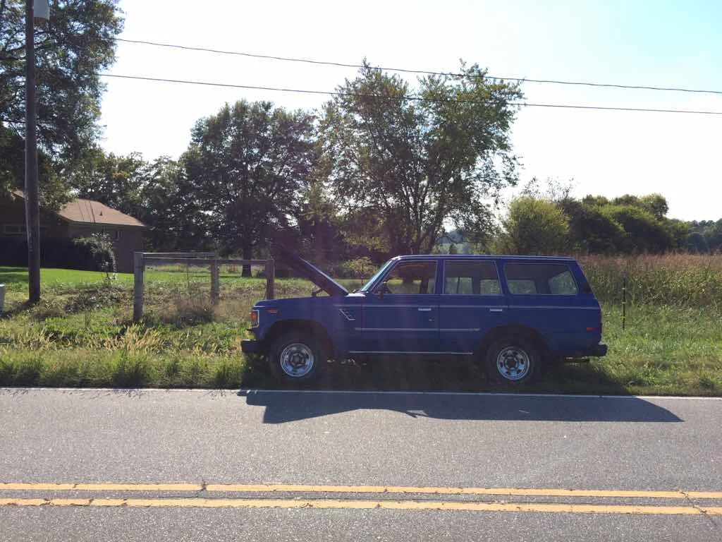

though my fuel keeps getting clogged cause I'm too lazy to clean my tank. So I've been on the side of the road quite a few days...
Is there anyway to clean it without taking it off? I saw something about an access port in the trunk?
drain plug on bottom. it is easier to drop the thing so you can get all the bits out. look for a radiator shop to seal it while it's down...blow all supply and return lines and vent lines clear with low psi, new rubber hoses and filter.
