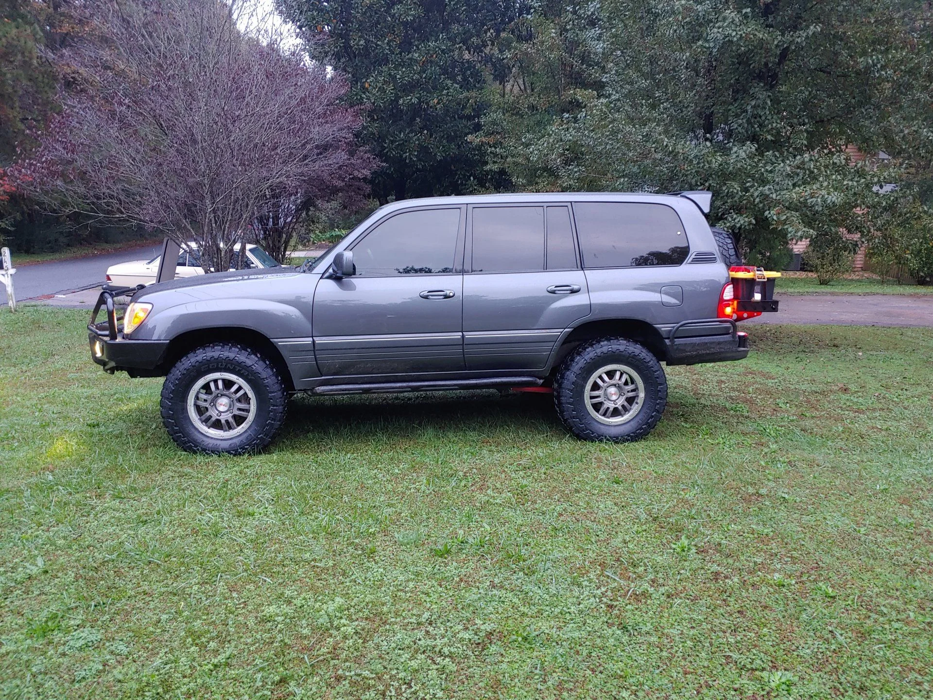

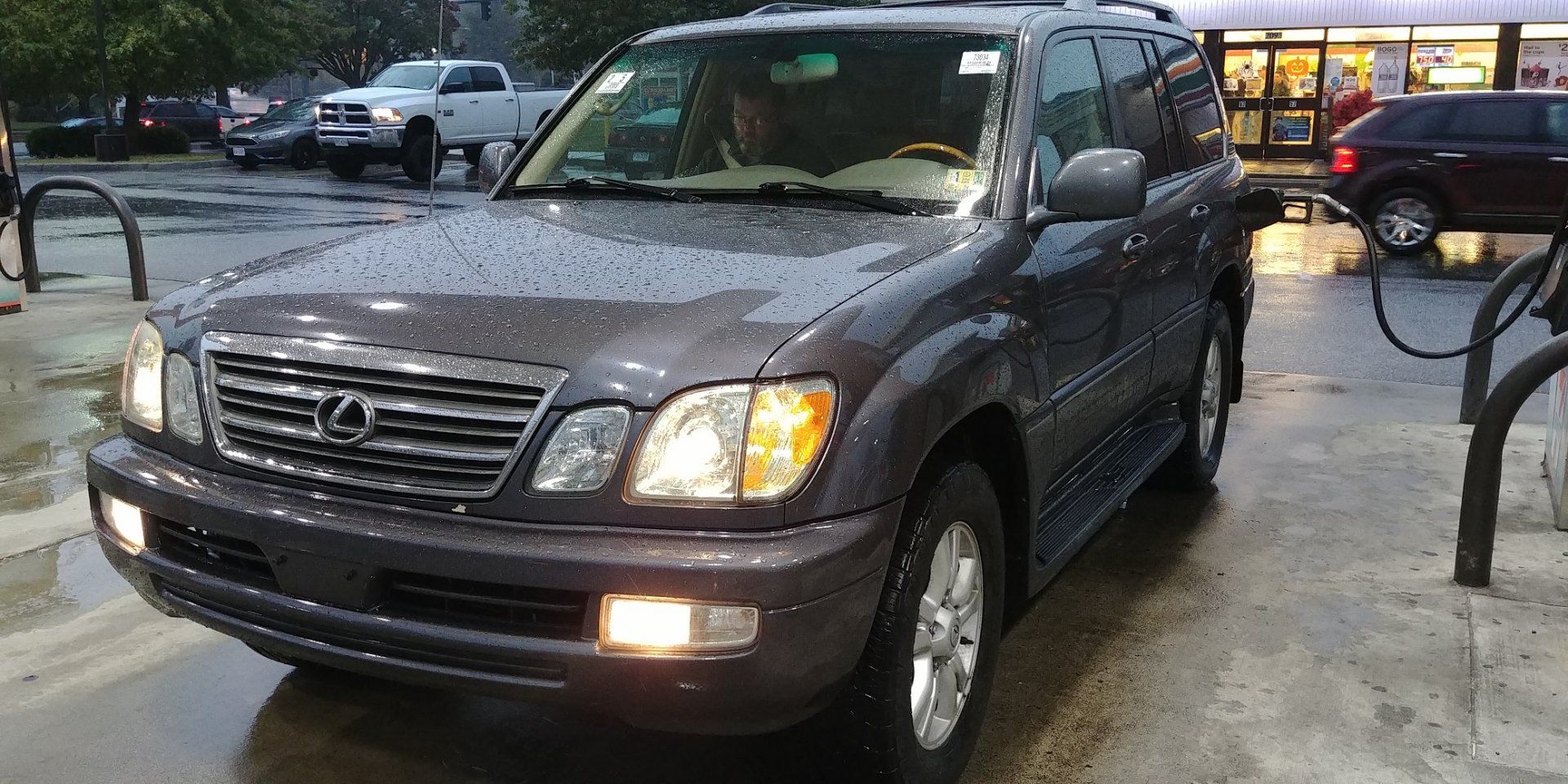

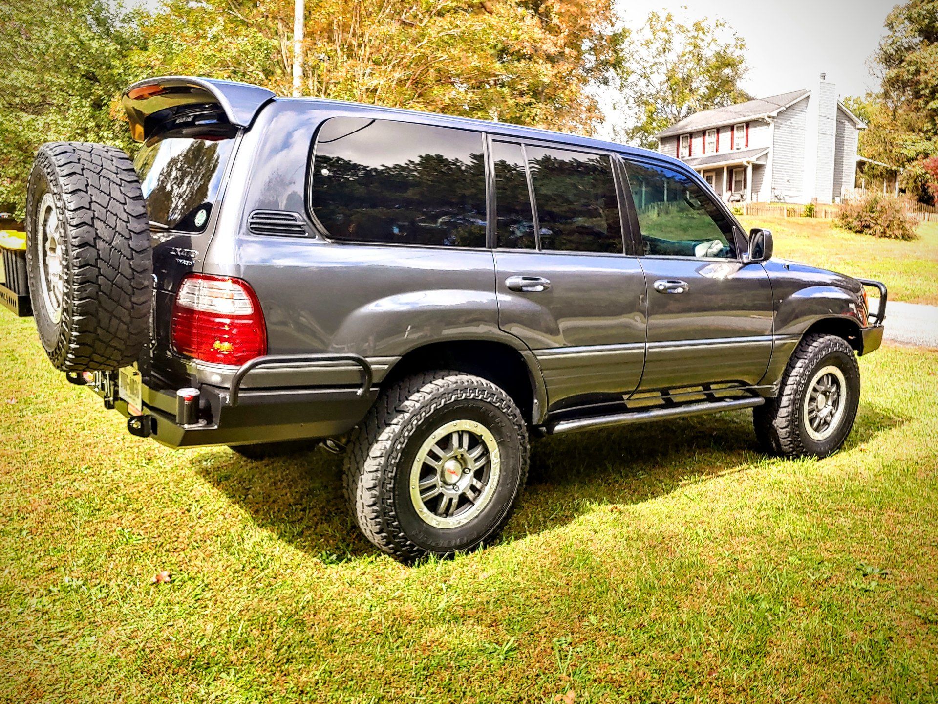

This week marks my two year anniversary with Gerry. She was a nice enough truck when I bought her, but it's been a very busy and productive two years!
To recap what we've done:
Maintenance:
-OEM Timing belt service
-Radiator (CSF)
-Lift supports F/R
-OEM CVs
-OEM steering rack
-OEM TREs
-OEM diff bushings
-OEM complete LCA
-OEM fan clutch
-OEM heater tees
- All 4 brake calipers/rotors/pads (mostly OEM)
- All fluids baselined and up to date (Toyota or equivalent fluids)
-SLEE stainless steel brake lines
-All new spark plugs
-All new ignition coils
-Engine air filter
-Cabin filters
Suspension:
-Tough Dog Ralph (front) and 45mm adjustable (rear) shocks, torsion bars, torsion bar strengthening brackets, TourFlex rear springs
-Airlift 1000 rear air bags
-SPC front upper control arms
-Trail Tailor sway bar links, diff drop, rear lower control arms, rear upper control arms
-TRD Rock Warrior wheels (w/ matching spare)
-Toyo Open Country M/T in 34" x 11.5" (285/75/17)
Driveline:
-Nitrogear 4.88s
-Harrop E-lockers front/rear
-Tom Wood double cardan drive shafts front/rear
Armor:
-ARB bullbar
-WKOR bump-out sliders
-Trail Tailor rear bumper with dual swing outs
-Trail Tailor lower control arm skids
-Asfir full skids set
Accessories:
-Ceramic tint on all glass
-TSX HID retrofit
- Morimoto 2-stroke LED DRL/high beam
- Viper smart-start
-YotaMD titanium key
-BTOY45 bluetooth unit
-Custom rear drawers
-Land Cruiser Phil aux fan (with custom OEM style button on the dash)
-Re-foamed speakers (still ongoing)
-Replaced AHC controller with OEM console pocket
-BenCC custom transfer case lever cap
-BenCC overhead scangauge mount
-ScanGauge II
-Smittybilt 9500lb winch
-Trail Tailor recovery points
-Mostly swapped to all LED exterior lighting
-StarDiamond floor mats
-Trailer brake controller
There's likely a lot more but holy cow, check out this before and after:
Note my father, owner and lover of a well-built TJ, being completely unimpressed by my stock Lexus.
With the exception of some electrical accessories that I'll need to plan out, and the replacement of some parts with parts I'd rather have (like my ARB... Hey @ClassyJalopy , you still want it?? :rofl: ), she's about as built as she's gonna be. Now I can just enjoy the truck, use her for what I built her for, and really spend time just making her 'nicer'.
Next up? Dual battery system, exterior accessory lighting, air horn, 12k winch, drawers v2, fridge, rifle storage, maybe a higher clearance front bumper, upgrade my TSX retrofit, new leather skins for the seats, begin replacing all interior bulbs... IDK. First $35K takes her home with them :rofl:
This forum has been such a great resource for learning about these trucks. It's also been amazing in that it's put me in touch with some great friends, gotten me into areas I'd never have found, and put the truck through her paces more than I would have tried without knowing it could be done. I've been fortunate to get to build this 'one day' version of a 100 and I'm looking forward to paying it back to the community as I gain more of my own experience. Thanks MUD!!
