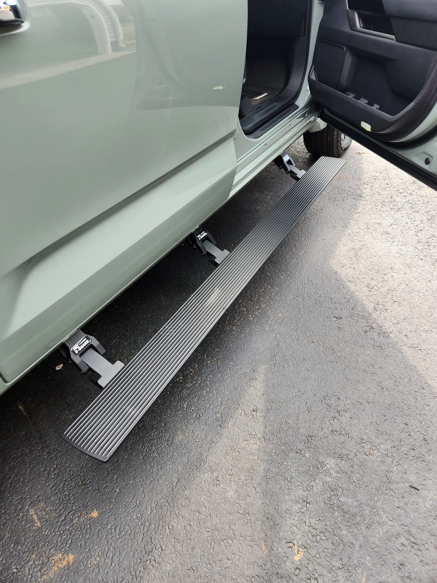

The nice thing is the rivnuts or nut certs or whatever are already their in the metal under the rocker panel. This means no drilling. The brackets have slotted holes that correspond to the existing bolt holes. So simply take the toyota bolts out (that are there holding nothing) and zip in the Rough Country bolts. A 13mm to remove and a 10mm to install. Leave the bolts a bit loose to adjust the brackets. The middle bracket goes to the 3rd set of holes. The 1st bracket with power motor goes to the 1st set of holes, the second set on the passenger side get the controller and it's bracket. The 3rd set of holes gets and idler bracket (no motor) and the last set gets a power motor bracket. This went very easy and just as you would image. Next install the boards to the brackets. They come with threaded aluminum blocks that move in a track. Line up the aluminum block with the corresponding block shaped hole in the brackets and slide the bracket to get it to the right spot. This is all very cantilevered so two sets of hand help here to hold the board until you get some screws started. Tighten the hex cap screws, (they screw upward) but don't lay on your back looking up, instead kneel and look downward at the bracket and board and it gets done easier. Once the boards are aligned and tightened go back and tighten the brackets to the rockers. If the space between the ends of the boards and the rocker are off you may need to loosen them all and do it again. I found that the rear was out and the front was tight on one board, loosening all the boards and starting at the back working forward helped center things up.

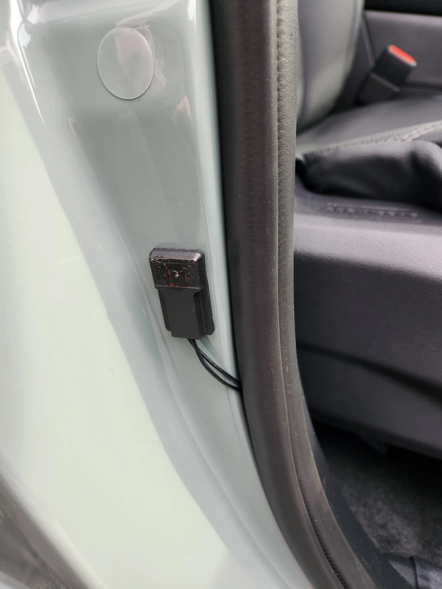

Running the sensor wires under the weatherstripping is where the 1st conundrum comes up. There is no hole or notch in the metal pinch weld under the weatherstripping. So do you bend your new sensor wire a hard 180 degrees and shove the weatherstripping back on it? No clear instructions here. I opted to do this but seriously considered taking my angle grinder and making a small notch in the metal, sanding the rough edges and running the wire through this to keep it from kinking so hard. In the end I couldn't force myself to grind on my brand new truck. If the wire fails at this bend there is enough wire in the harness to pull more re-attach the wire where it broke and THEN cut a notch.

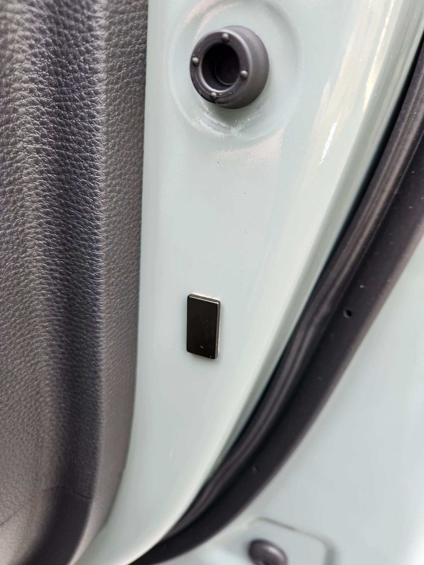

They provide some small magnets with double sided tape to stick to your doors that activate the sensor mounted in the doorwell. I used a wet pea sized dab of rtv sealant on the sensor then closed the door find the spot to place the magnet. I suppose some thick grease would accomplish the same thing. Just find the spot, wipe it off and stick the magnet. The adhesive is pretty tacky so you don't want to have to try and move it once in place. Same with the sensors. Interestingly the magnets didn't stick to the front doors (aluminum?)but the 3m tape did work to hold them.

They deploy very quietly but the brackets rattle a little when stowing. I only dinged my shin once so far. I was at the grocery store parking lot pulling the shopping cart close and getting my body in between the cart and the truck. Then I proceeded to open the door and the board hit shin bone! I don't think I'll do that again.
