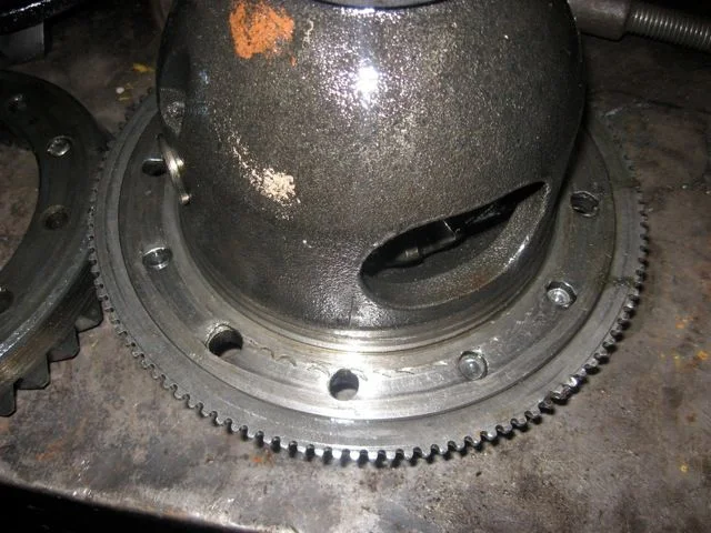

Some one has been in the Dana 70 before me and I think they forgot to use loc-tight on the ring bolts? Every ring gear bolt sheered off. The ring was just floating on the carrier. This cube van has a gutter bending machine and several rolls of aluminum in the back and is grossly over weighted all the time. All the new parts are on the way. This should be fun:D

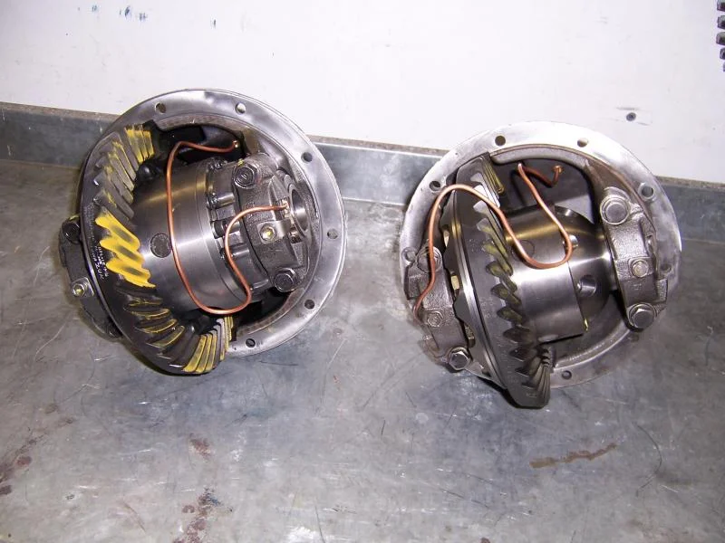

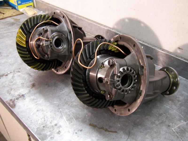

OK, I went to the border today and picked up the diff that Zuk rebuilt (left) and a "matching" brand new complete 3rd member with ARB locker and 4.56 gears for the front (right), purchased from JT's Diffs.
After unpacking them both and getting them on the bench I was immediately struck by how different the two lockers are. After talking to several people I contacted Nills at ARB tech department.
The new diff (right) from JT's contains an ARB-RD142 which is the correct unit and the latest and greatest upgraded version for the front toyota 9.5" application and/or the rear Full Floater toyota 9.5" application, as in my Landcruiser.
The old diff (left) that I have been having all of the problems with contains an ARB-RD124 locker. This unit is for the semi floating rear diff application. I have a full floating rear. In the words of Nills (ARB tech) the RD-124 will work in the front or rear full floater diff but I should have never been sold it to began with. The semi floater design uses only 3 instead of 4 spider gears, in order to accommodate the installation of the c-clips on the semi floater axles. Over all the RD-124 is not as strong as the RD-142 and the RD-124 is an old design that will be replaced in the next month or so by the new upgraded version RD-153.
So in other words, just to add insult to injury, not only did this shop screw up the diff rebuild and ARB installation 3 times and destroy my ring and pinion. They also sold me the wrong locker for my application. Although it will work it is an inferior design, weaker and less desirable. :mad:
