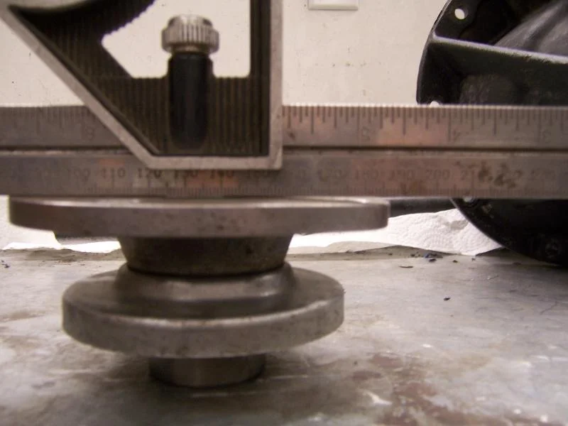

So I pulled the 3rd member and sent it back to the installer. Turns out that the diff had been dropped on the companion flange when it was shipped back to me after the ARB install. :mad:

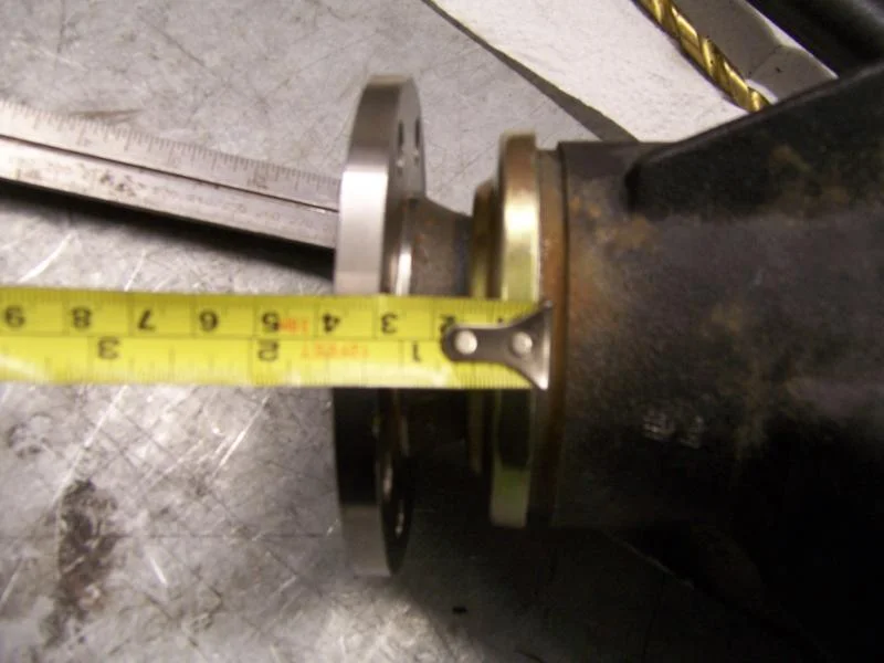

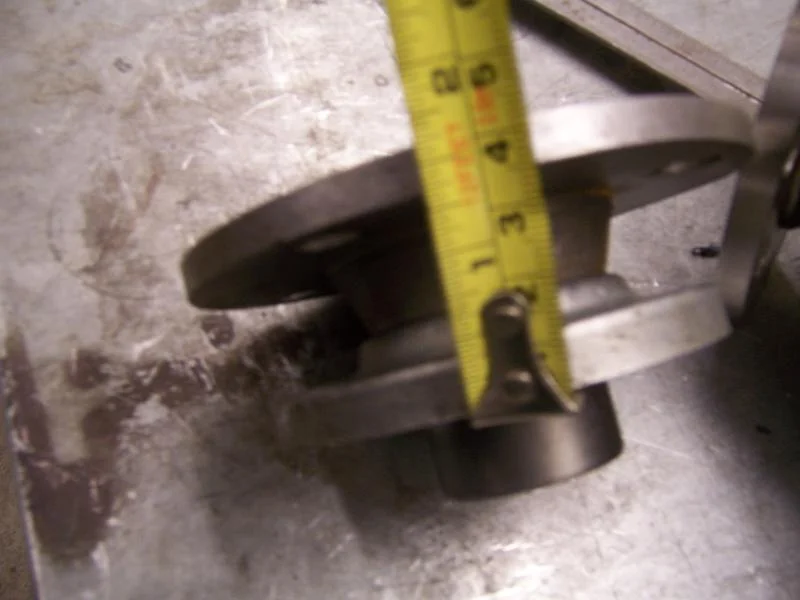

Besides bending the companion flange, the installer says the gear noise was a result of the impact, which changed the pinion depth. Does this seem like a likely result?

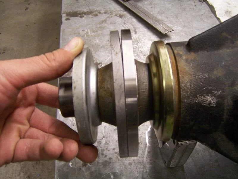

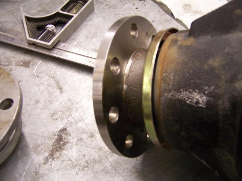

The new companion flange does not sit the same. Their is a much larger gap between the deflector ring and the diff housing. The deflector ring is also a larger diameter, which adds to the amount of gap. Should I be concerned that more dirt and debris will get in easier and possibly damage the seal? Maybe I should I get a different companion flange or possibly see if the machine shop could straighten the old one?
dust shield
As long as the seal does not interfere and preload is set properly, the dust shield on the flange is nothing to worry about.
Thanks for the reply concerning the dust shield / deflector ring. How can I be sure their is no interference with the seal and the preload is set properly?

The ARB product has nothing to do with the issue. I was however questioning the replacement companion flange and deflector ring. I have included a pic showing the manufacture of this.

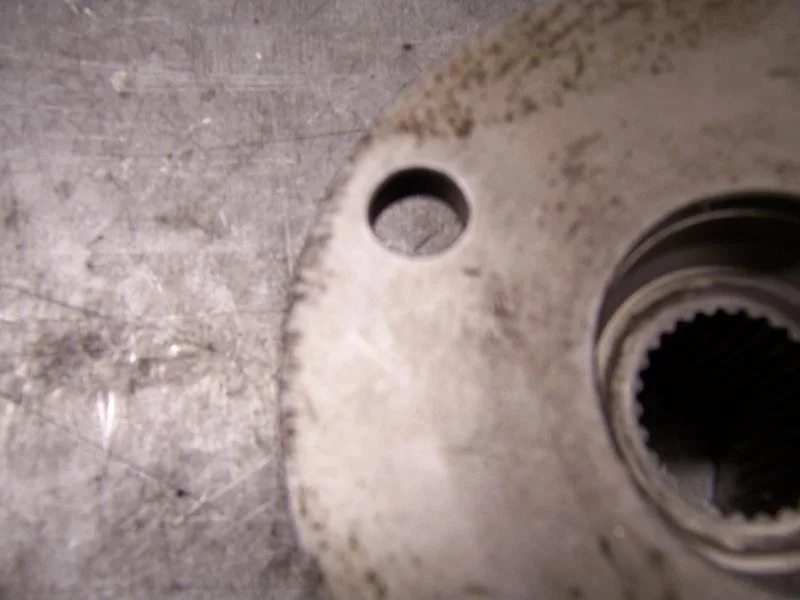

The gear noise turned out to be a result of a severe impact during shipping, as evident by the bent companion flange. I have also included a pic of the point of impact on the flange mounting surface.

As for interference, it would be obvious. Ive used the flanges like you have there, and had good luck.
Really you'd be fine with no dust shield at all too.

Beep, Beep, Beep back this up!! "Besides bending the companion flange, the installer says the gear noise was a result of the impact, which changed the pinion depth. Does this seem like a likely result?"
Not at all. Pinion head+pinion depth shims+inner pinion bearing race+solidspacer+ solid spacer preload shims+outer pinion inner race+flange+ thick washer+pinion nut. It is completely solid from the pinion head to the flange. You could hit it with a 100 pound sledge and it is not possible to change pinion depth. I wish so, that would make it a easy to set up gear patterns.
Droping the third In my opinion could shock load the taper roller bearings pounding small roller bearing dents into the inner and outer races destroying bearings in a very short time. This will not change pinion depth.

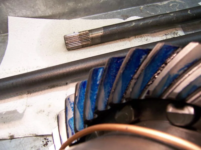

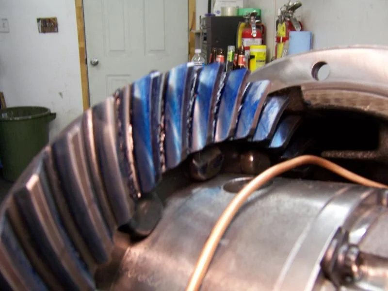

I did a test pattern on the gears before installation. The pattern does not look very good to me. Any thoughts if I should install these gears with this setup?? Or get them set up again?
Wow. I don't know what to say!! I hope you didn't pay for that. That is not a good gear pattern at all. Your call on installing that. I wouldn't. Are you paying for these attempts at installing gears? Send the pictures back to the installer and get your money back. Might be a good idea to find a better gear installer. Go to Toyota Gear Installs and check out professional gear installs that is how they should look.
