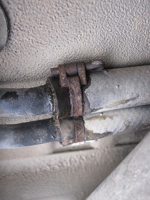

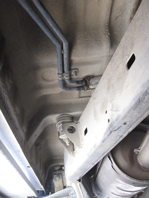

Another maintinance to sort... But what is it?
What are these lines for? Where do they come from? Where do they go to? Another great adventure of the 80-Series Land Cruiser...
And what flows through them?
Is it something a serious condition that I need replace all the rubber on. There are a few hoses under here...
Those are your rear heater lines. They come from the passenger side firewall.
Easier to remove, but can be challenge to replace.
Give it a search...loads of solid info.!

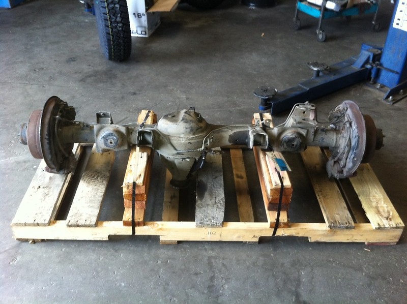

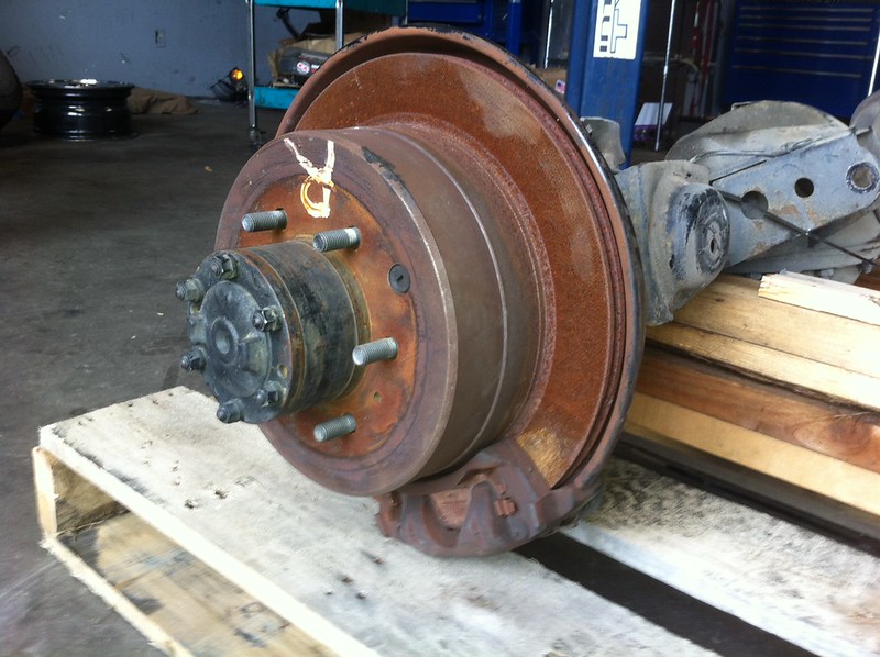

Upgrade!!! Ff rear axle for adv80!!!
A little crusty - a little rusty, but LOOK WHAT I GOT!!!
FULL-FLOAT REAR AXLE WITH DISK BRAKES
say BYE BYE rear drum brakes... heck, I haven't had rear brakes for over 6/9 months, I can't even remember...
Hello Just Differentials / TJM locker / Nitro Gears dipped in fresh lube
Hello field-serviceability! What does this really mean!?!?!

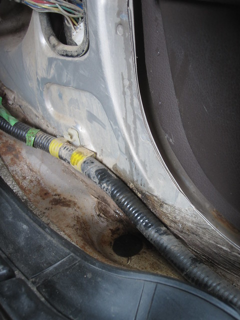

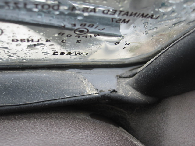

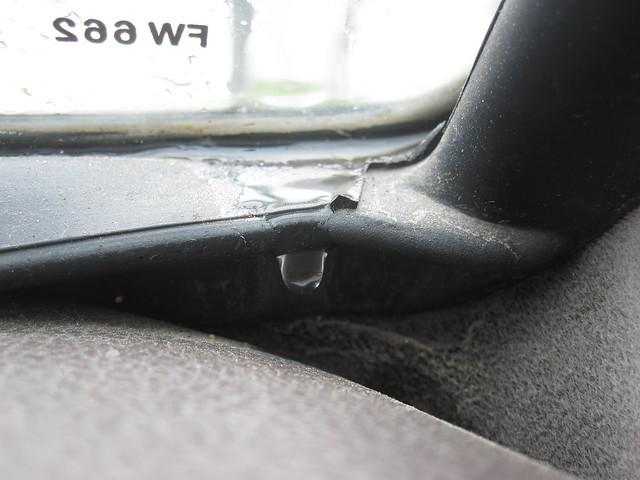

Leakey leakey leakey
With the carpet out of the rig, I finally found my leak! I noticed it dripping and seemed to be coming from the bottom of the dash!
Traced it up stream:
Drip drip drip, right there in the bottom of the windscreen seal on the passenger side.

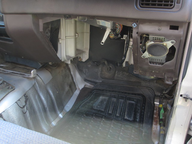

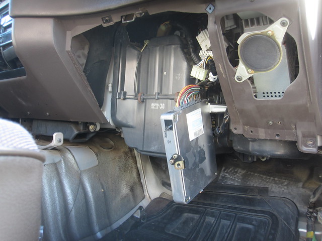

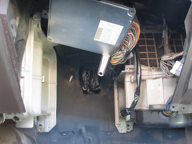

Thank you alia176 for the inspiration to tackle the A/C system!

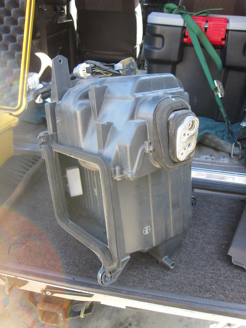

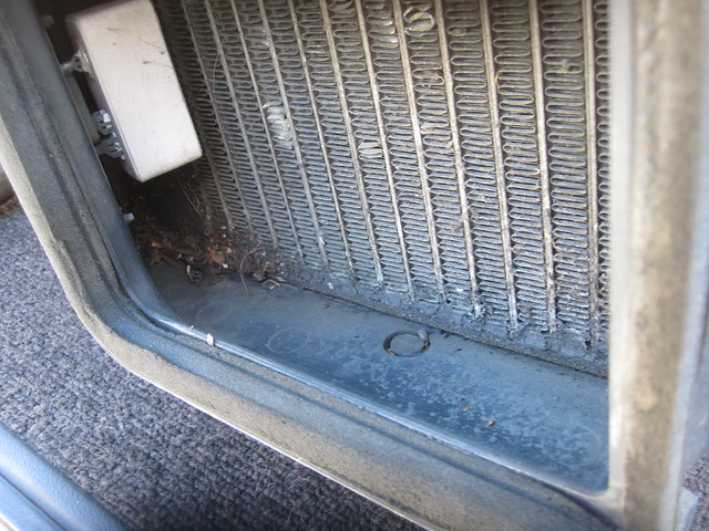

I started in on my A/C system this weekend:
Now to split open this puppy and get after the cleaning and such, but that will come a little later.
I was worried that I was going to have a squirrel hoarding nuts up in hear! I need to do some more searching to see if anyone has created a solution to filter this puppy[?] My Subaru was good with the internal cabin filter you could replace or beat out from time to time.
I put some tape over the hole into the engine bay and secured the lines on the other side and wrapped the heads in a rag to protect them from the elements.
And attached the computer back up in the factory location as I will be driving it daily like this for a while.
Passengers have some massive legroom now!
I want to own a vehicle with real live working A/C!!!!

My A/C has a crack condensor so all the fluid has leaked out so I did not have to block off the coolant hoses.
I chased my water leak for a while so pay real close attention to the front window on the bottom corners. My sunroof is tight, so it took me a while to find the source of my leak. Just so happened to find it after I removed the carpet! FINALLY!
