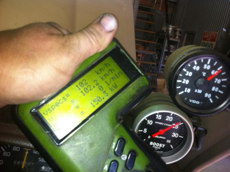

1HDT, eBay front intercooler, 3" exhaust. held flat out at 3000rpm contant on dyno for 10 seconds on 35" Tyres. Nice photo of whats going on. This is the GTurbo CT26 "Bad Boy" turbo...... AFRS to be posted too as soon as I have them.
Power is at wheels (201hp @ wheels)
Pyro is Pre Turbo in degress C.

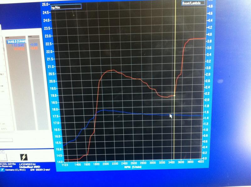

GTurbo CT26 1HDT 201whp, 18.7:1 AFR
EDIT: @ 201whp, 3000rpm (35" Tyres), the AFR was actually 19.2:1
Boost curve included.
NOTE: this is on an inertia dyno, so bottom end boost response is significantly better than on the graph. And the AFRS show up richer than they really are down low due to transient nature of the dyno. It is very rich off the bottom however, this will be tuned out as much as possible in the coming week. I think we can get it to 16:1. I wasnt there for this unfortunately.
Red line is air fuel ratio, blue is boost in Bar. Even in transient, the boost is 1.45 Bar (21psi) by 1700rpm and 15psi by 1500rpm.
