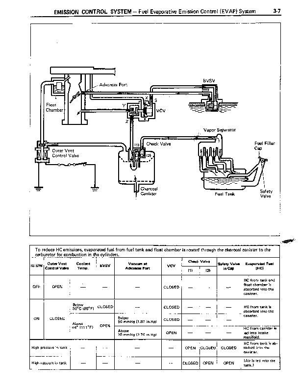

does it have a lot of pressure every time you remove the cap, if so id swap the hoses at the charcoal canister, also the vents on the back will actually allow some of the exhuast fumes back in unless you turn the lever to fresh air instead of recirc if that makes sense, especially if your leaking gas around the cap
Right now I'm in the middle of the same thing, trying to figure out why I smell like gas after sitting in my 60. I did confirm this weekend that my Charcoal Cannister is probably shot or at least not working right, so I think it is the culprit. Followed the Toyota test procedures found here: https://forum.ih8mud.com/60-series-wagons/100894-charcoal-canister-test-procedure.html
After following the diagram procedures, when applying air to the Purge Pipe, no air comes from any other port. No amount of pressure would make it budge. I sprayed some carb cleaner and applied more air, but nothing. Based on that I determined it may be shot.
This is my question. In this thread pffairchild referenced switching or reversing the top 2 hoses (purge and tank pipes) and mentioned the problem (assuming gas smell) goes away. I've seen the same recommendation in some other posts. Has anyone done this? Is is just a bypass? Does it have an impact on anything else? Is this more of a temporary fix than a long term fix? I ask because I figure the engineers at Toyota 25+ years ago are smarter than me and there must be a reason for the order. Hope someone can shed some light. Thanks.
You get the vapor pressure buildup in the tank because of the check-valve in the canister. If you switch the two hoses on top of the canister you'll bypass the valve (still keeping the evap system fully functional) and you'll avoid the gas smell in the cabin, unless there's other issues like broken/open hoses. Open seam in the tank, etc.
