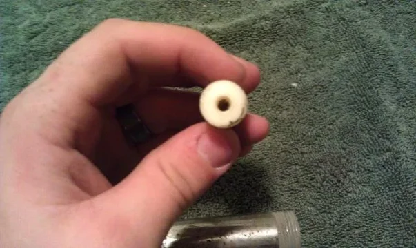

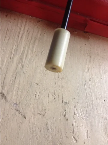

I just did this mod using the http://www.adventurerv.net/gas-spring-60lb-ext-comp-wplastic-ends-p-2605.html and I have to tell you it was easy and works like a charm.
Remove the provided end, drill out your spacer with 1/4" bit almost all the way through, drill the last 1/4" with a bit that will allow you to screw the spacer on the end. Screw it down even with the end.
Remove the metal retaining ring, pry it out and toss it.
Insert it into the tube and mark it at the end of the tube and cut the plastic end.
should look like this. Put it back together and you're done, now time to get them re-chromed. Great mod.
I'd like to thank 40Zen for the lead on the gas shocks.
