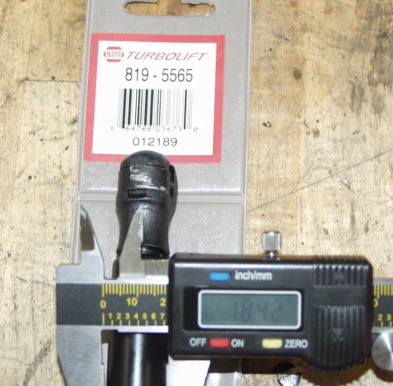

I just tried to do this. Got the 819-5565 (40.00 each), and they WILL NOT FIT into mine. The body of the gas strut is too large in diameter. I have a 1970. Not sure if the stock struts got changed along the way by Toyota or if NAPA changed the gas struts. Can someone who has done this, PLEASE measure the gas strut diameter for me?

Exact same problem here. I wrote down the part number about a year ago, purchased them today and found out they will not fit inside the tube. They must have changed them.

The body of the gas strut is too large to fit in my OE struts. Can you give me the size of the strut body you bought?

Part number confirmed: Napa #819-5565.
They must have changed the supplier recently because there is no way the two with that part number I have in my garage currently will work in this application. They are generic struts - not referenced for any car in particular so I assume they just spec them on length and pressure.
Here ya go. Body diameter is about 18mm. Internal stock strut diameter is about 16 mm.
