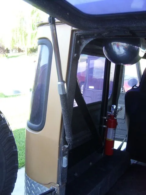

The Napa Part # 819-5565 refers to the Manufactures Part # 5200-50.
I Googled this part number and found several distributers. I just installed item number 5200-50. RV Gas Strut I had a pair of them delivered for under $37, which is what Napa wants for each spring.
The tube end is 15mm dia. which fit perfectly into the upper portion of the old chrome tube after I removed the plastic end connector. After fitting the gas spring into the old tube, I cut the other plastic connector to length so that it was exactly the length of the fully expanded tube.
Works like a champ. Now I just stand back and watch as my rear gate is lifted to its max height.

This is great. Do you have a pic of them installed? I'm going to order those this week for mine!!!
Most of the ends unscrew. Worst case, you could cut the tip off with a cut off wheel or hack saw... Just make sure the strut will fit inside before you cut it to length...
Once it is installed, there is nothing to see. It looks just like the regular stock setup, but works much better.

Not sure if this is what you are looking for...
Shawn
I do not understand... You want to see the strut inside the oem assembly? There is nothing to see. You slide the strut in after you take out the oem spring, and put it back together...
