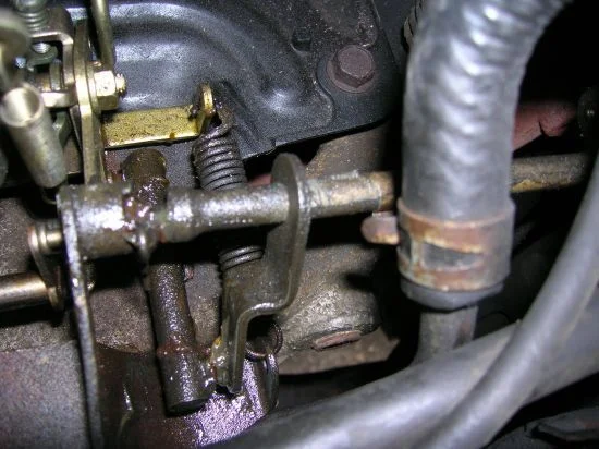

Gas Pedal STILL sticking! Some pics, anything look outta whack?

Thing #1:
In picture #1, there is supposed to be a return spring on the top arm of the gas pedal. I don't see it in the pic, but it might be just outside the frame. Either way, if you look at the pedal, there should be a spring from top arm to a tab on the firewall. The pedal spring is the strongest one (of the three) in the system. It is still available new from Toyota.

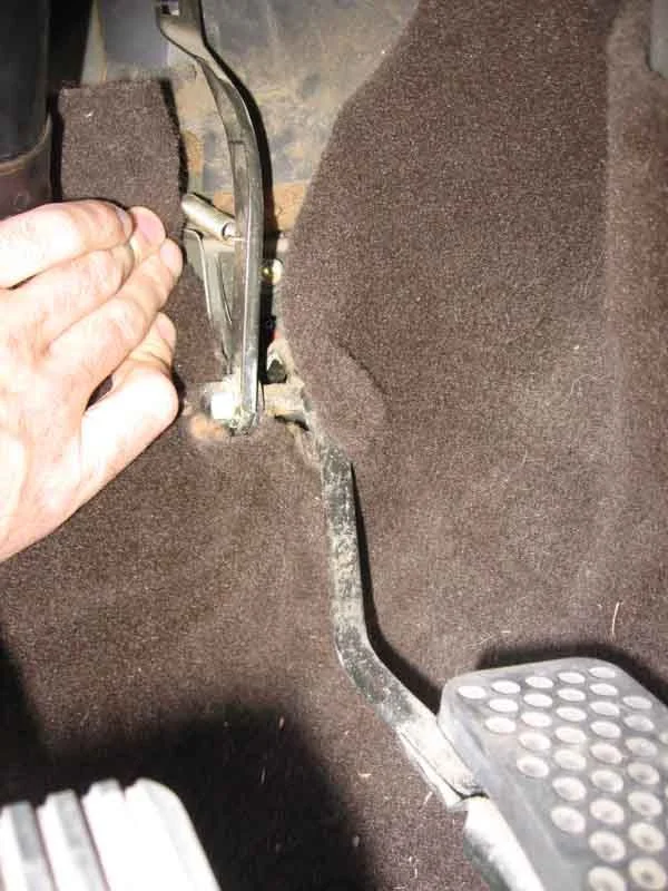

zack, i snapped this at lunch. here's the spring JimC is talking about.

Just FYI, the throttle linkage that goes horizontally across from the top of the pedal link to the carb link (in foreground of pic below) can be intstalled backwards. One arm is shorter than the other and effectively kills your ability to use the secondary on the carb becasue it wont open the throttle enough. Just in case you pull it, make sure it goes back on the right way.
Ok, well there is ONE problem there, as that spring is MISSING on my truck! Thanks for the pic! Forgive me for being dumb, however one end of the spring goes on the pedal and the other end?
Connects to a tab on the firewall. Get the spring and then you can find the little hook on the firewall.

The throttle is sticking. The largest return spring of the three in the system is missing.
Replace the spring and fix the vac, PCV and PB hoses, then get back to us.

Have you checked to see if the carpet (new by the PO as you said) is holding the pedal when things stick?
might be one thing that you haven't checked yet...
