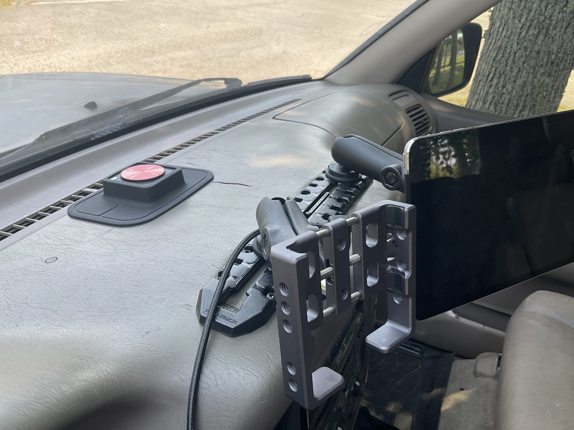

If you’re not scared 😱
How did you screw that in? Just self tapping screws or did you get nuts under the dash? Or?
Drilled and bolted. Think I used either M4 or M5's. Removed the face plate at the double din and dropped the stereo down just a bit. I had to drop the stereo down to get my fat fingers in there with the small ass screws/nuts/washers. Super easy and love the functionality. It is not for everyone though. I have seen others do this but most have pristine dashes and don't want to drill holes in there (can't blame them actually). As you can see I don't have a pristine dash.
Before I did this was thinking a fabing a small bracket that would bolt to the side of the stereo and protrude out of the small space left between the stereo and the faceplate. Good luck
pristine dash: that is exactly my hesitation. thinking of designing a light frame that hook to the defrost vent by the windshield, then hang in front of the lame oem display with some yet-to-be-determined attachement below the display.
