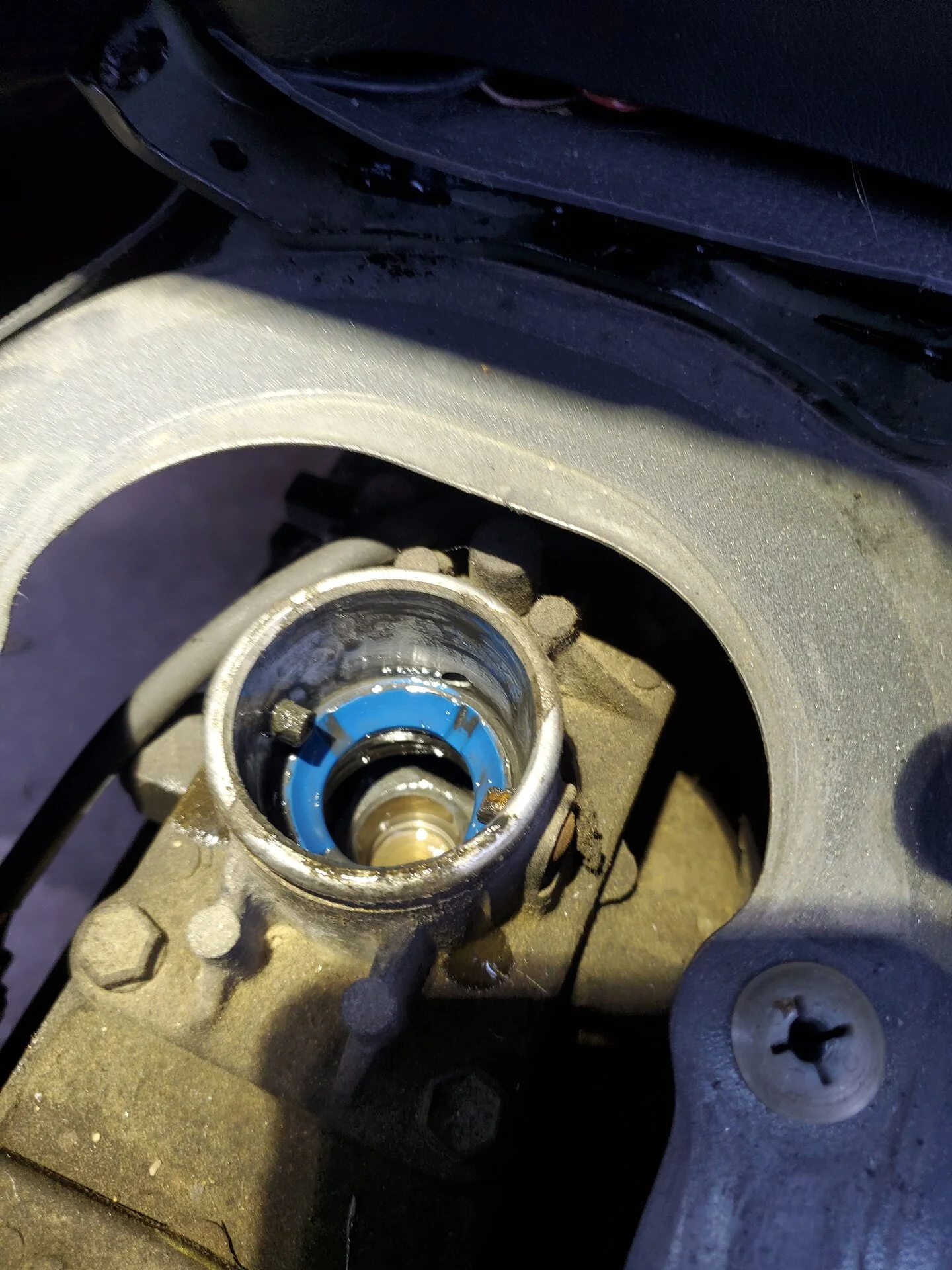

Could the shifter seat cause these type of issues? Easy enough to replace.

Shifter seat looks fine. In fact, it looks like a Marlin Crawler seal and socket have been put in. Although I don't know how that is possible unless the importer did it in 2021.

I never had or worked on that model trans. I have had W56, R150 F and R151F. I have had the bad OEM shifter bushings crumble apart and cause problems. I have had them apart and rebuilt them. I was going to recommend the Marlin parts and looks like you already have them.
