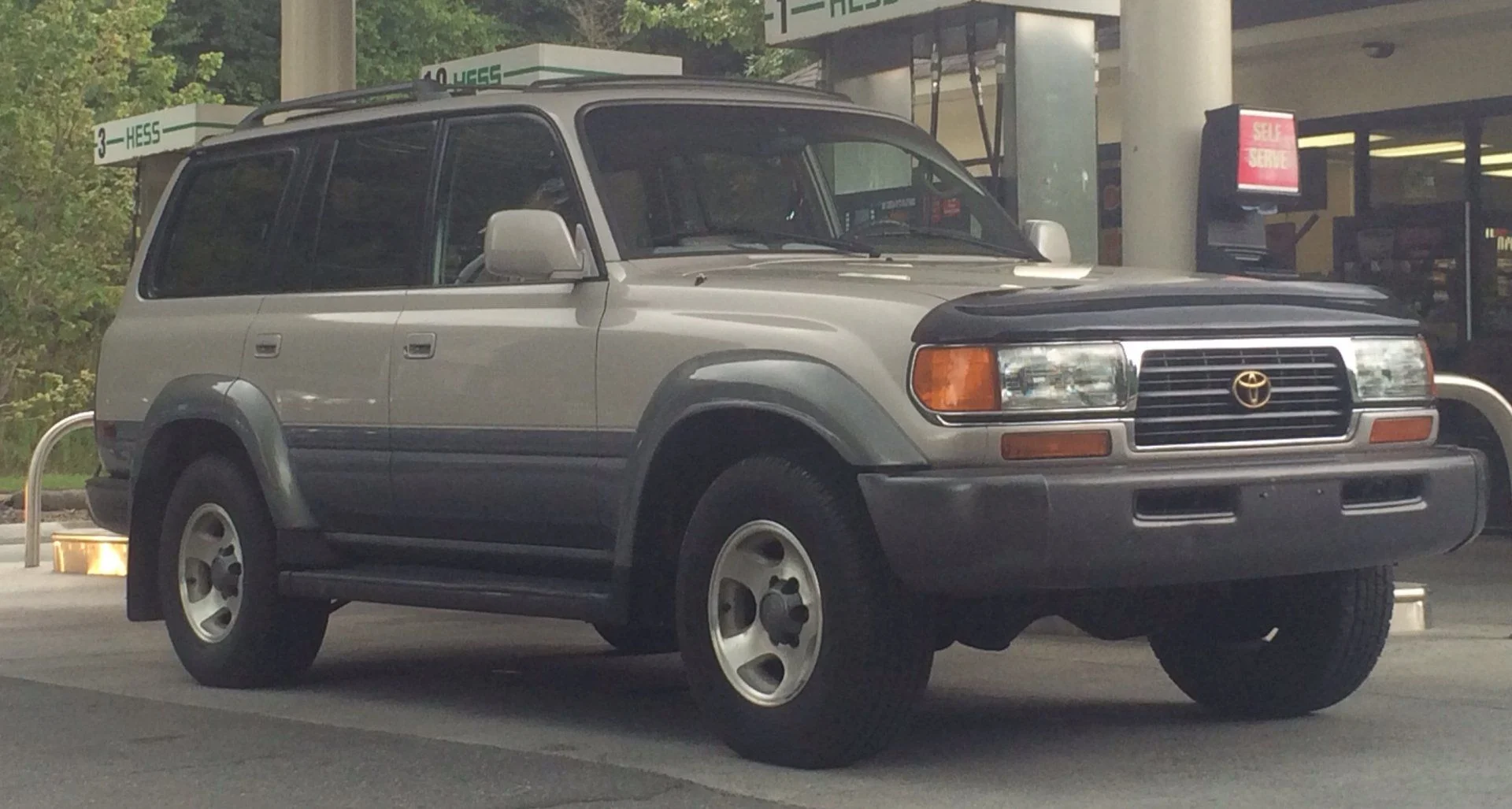

Hello everyone, I recently purchased a 1997 Locked FZJ80 in great condition. I got incredibly lucky and ended up with an awesome rig.
I've been reading the forums for a couple of weeks now and have begun to create a list of things to take care of before I start worrying about mods.
This is a modified to do list from another member, anyone see anything I should add or not worry about?

Sweet rig! I love that color combo. Miles, price, location, if you don't mind sharing?

Thanks, the truck has 106,000 and looks like it was garaged for the entirety of its life. Its almost too clean. Although gauging from the oil change sticker that has Mobil 1 listed as the last oil used, I'm hoping it was well maintained too. Got it in the Boone, NC area for what I consider a steal at 8k. Planning on keeping this one until I ride off into the sunset.

Congrats on you Cruiser, very nice looking.
