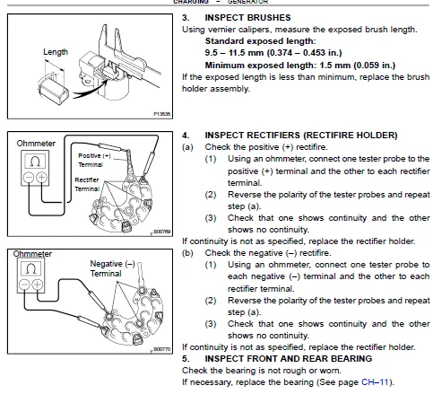

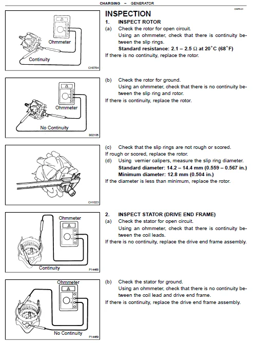

There is a test procedure in the FSM that I have now gone through with the spare alternator. Everything tests fine except maybe the rectifier. If I check using the diode mode on the meter it tests fine. Doing it per the procedure and only checking continuity it fails.

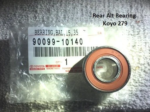

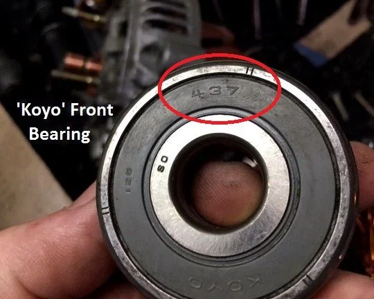

I just replaced my brushes and the 2 bearings...works like new and quieter because of new bearings
There a couple vids on youtube that help you with how to get bearings off and back on with the washers in the right placement which is very important on install

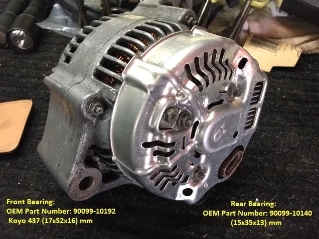

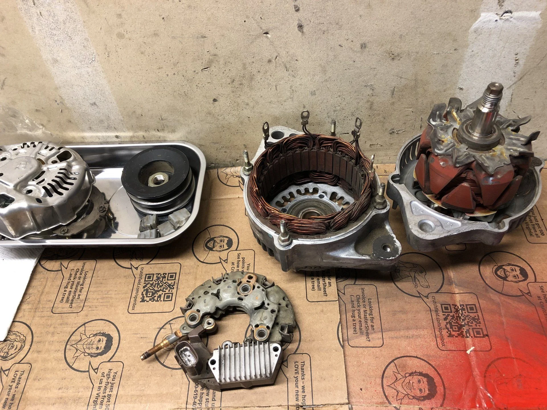

THIS is the correct way to evaluate an alternator (for rebuild). Tear it down, look at it, clean it, test it. NOT just throw brushes in it as is often parroted here (even if that is all that is needed in the end). As above....when I did mine, only Bearings (Koyo's) and brushes (OEM) were required. Original alternator 23 years old, my cruiser had 316K on it at the time.

A spare set of brushes are nice to have in the vehicle however when i rebuild them i usually find at least one bearing that is ready to be replaced. The windings are always filthy and holding more heat than they should, and on an 80 you might find them full of oil and dirt from the distributor. I don't have the best source for nsk or koyo bearings but you can always order using toyota part number but it might not be the best price.
You don't really need a press for the bearings if you are creative with threaded rod and washers.
Everyone should have threaded rod and washers and all 80 owners are nuts already anyway.
