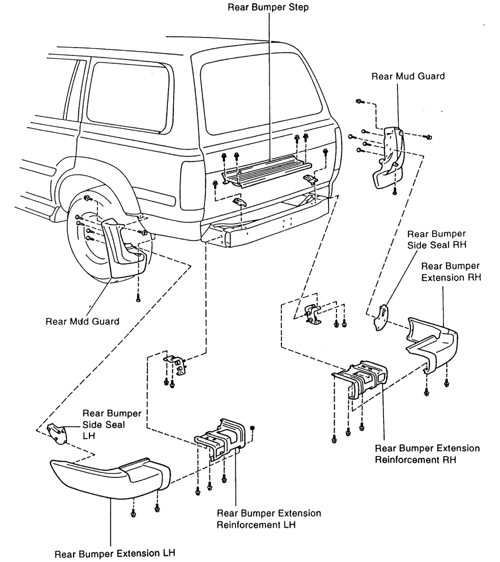

There is no rear bumper on an 80. There's some plastic/tin/tupperwear endcaps, what you think of as the bumper is actually the rear frame member, at least on an 80. Not sure if the lx450 is the same or if there are decorative bits to make the rear frame member look pretty.
cheers,
george.

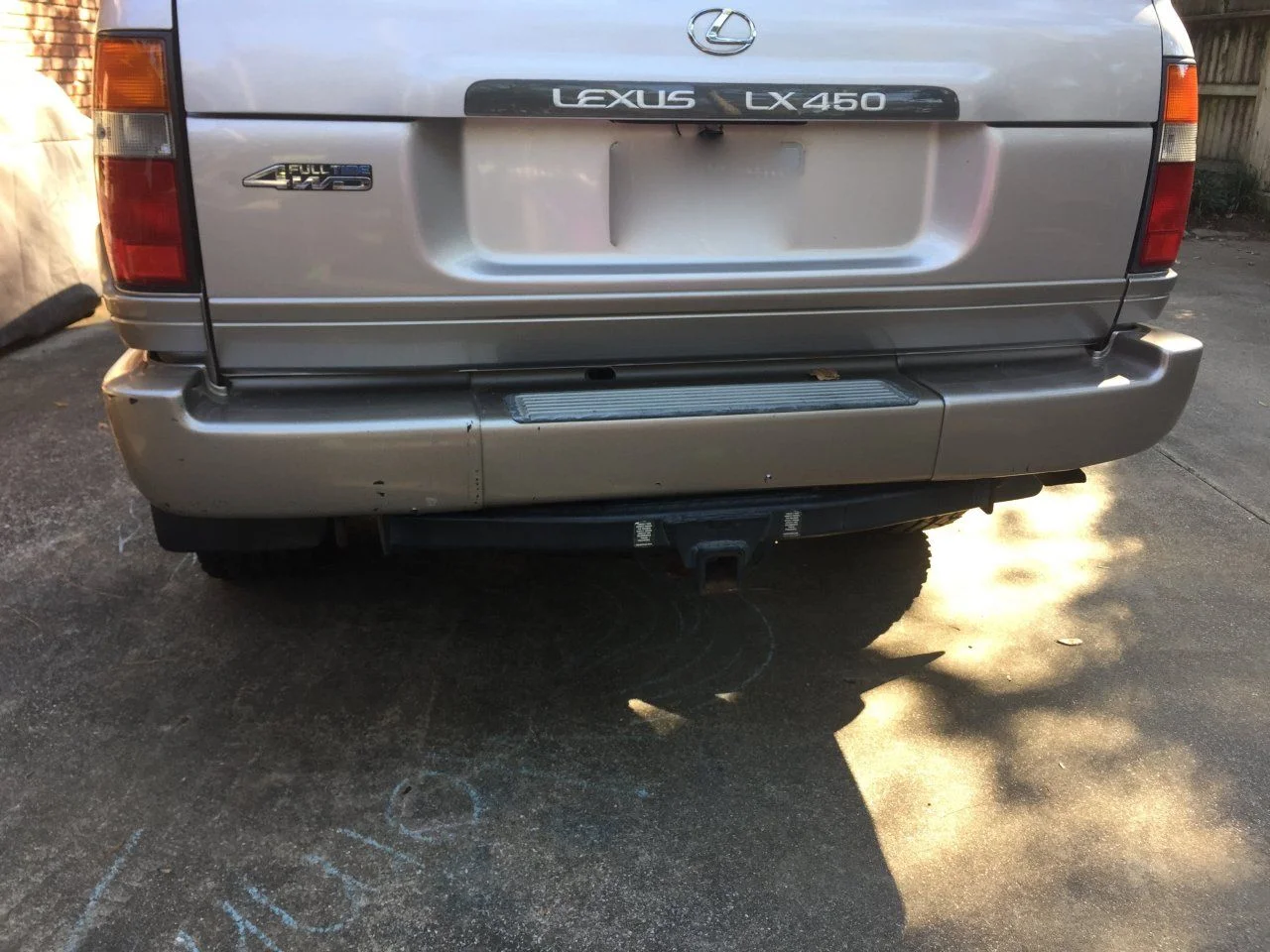

It will fit. The 2 end pieces on the LX are a little bigger to accommodate the larger center piece section with the step plate that also covers the pindle holes of the rear cross member.
No it'll just look like this in whatever color it is.
