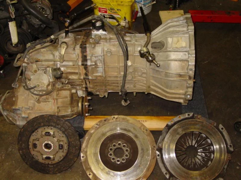

H151 (aluminum case) trans and full time tcase from FZJ80. I have a flywheel and used clutch to go with it as well as shifters.
I dont have all the parts you would need to convert.
You would need shifter boots, pedal work, clutch slave/master, shift fork, TO bearing, and a pilot bearing. Not sure what you need to do for crossmember as I have not done this conversion.
I have not driven this trans. The outputs are tight with no signs of leaking and the input is tight as well.

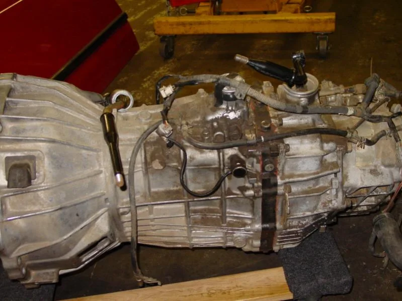

pics
pics of the trans

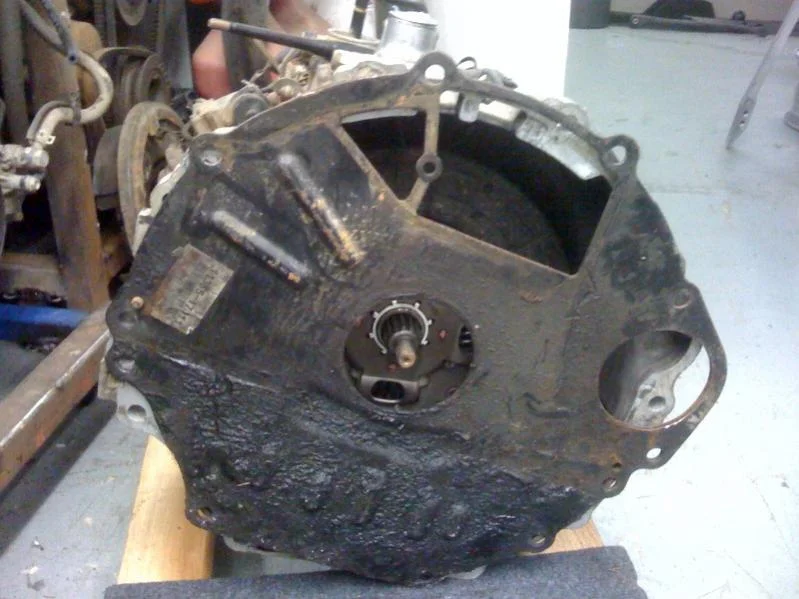

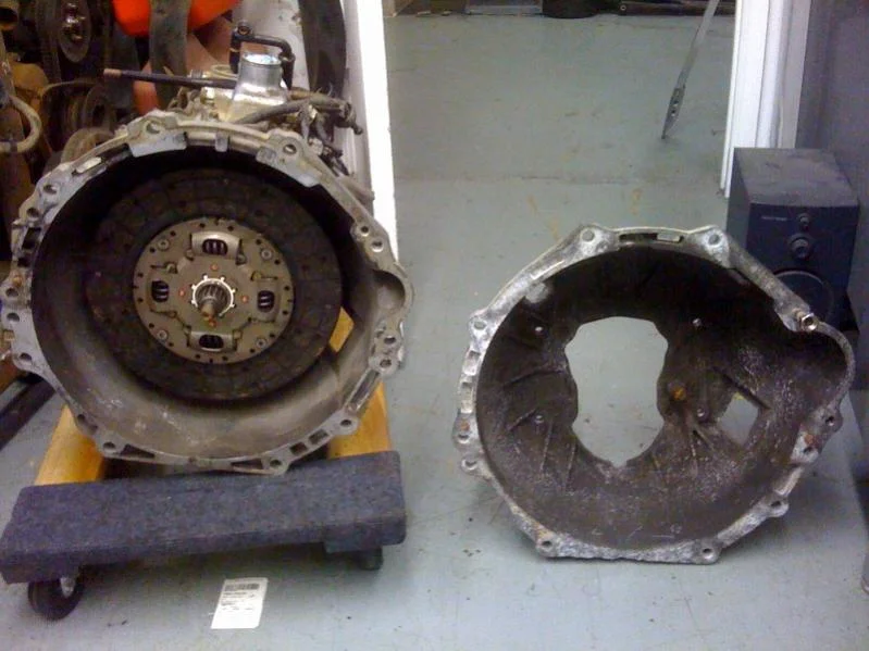

This 151 is from a 96. Ill take a picture of the pattern difference between the two if you would like to see it.

first pic is the 151 with the rear plate from a 1HZ engine matched up. They are not even close.
Second pic is 151 on the left and 1hz bellhousing on the right.
Thanks .. very informative those pics.
You get right .. maybe the diference are in the bellhousing and both ( the FZ and HZ/HD ) share the same boltpather from the bellhousing to the tranny ..
