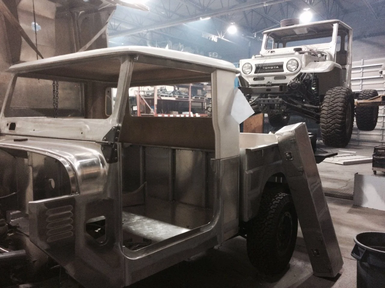

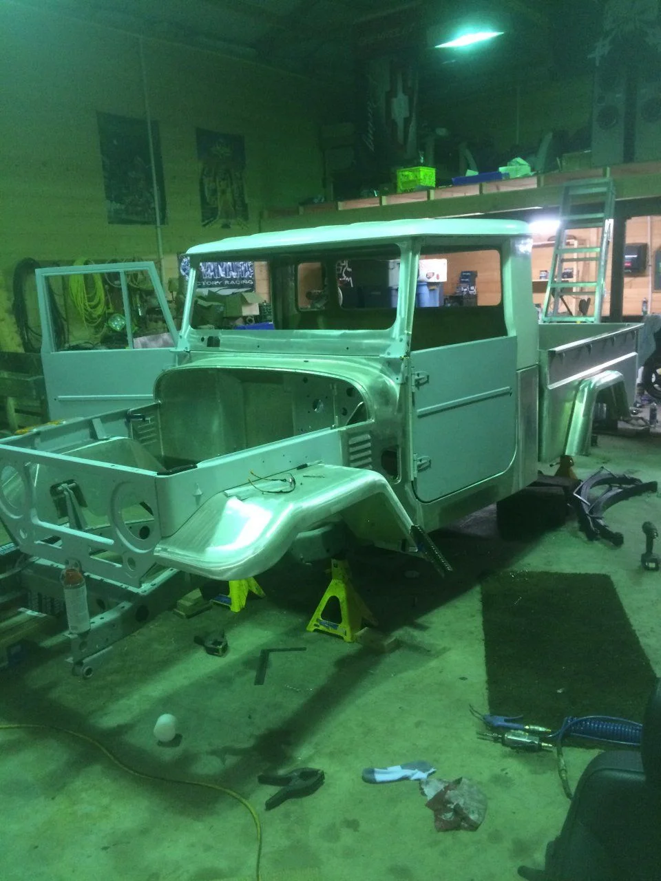

Hey ya'll, I'm as green as they come with this forum stuff so forgive my incompetence… I have just started an FJ-45 Restomod. I'm working with Aqualu Industries and their all aluminum FJ-45 body on a 1997 FJ-80 chassis. The body is mounted on the chassis and next step is the power plant! I considered keeping the 4.5L but after turbo and some tuning i was over $10K! Now I'm thinking GM, Duramax or LS. I know there are a lot of Yota purists on here so please don't persecute me but any suggestions are welcome. I look forward to sharing the build as things go along.
Pics or it didn't happen..
Sub'd! I keep day dreaming of this kind of build. Look forward to watching your progress. Feel free to add massive amounts of details and pics.

Ah ok, It looked like a place in Glen Rosa we sledded to from my Bro's one time. Definitely would love to hook up. I'm in my Monster Truck season now so on the road lots but usually home mid week. Thanks again for all the info. Definitely a "noobie" on here but finding lots of good stuff. I'm picking up my tranny this afternoon and probably stopping at Aqualu later this week to discuss some stuff with Todd. I will try to get some more pics up and keep reading through the threads. I'd like to nail down the T-case this week and start building mounts.
Yes 76 FJ40 mine is also from Aqualu and no they aren't cheap but way cheaper and better quality than trying to cut, modify and refab one from existing parts or building from scratch. And with how $#itty our CDN dollar is right now you save a bunch!! Everything AQUALU does is top quality IMHO and fits well. I'm on my way down there today and will try to get some more pics of the build.
