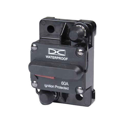

Or, replace it with a circuit breaker.

I bypassed the entire fusible link and used a resettable circuit breaker. Less headache for me at least.

Or, appropriate circuit breakers, but I've read conflicting things about replacing FL with CB's but I don't know enough about auto electric to know what's accurate vs internet chest thumping...

There are slow-blow breakers out there. If you're determined to go with breakers I'd suggest finding those instead of the std breaker. The whole idea is to allow for things like blower motor starting in-rush currents that momentarily exceed the 'fuse' rating without popping it.
