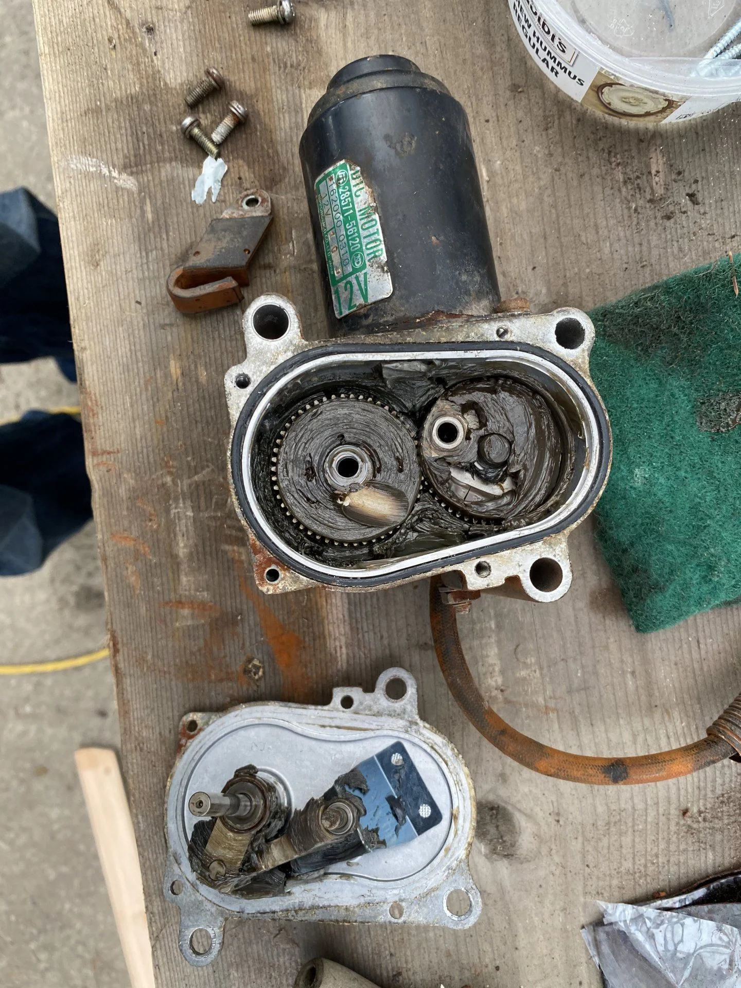

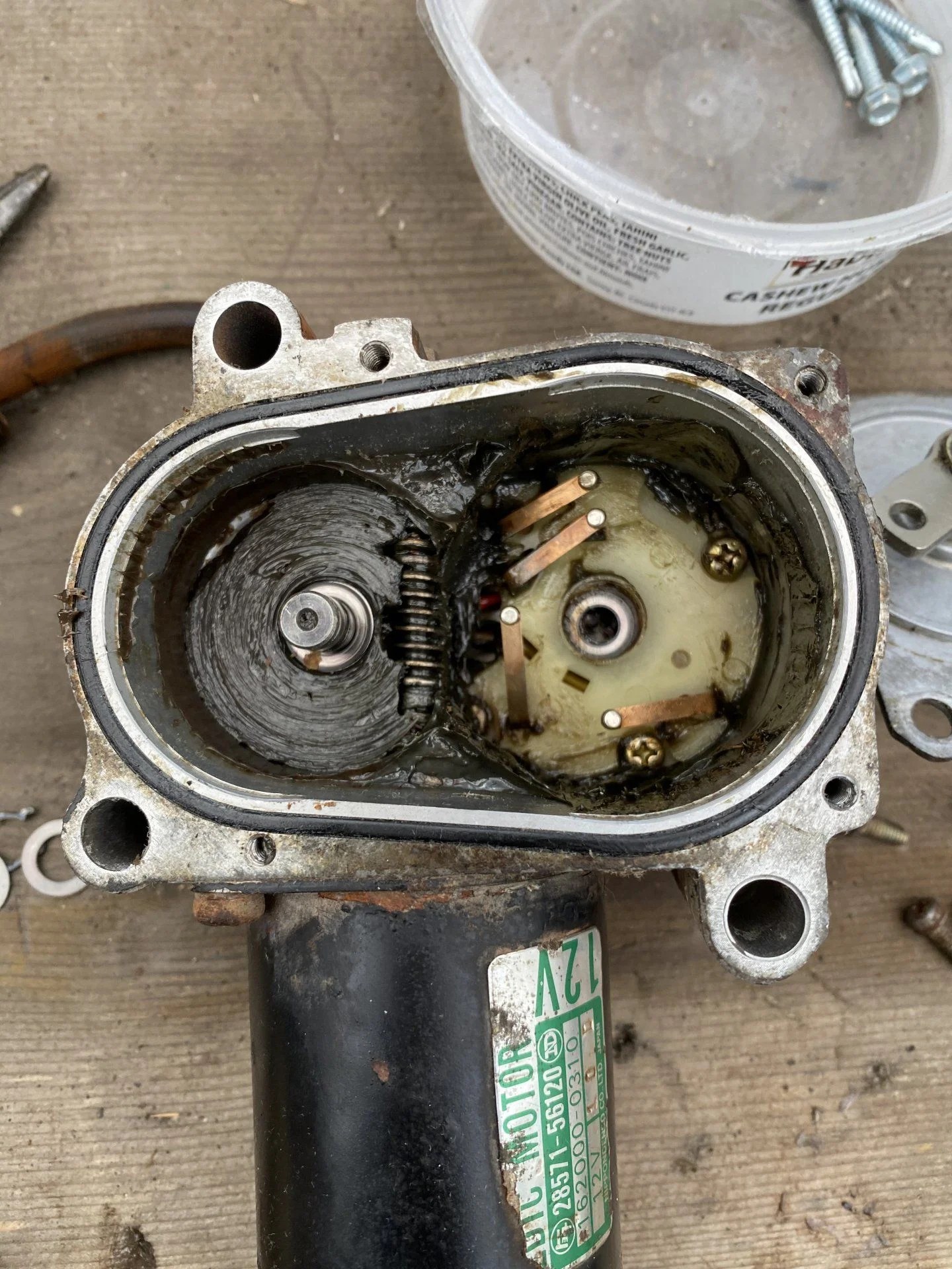

Pulled apart EDIC motor and cleaned contacts

It turns out the answer was replace the EDIC
