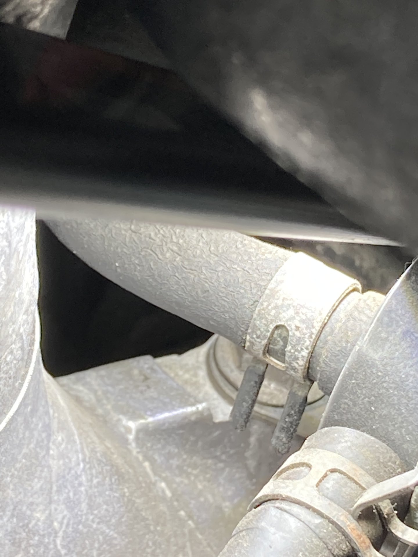

I did find what looks like a thicker vacuum line under the upper intake that looks original and crusty. Pretty disappointed b/c I paid a mechanic to pull intake about a year ago and he agreed to replace all the vacuum lines while under there. I’ll post a pic of the vac line- it runs off the blue vacuum switching valve that the charcoal canister hose runs to. It’s a short rubber hose that runs out of the vacuum switch valve toward front of truck and
turns to go toward passenger side to a hard line. If that short rubber line is leaking would that cause missy idle and higher long term fuel trims?
I did find what looks like a thicker vacuum line under the upper intake that looks original and crusty. Pretty disappointed b/c I paid a mechanic to pull intake about a year ago and he agreed to replace all the vacuum lines while under there. I’ll post a pic of the vac line- it runs off the blue vacuum switching valve that the charcoal canister hose runs to. It’s a short rubber hose that runs out of the vacuum switch valve toward front of truck and View attachment 3078729turns to go toward passenger side to a hard line. If that short rubber line is leaking would that cause missy idle and higher long term fuel trims?
In partsouq diagram lookup looks like it’s called a fuel vent hose, which makes sense to me since it runs to charcoal canister. Wondering if this old vent hose could cause a fuel starvation problem or a vac leak?
a vacuum leak would increase your LTFT values. and the values you are reporting are in line with what I've seen.

Although, if you have a vacuum leak and are sucking in unfiltered air, I would fix it no matter what. Especially if it's just changing out some hoses.
