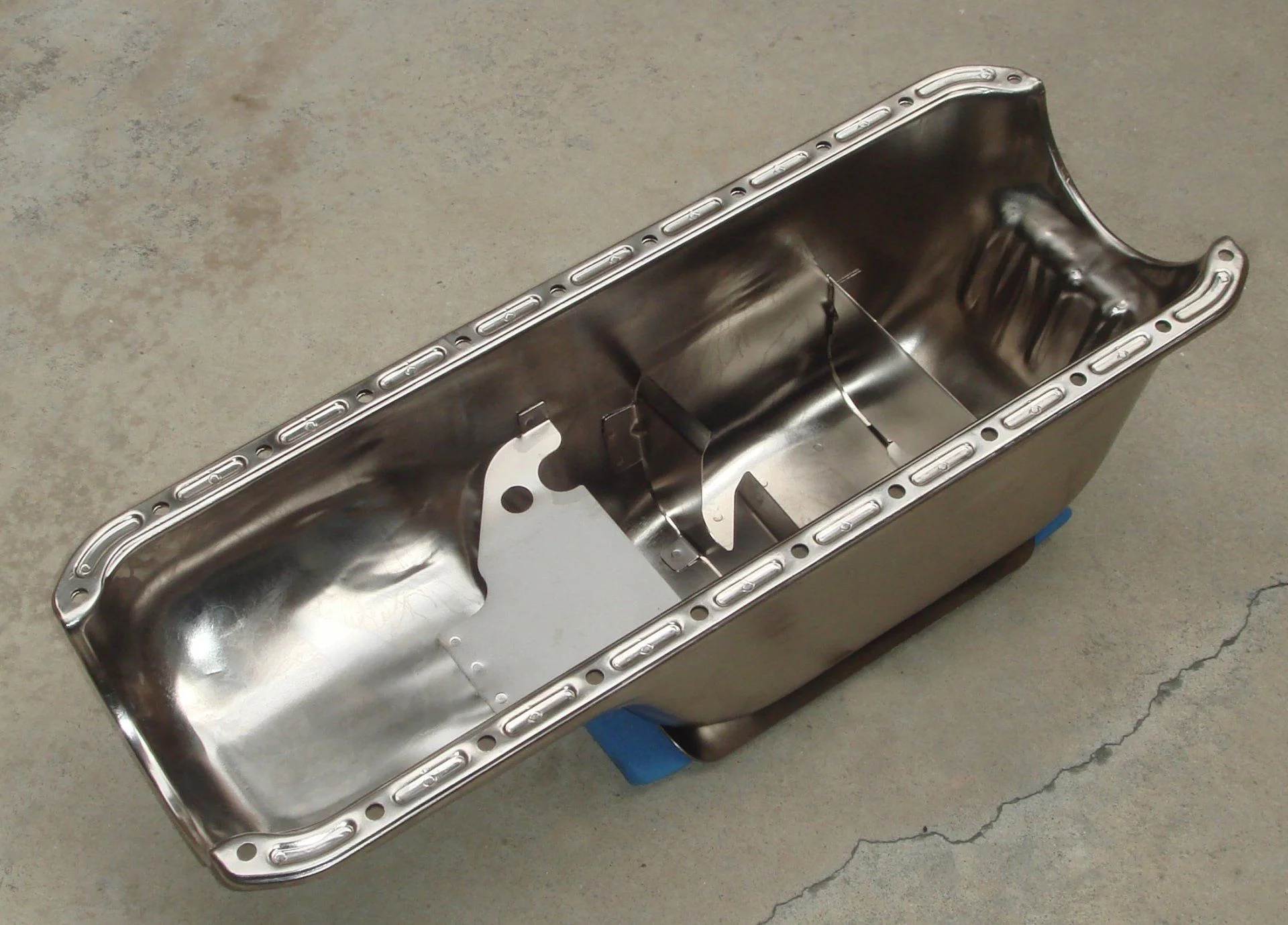

This is what the inside of the oil pan looks like. The pump arm fragment could be sitting quietly on the floor of the front raised section. Or it could have migrated rearward and dropped into the front baffled chamber. From there it couldn't go any farther back. The oil pump is screened and raised up off the bottom so it's impossible to suck the fragment into the oil pump. The crankshaft spins above the level of the oil, so it's far away from the bottom of the pan.
The likelihood that that pump arm fragment could cause engine damage in the future by getting caught up in the crank I would place the probability at .0000001% possible.
But even still, it's not a pleasant thing to know its sitting in the bottom of the pan.
I can't see it being possible to extract it out of the drain hole with an articulated magnetetic finger due to the baffles being in the way.
I meant the hole on the block that the fuel pump hooks into. Def not the drain hole.
