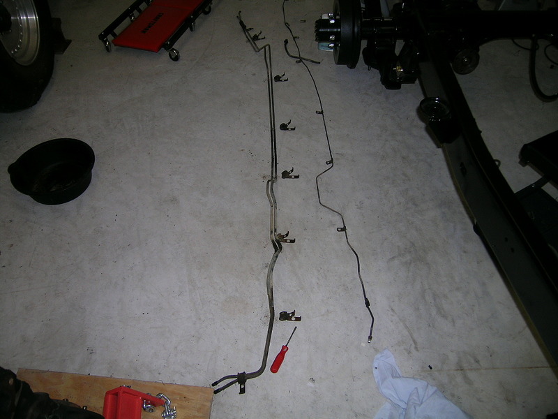

This is probably a thread that has been posted before but what have people done in the past to replace the fuel lines that run along the frame. My hard lines are looking a little ruff and I guess I may have a shop put in some new hard lines since it is hard to get steel lines that long from the autoparts store.

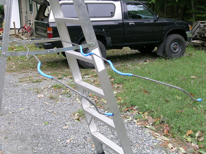

I rehabbed all of my lines.
They are NLA from Toyota and would be an MFer to ship if you found good replacements I would imagine.

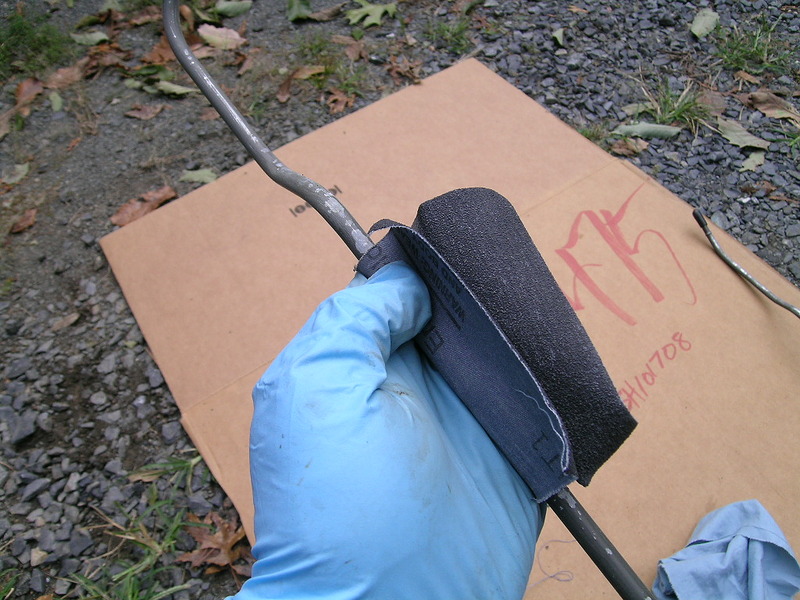

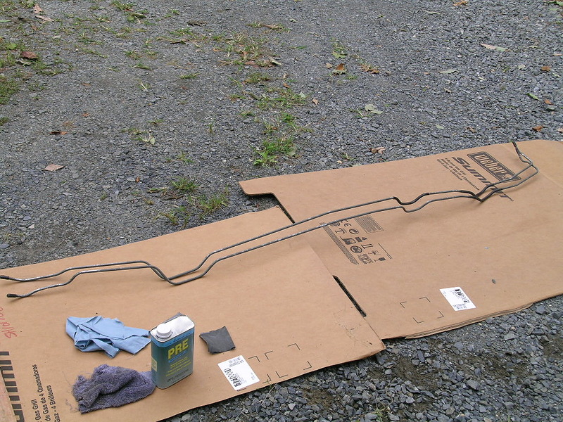

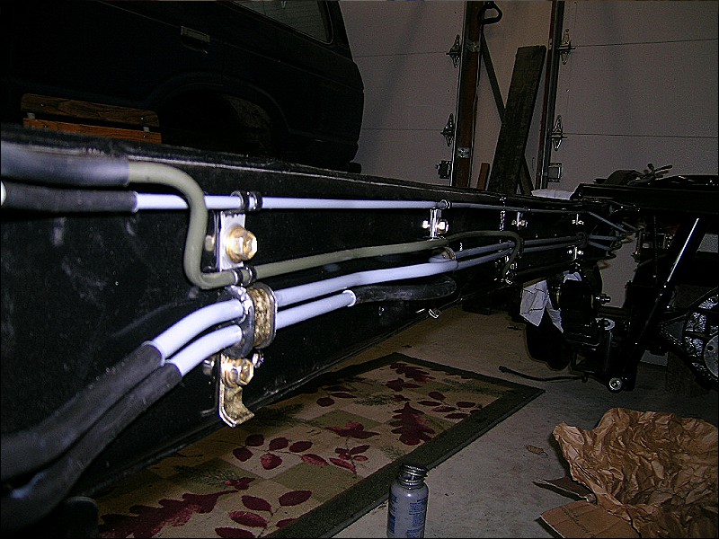

I pulled them all off, plugged them, then cleaned and sanded them down. I primed and spray painted them with several coats.
Good as new.
I'll post some pics when I get home.
