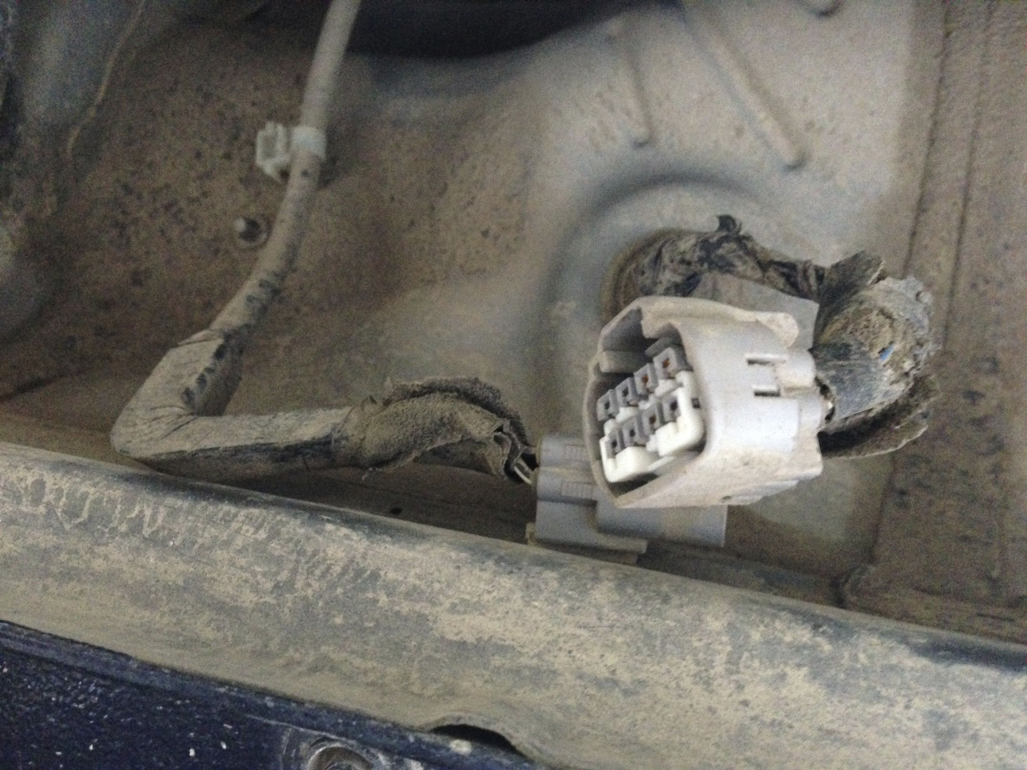

The FSM says to unplug the harness that gives power to the fuel pump. It is located somewhere under your driver's side doors...
Unclip this thing, start the engine, and within a few seconds, it'll stall and you'll be ready to go at the filter with a few wrenches.

There was no way that wire clip was coming undone in mine. And supposedly per FSM, the green thing isn't supposed to be reused. But I didn't see that until I had it all apart. :meh: Is everyone just reusing, or ordering new with the filter? I reused, and have no leaks, so assume all is well...
The clip on the wire harness required some gentle coercing (prying) but came loose eventually. Sounds like that step may not be "necessary". I reused the green thing too...so far so good.
