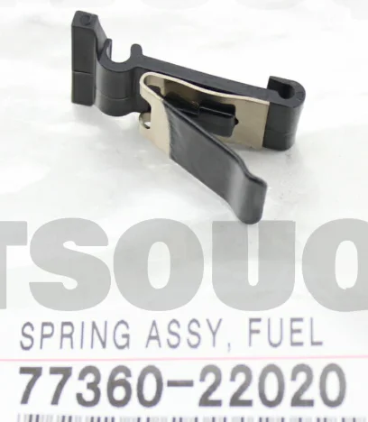

Is my fuel door missing a spring?

Your spring appears to be present and intact. I’ve had 4 80’s and the gas door normally opens an inch or two. As far as the effort needed to pull the release lever, I have no suggestions other than trace its entire length looking for obvious defects and kinks, etc…. iirc the spring is NLA.

The spring is definitely not NLA.
77360-22020
This. I just ordered one a month ago. Is there any resistance when you close the fuel door ? If no, you need a new spring.
No resistance. I am ordering the spring and I am going to check my cable and see if there is anything I can find or clean and lube.

The fuel filler door on both my 91 and 97 open to about 60 degrees when I release the catch.
The door itself is held in place by 2 small bolts and comes off easily for cleaning and lube. There should be little to no resistance in the hinge.
That little spring that @OGBeno mentioned is key.
Spring ordered

Thanks for mentioning this subject. This thread lead me to checking out the gas door situation in this 96 I bought and commenced to tear apart. What I found is a hinge in serious need of lube and no spring, not even a piece of it there. Another spring on order…..
