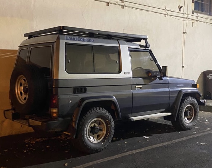

Was it a bad idea to drill into an FRP top for roof rack needs? Work performed by Front Runner

I will post detailed images tomorrow, but basically its 2 rails near the edge of the roof that were drilled and the rack can come off if needed but the rails are fixed in. So far its been 7 months and no rattle and we had the heaviest rainstorm ever recorded in the city i live in of 1.36 billion gallons of rain water within an hour and no leaks but was wondering on y’alls opinion of drilling into it.

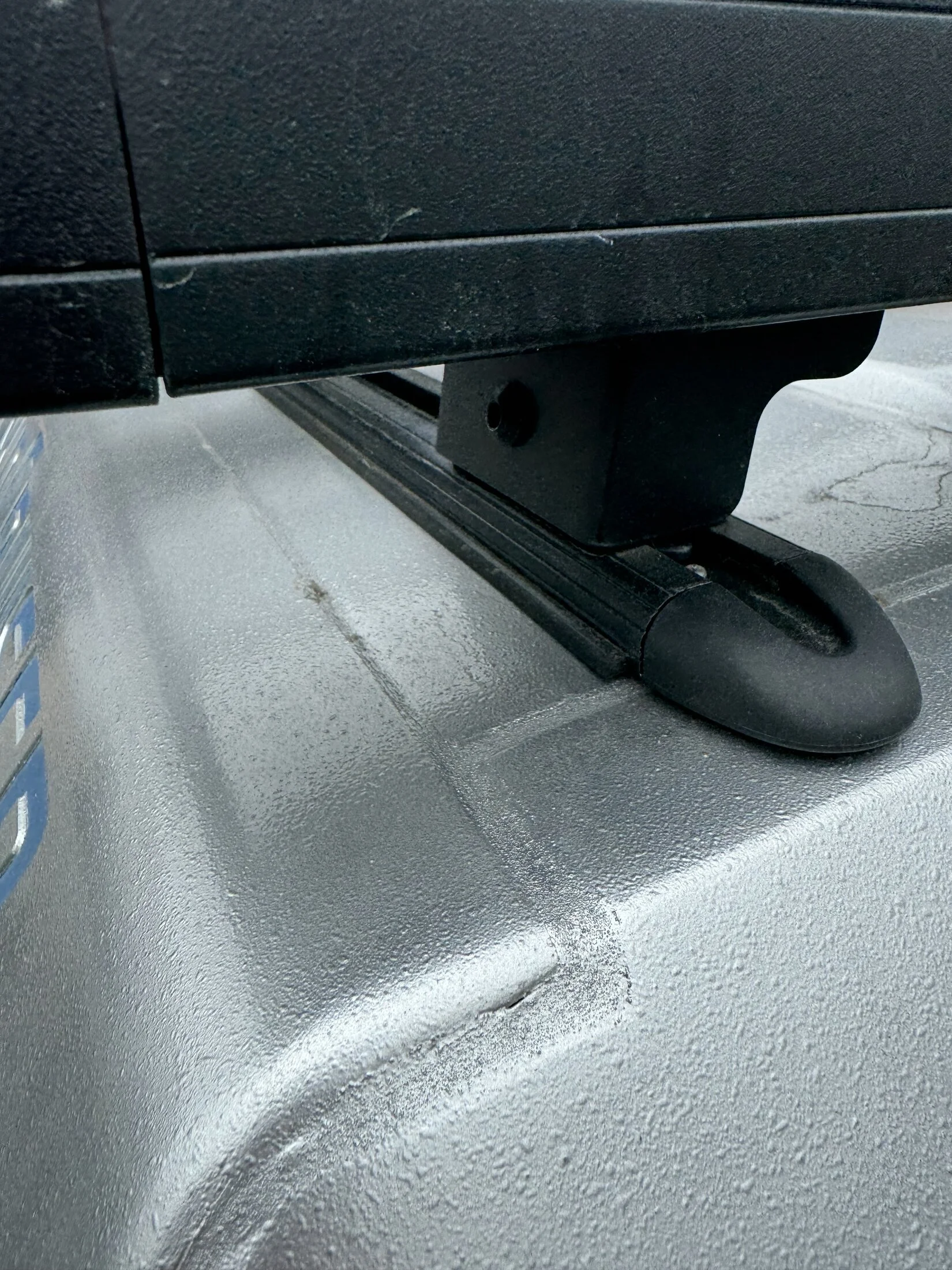

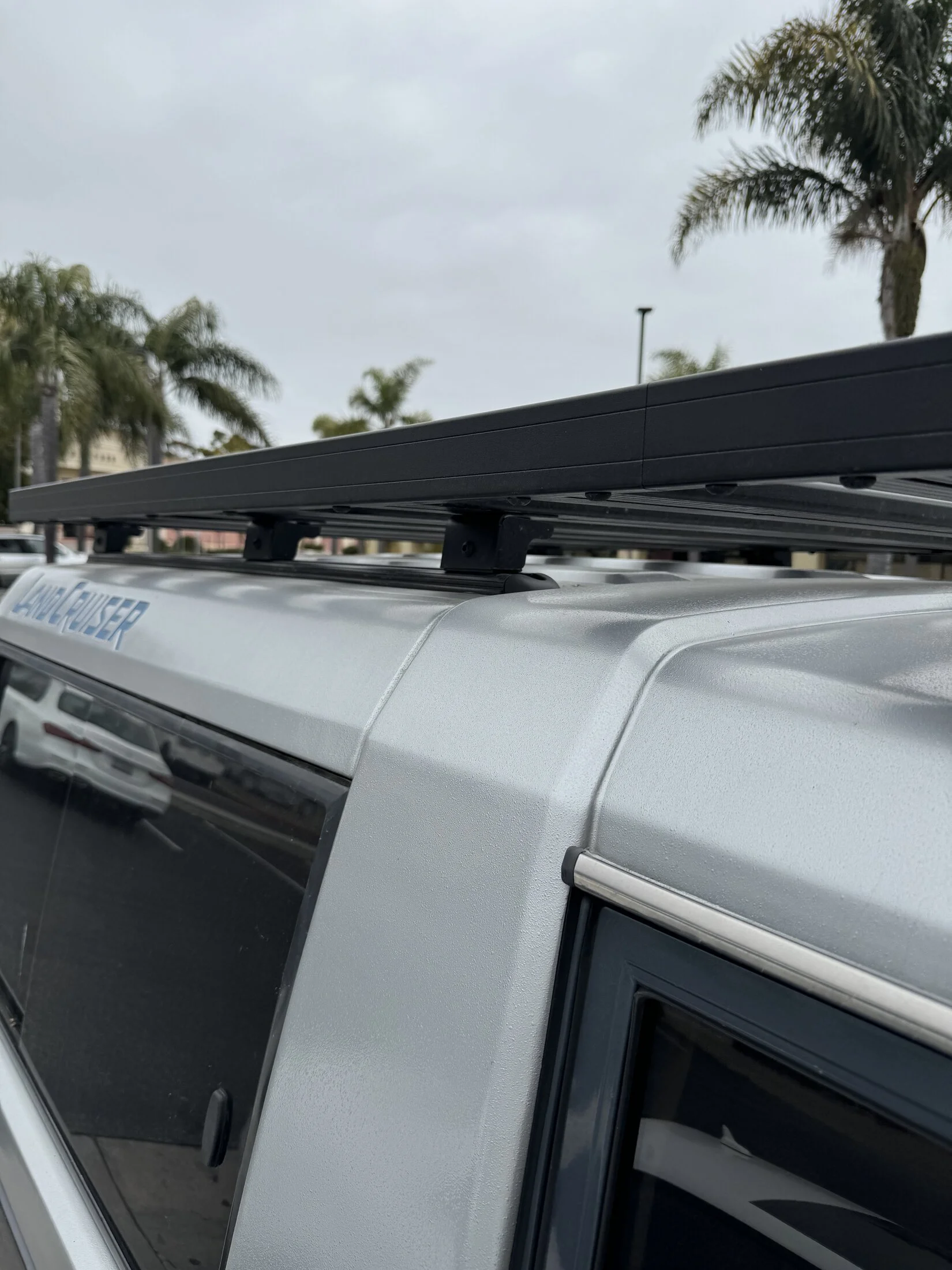

Ah. It's kind of a cargo rail, which is mounted across the edge of the FRP top, where it is actually flat.
That might work if (!) the top rail is actually properly glued to the outside of the FRP top.
I recently had a conversation with a professional who installs airline cargo rails to RVs (kind a similar plastic stuff) as I'm considering something similar for my FRP top. He said, the actually distribution of force is all based on the adhesive, which is very strong, if done correctly. Key is a proper thickness of the adhesive bed of about 4mm, to allow movement, plus a proper preparation of the surface. They use SIKA products here in Germany. They actually use self tapping screws (but some more), basically only to provide an even and controlled downforce during curing. (The screws actually do not contribute to the strength, so they could even removed those afterwards, if not that would create a hole and leak).
Bolting on that cargo rail on those few spots with only washers however would not holdup, I think, due to lack of distribution of forces.
But I'd be pretty confident the guys at Front Runner know what they're doing and glued it down.
Cheers Ralf
Would be very strong. The bolts through the legs are compressing the runner like a plate to help spread the load over the roof and if a transport sealant or similar was used would also add strength and help seal the holes. The skin on these are thick and with the foam centre makes them quite rigid.
If anything I'd be inclined to be rid of those internal washes and use a nice anodised strip of full length aluminium even it it only imprves the appearance.
