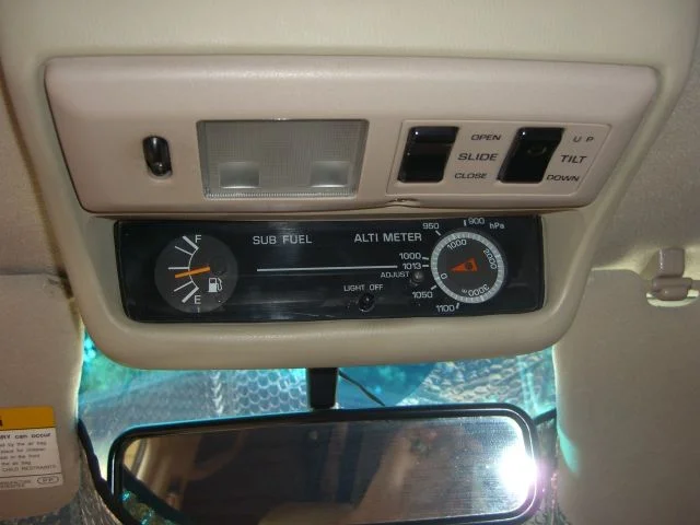

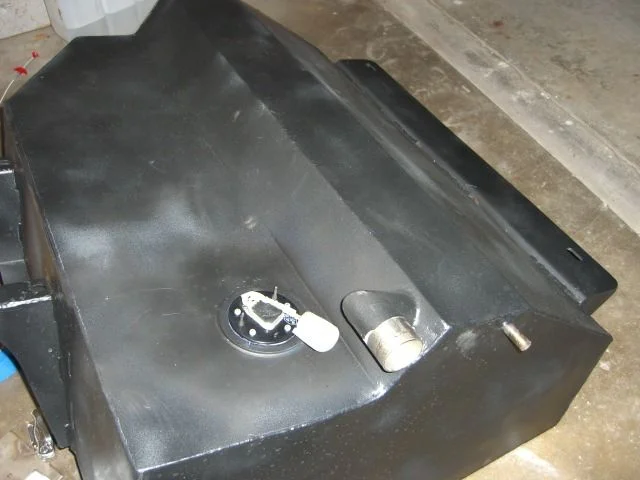

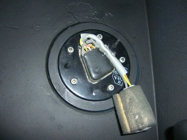

My biggest goal was to keep the OEM sending unit but the FrontRunner doesn't come tapped for that (the LongRanger does) so I had to make arrangements for the sending unit.

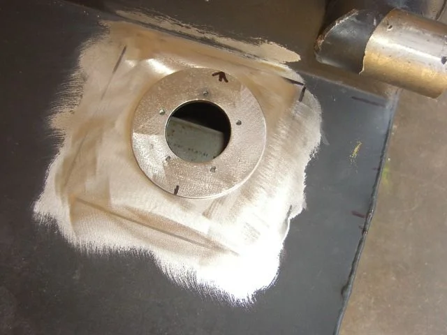

I found an enourmous industrial washer at the specialty hardware store about 3" across and the perfect 1.75" inside diameter. I tapped holes for the OEM sending unit screws in the washer so that it would become the base plate for the sending unit to attach to since the tank walls are too thin to tap properly.

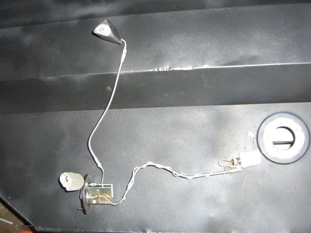

Next I had to determine where to mount the sending unit and how to modify the swingarm/float and low fuel sensor for the deeper tank. I mapped out the location of the baffles and support beams in the tank and extended the swingarm for the best range of motion where it won't snag on the internal supports.
To extend the swingarms, I cut the arm/wire and crimped on some stainless tubing as the extnsion and then crimped the end piece back on. A little JB weld (which is rated for gas tank repair) seals the ends of the tubing so the tube is bouyant. I was a little concerned that the float wouldn't be bouyant enough with the added weight of the longer arm. By making the arm extension bouyant it solves that potential problem. I bent and re-bent the extended arms until I was satisfied with the range of travel.
Then I cut a 1.75" hole in the tank in the chosen location, prepped the surface, and JB welded the tapped washer to the tank, careful to keep the epoxy out of the sending unit threads.

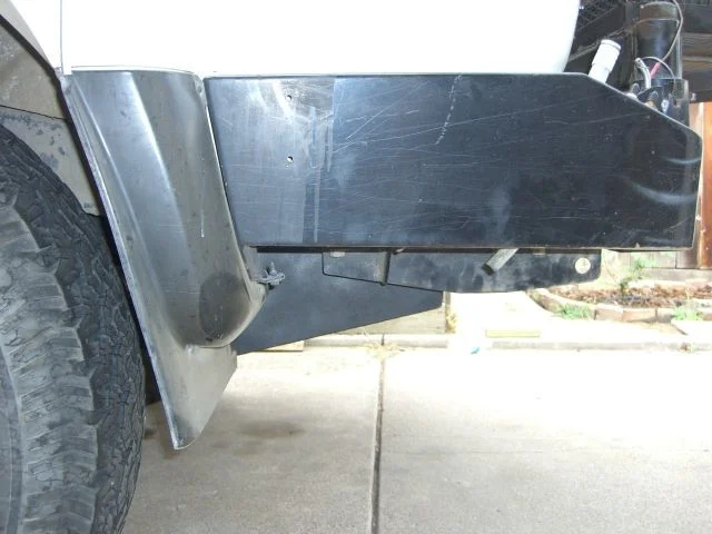

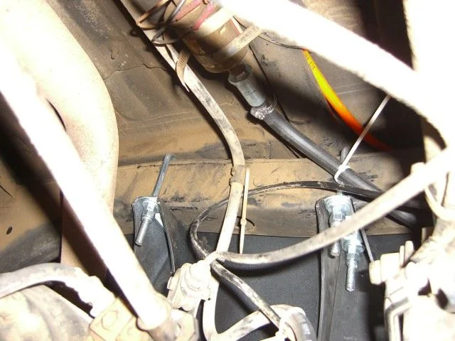

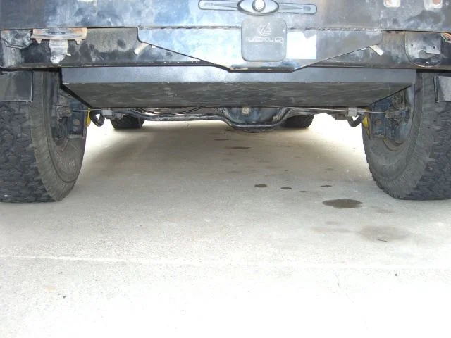

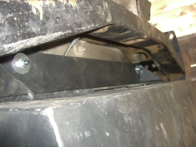

The tank mounts using some 3" square u-bolts over the frame cross brace toward the front. Those are easy to install once you get the tank into position. The tank is pretty heavy and getting it into position is a real pain. I placed the tank on a piece of plywood on a floorjack and raised and wrestled it into position. At the rear, you have to remove the bar that goes across the inside of the bumper frame - not sure what it does but I think it stabilizes the stock spare tire. The tank comes with brackets that attach to the holes from this stabilizer bar.
At first I was miffed because the brackets aren't drilled. But after test fitting I realized the wisdom in that. There are an infinite number of minute adjustment to fitting the tank and since each chassis is slightly different, the brackets are the easiest thing to drill for the best positioning so they each ended up at an odd angle but the tank is centered.
It's all mounted and tested and seems to work great. The tank took just under 45 gal which cost about $120 at the cheapest gas station in SoCal. I figure now I can make it from LA to SanFran and back without filling up. Good for our long term Africa travel goals.

Wow, that's a big tank! Looks pretty susceptible to damage and hangs pretty low. You planning on fabbing a skid plate for it? I'd recommend it. Don't get me wrong - I appreciate the beauty of an aux tank and have it in my long range plans. It peaks my interest immediately when I see a thread like yours. CampingLabs website said about $700 - was that what you paid and how much for shipping? I like the way you fabbed the sending unit! Keep us posted on it's performance. :cheers:
How about a side profile pic, from about bumper height. It would give a good idea as to departure angle with the aux tank.

Whats funny is that the stock tank sits lower than our aux tank. Stock at its lowest point sits 18.5" off the ground. The aux tank at its lowest point is 21" and our hitch that's integrated in our Kaymar is at 22".
Here's a shot of how high ours sits.. 2 years and i've never hit it once.. and we go out 1-2 times a month.
I'd like for someone with 33's and 3" of lift to measure they're spare if they have one back there.. i bet you our tank doesn't sit any lower.. and how often do you hit your spare?

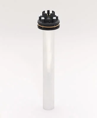

I want to run some sort of fuel sending unit and gauge, but not one out of an OEM sub tank or overhead unit. I was thinking about running a tube style sending unit with a corresponding correct gauge in the right Ohm range, 0 Ohms empty, 90 Ohms full.
The below sending unit is 11" deep. Where AdventureBuddies installed his OEM sub tank sending unit is 12.5" deep. Any thoughts? Does this sound like a sound way of installing a stand alone gas gauge for the auxilary tank?
