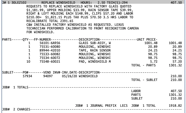

I had to have my 18 replaced. I wanted Lexus glass and the dealer to install (or at least stand behind the 3rd party). They would have to do the calibration if another company installed.. below is the breakdown - the other Lexus Dealer in the area was $200 more. Originally quoted $2391.65. Labor ended up being less than quote for a final charge of 1918.82 plus tax.

I'm sure there is great variability on what parts are replaced outside of the glass that's broken. If you see my parts list above you'll notice that everything was replaced with new. I'd speculate that people with issues are more than likely getting installers that reuse what they can.

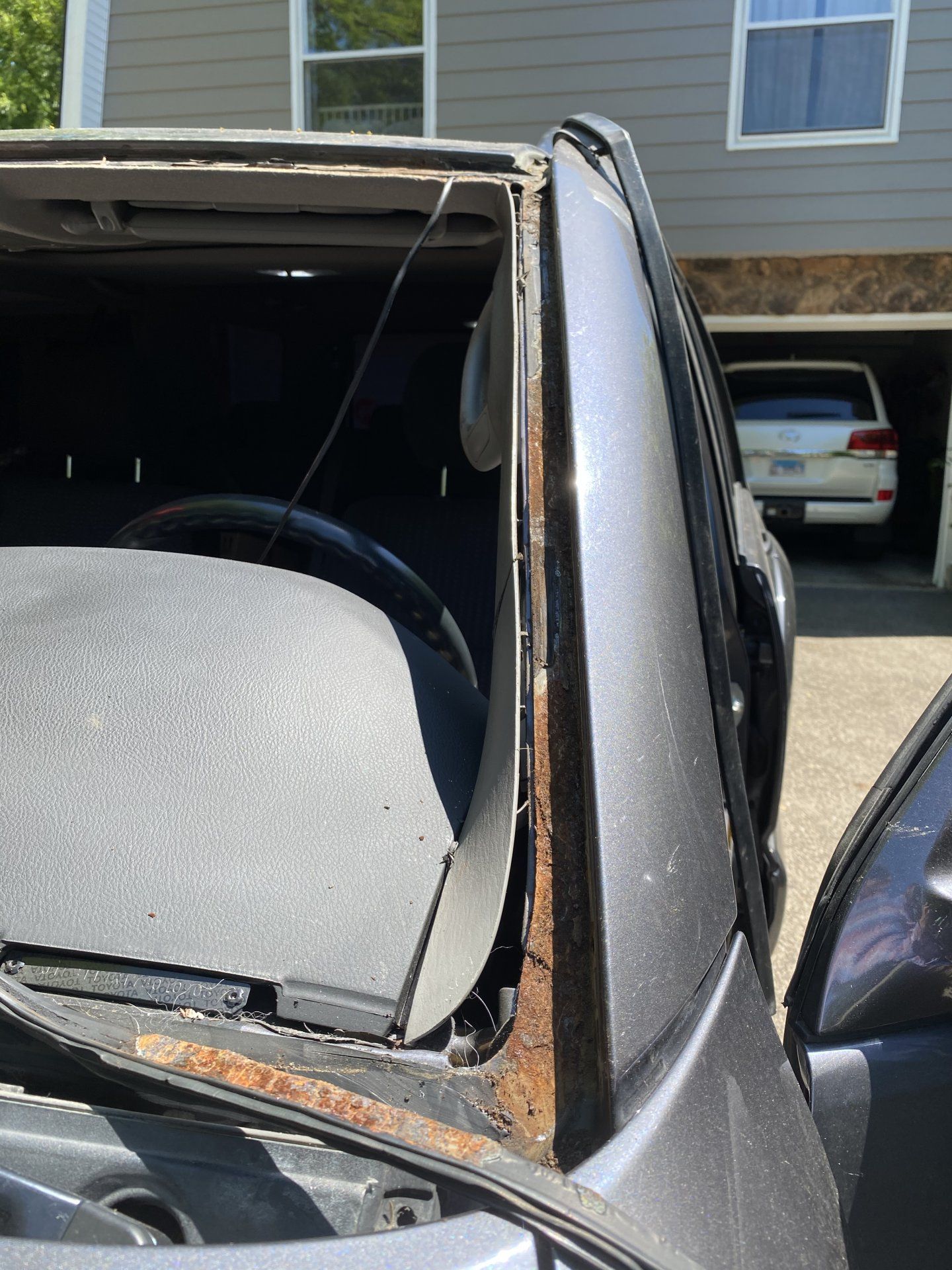

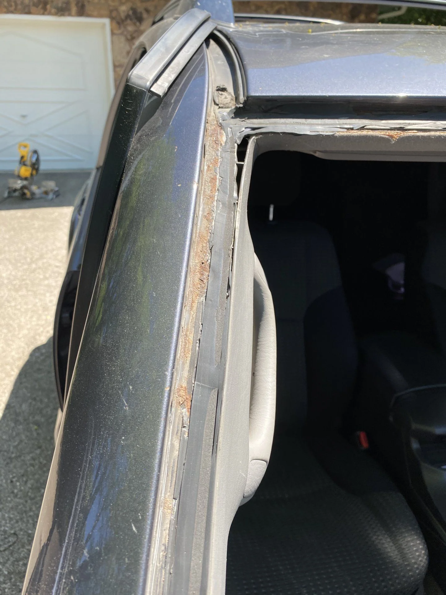

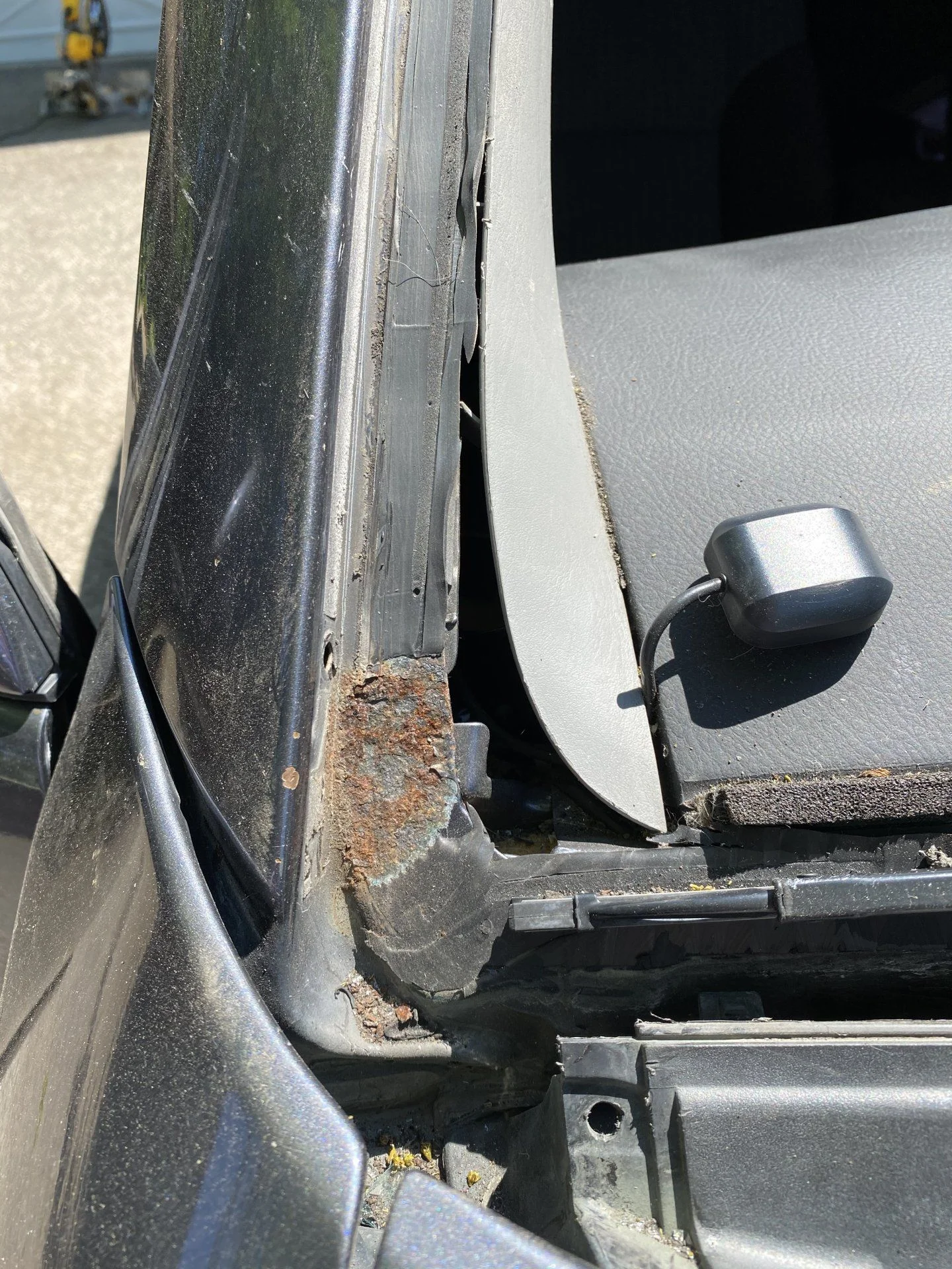

How about this? This was a botched install that Safelite did on my 4Runenr which has the same mounting system as the 200
I ended up fighting them and they paid for $2,000 in bodywork to have the entire windshield frame repainted at a body shop.
So yes, **** Safelite.

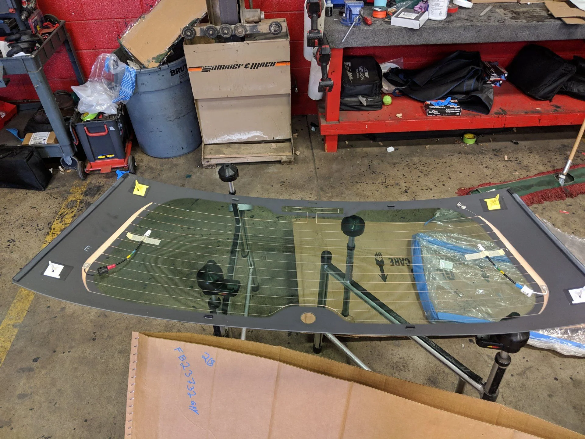

@04UZJ100 as they say, a picture is worth a thousand words. I have USAA and they use Safelite, and I used them for my rear hatch window replacement. Luckily (maybe) the tech was a Toyota fan and was happy to be working on an LC. Also, OEM glass was provided, and the tech said that almost never happens, and it is better. Why I asked, and he said that it was the details like alignment pins, shims for the correct depth of the window during installation, etc.
Is what he said true? See the pic of the rear window and look closely for what he described, pins and shims. Do the aftermarket replacements have the same?
