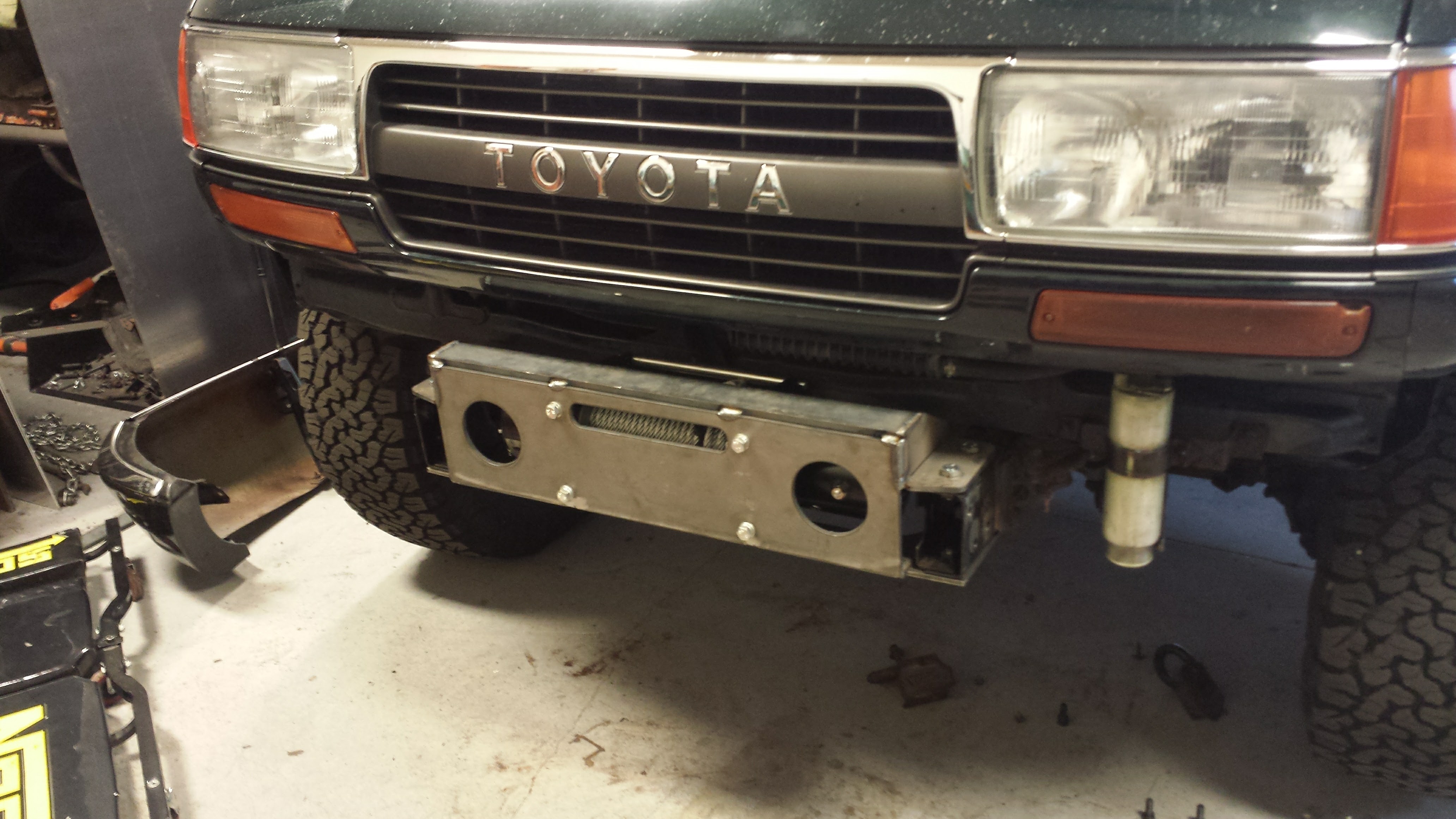

Not really. I had a hidden winch mount behind the stock bumper before this, and the mount uses up all the space right to the front edge of the frame. You can see it in this pic:
You can also kinda see in that same pic, as soon as the winch moves up any, you start to get into the trans cooler, valence and grill. You could set the winch a bit lower than mine if the front of the bumper is more vertical...but I wanted it slanty. :)
