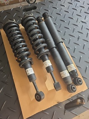

Here are a few on eBay. They are very inexpensive and would be preferable to low-cost aftermarket stuff like Moog. You might be able to find a set on Craigslist as well. If it were my rig I'd shoot for a TRD Pro or TRD Off-Road takeoff from a 4Runner. Per my previous posts they will require some minor mods to fit on a 470 (these mods are well-documented on the web - I think they include drilling out the rear upper shock mount in the frame and grinding down the front lower shock bushing to fit in the 470 LCA - but please confirm).
The best bang for your buck would be a low-mileage takeoff suspension from a 5th gen T4R or GX460 (someone who just lifted their rig). If you aren't able to find one of those, I'd go aftermarket, as most aftermarket shocks will ride better than the OEM Toyota shocks.

I just picked up a 500 mile front coil over and rear shocks from a trd. I know I have seen the write up before but can’t find it. Not successful in many searches to find it either.
