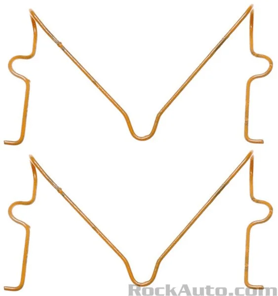

You need these... I had the exact same noise and similar feel to the pads (didn't feel loose by hand). The sound didn't totally go away until I installed two per caliper. There was only one per caliper when I bought the truck.
1950430
Gotta love it when it is something simple!
