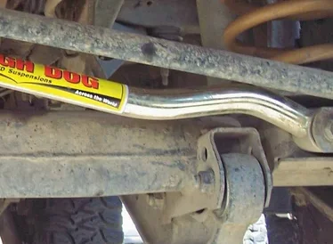

I am looking at a Dobinsons 0-3" lift package. Probably most of you know that they offer an adjustable front panhard rod as an add-on. Of course, my question is how does this work considering that the non-adjustable OEM rod is curved? I did see that Terrain Tamer offers both straight and curved adjustable panhard rods, so there is something going on here, but I do not understand it.

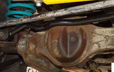

The front Panhard bar is curved due to diff. My Dobinsons adjustable Panhard bar is curved for my US LX450, like OEM.
It is curved as well for right hand drive due to bracketery.
Thanks for your response. From what I see on their US website, the panhard bar is not curved. This is their part number, PR59-1408. Maybe the photo on their website is not the actual photo. Probably I need to call and ask them.
That is the exact Panhard bar that I have: PR59-1408 and you are right, the web site shows it is straight, but it is indeed curved.
Thanks for both replies. So goes my first question. Would the stock panhard work with say a max 3" lift?
