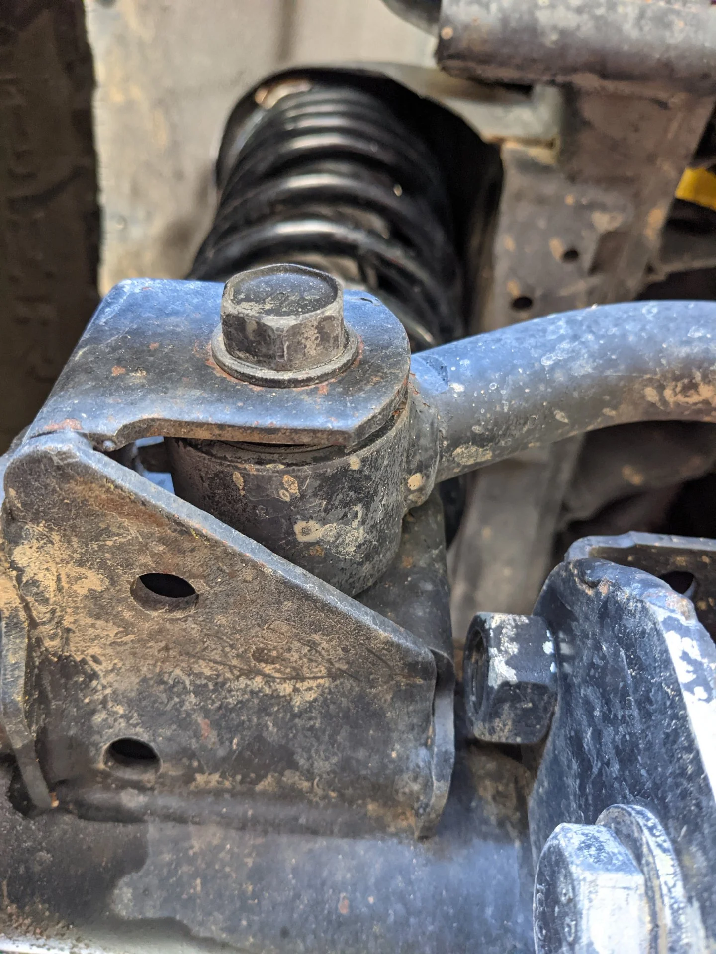

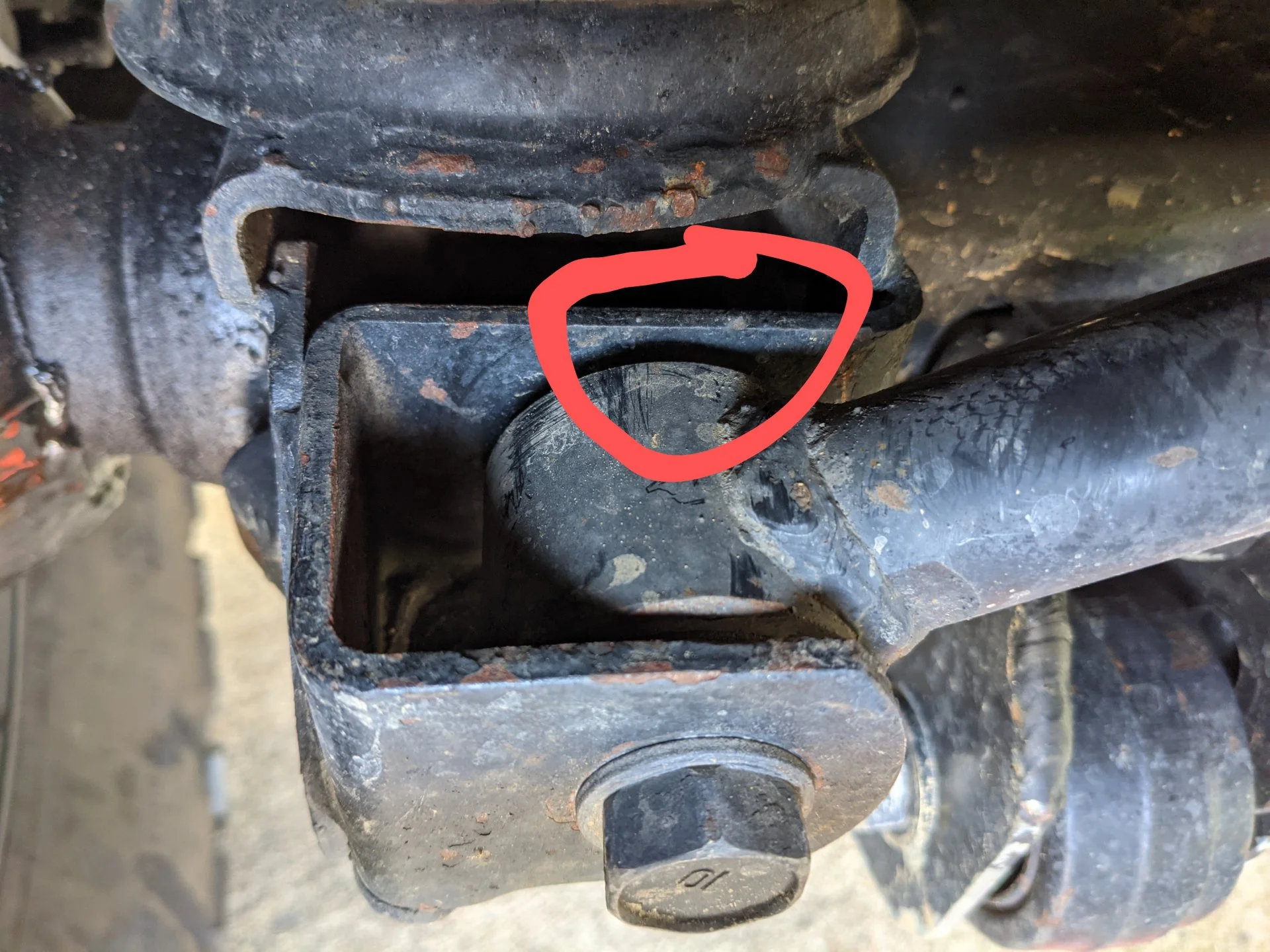

I don't claim to be an idiot much, but one would think (2) bolts on the front panhard is easy peasy.
How do you access the lower side's nut?
Maybe it's welded on??
Well I figured that out on my own..
So welded? I just don't want to impact the bolt and hear the plip of a nut falling into that boxed out area..

Yup, be careful. Mine stripped out and I just added another nut at the end of the bolt and slide a thin wrench in while tightening now.

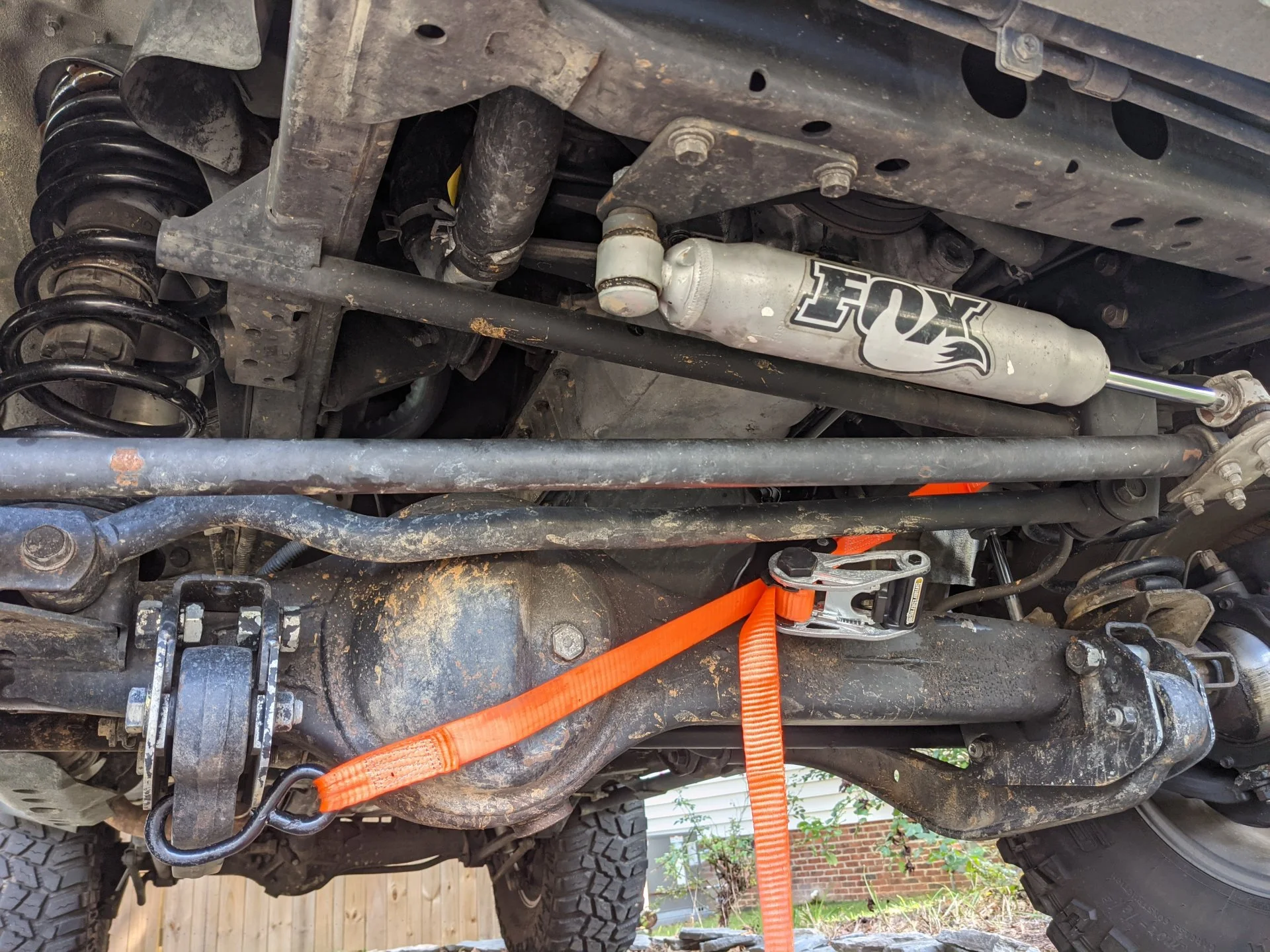

Super simple job- aligning the lower bolt on reinstall was annoying- tie rod sorta in the way but had the 6yo daughter work the wheel back and forth (had the axle ratchet strapped to the frame) and it eventually aligned without blocking.

I broke the nuts welds today, any suggestions on getting it off/on?
cut the front edge of the spring perch to give you access to the nut. Then go in with a stick welder and burn that nut back on. The heat should break the bolt free from the nut and you can then back it out.
I ended up gridning the perch back a little to get a wrench in there when i got home, the drive home was enough to loosen the nut and it came out easily.
