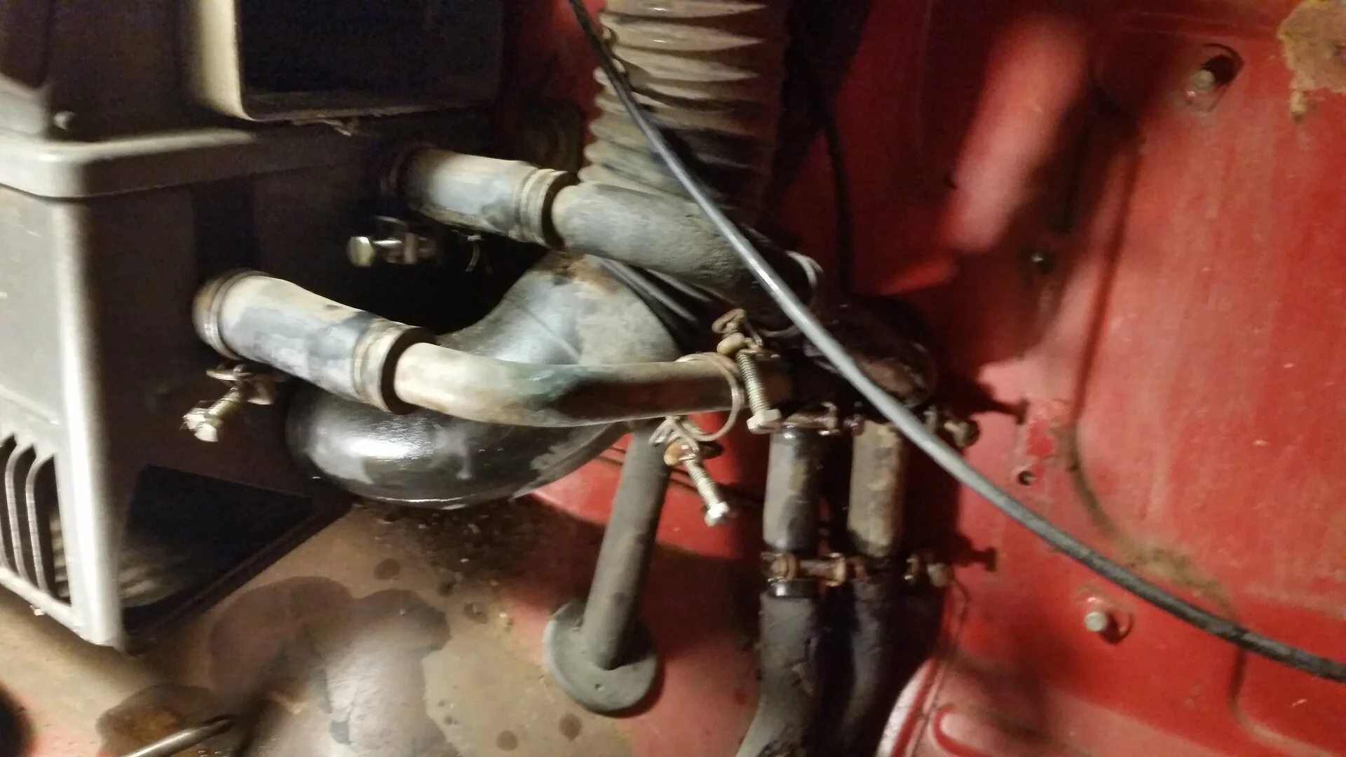

Looking for someone that can send me a picture of how the copper tubing is layed out on a '73 FJ40 going to the front heater as well as any pics of the tubing going to the rear heater.
Thanks in advance.
This is on a 75. I hope it helps. It's all I got.

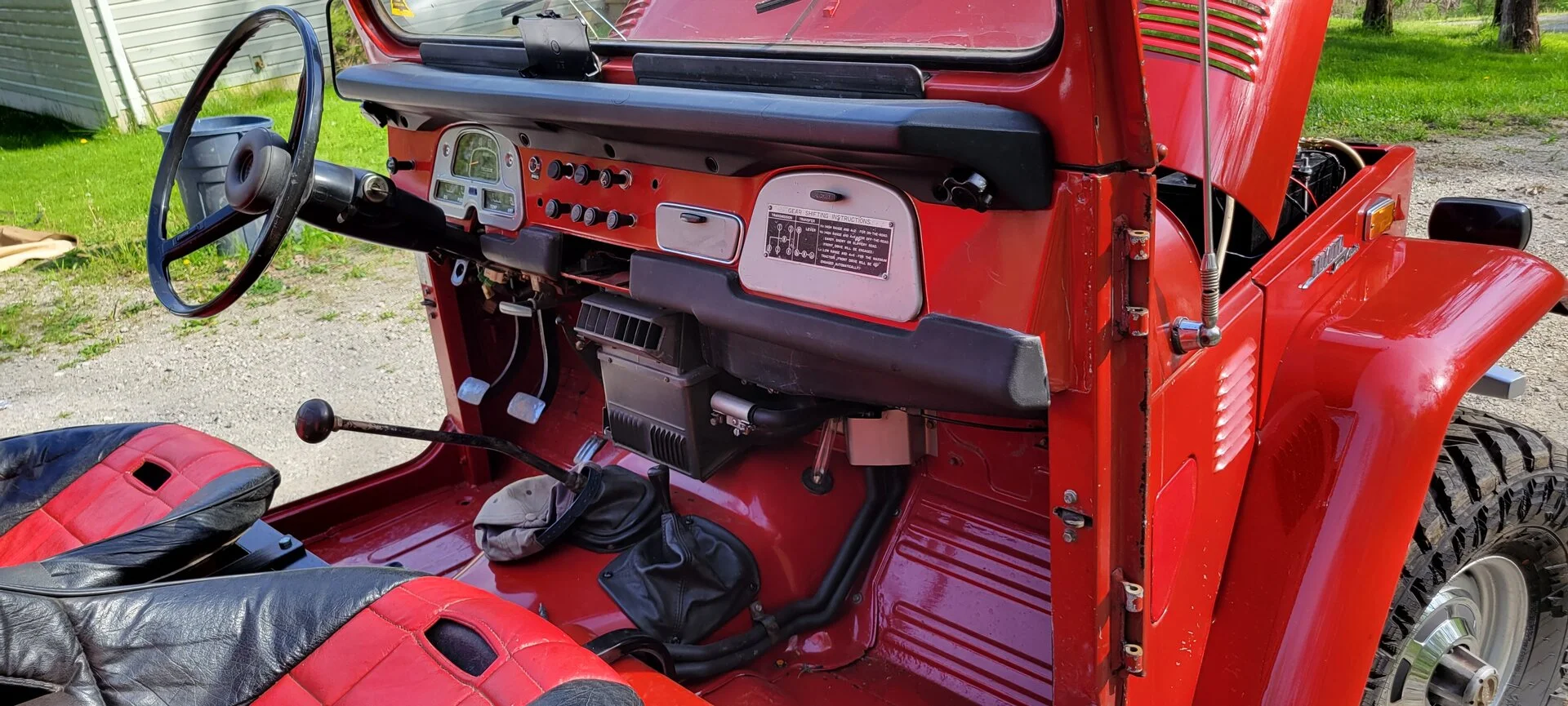

That looks just about like my 72FJ40, I think my junctions are more "Y" that a "T". That's how I got it in 82. The lines were capped because it had no rear heater. I put in a large unit from a 17 place van. The hoses are 2 different sizes like 1/2 and 5/8 ID. Love that rear heater - 20 below and I can drive around in shorts and tee shirt with the windows down.
