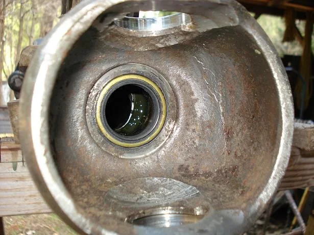

I took a look at one of my front Cruiser axles and it does have the bushings you mentioned also has holes in it at 12 and 3. I have included a few pic (sorry about the quality) the first one is looking in from outer end, the second one is looking through the axle and seeing the inside of the bushing on the other end (long end) both ends of my axle have these.
Cheers,
Michael
