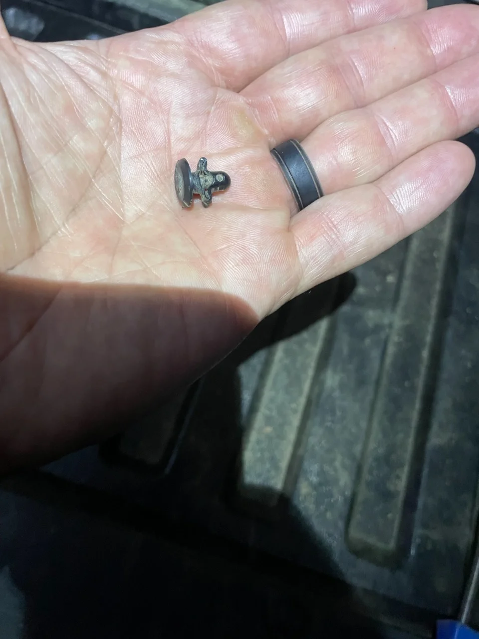

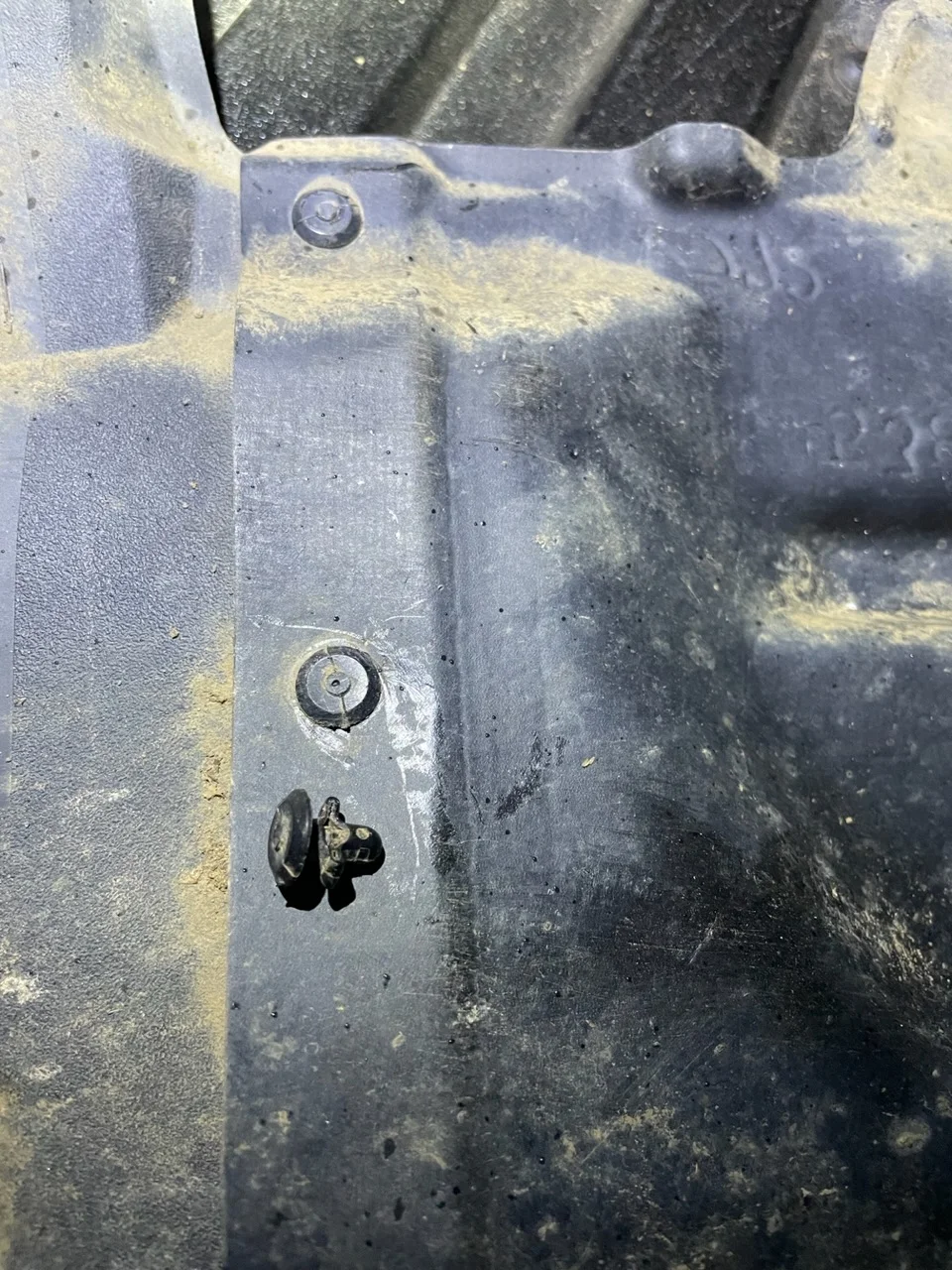

The front parts of my front fender liners were trimmed to clear larger tires on my 2015 and they won’t work with my TJM bumper I’m moving over to the 2015. The liners are in two pieces and attached by plastic “rivets” that appear to be single use.
Are these single use rivets or is there some trick to unlocking them
You can try pushing the smaller inner broken off post back through the flange, but I don’t see how you’d re-use them once that is done.
Sadly I don’t see a part number for those in the diagrams.. the whole liner may only come as an assembly with them installed.
Go get yourself some rivets and a rivet gun and replace at your leisure.
Look for rivets that have a plastic head instead of aluminum but still an aluminum stem. I know Volvo uses rivets like that for the mudguards/liners, but I saw similar ones on amazon a while ago.
P.S. you may also need some aluminum washers to use with the rivets if the liner holes are too large.
