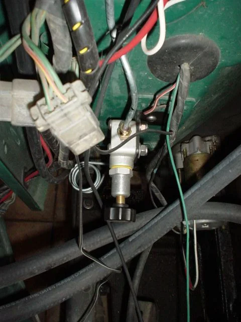

Just put a JT kit on my 74...they work great with no proportioning valve...I removed the acorn shaped valve that was in front master cylinder...works great.
BUT...you will need a grinder to work on the calipers where the banjo nut goes in...AND, you will need to get the circumphrance of your spindles ground down at a machine shop (cost me an extra 50 bucks) so they will fit in the rotors...

Would you recommend the valve on the existing m/c, or should I definitly change the m/c and use the valve also?
I'd use the Summit valve on the new master cylinder. I don't think the stock proportioning valve is adjustable enough. It actually made plumbing easier on my installation. I have mine set to minimum pressure to the rears.
