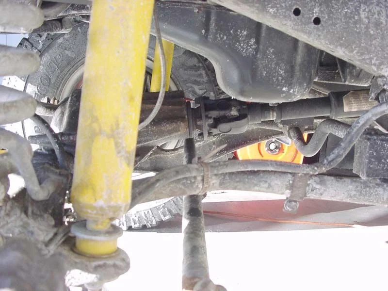

My idea is still the same but I'm clearly odd man out. IMO because this is a full time 4WD setup both shafts influence each other. I beleive everyone with this problem has a DC shaft up front that is not set to the proper pinion angle but has gotten rid of the vib problem by finely tuning the rear shaft. Most would say that it was a rear shaft issue all along I however beleive it to be the front pinion angle as the root of the cause.
Best of luck.
BTW this is what a properly aligned pinion should look like for a DC shaft.
WOW, YOU GUYS ARE ON THIS! THANKS MUCH!
We haven't been able to try anything because the thing went Phx for gears and lockers. They said they would try it with the rear shaft out and report back to me. I don't intend to have them troubleshoot this, though they will have the shafts out and in anyhow.
When it comes home I will add 20mm to the front. My angle does NOT look like Rick's AND it happens to be at that BAD number "23" Rick threw out on a previous thread.
If vibes are still there we'll go on a total search for issues. If not arise, the DC rear shaft gets ordered.

I just see things a little more black and white. If the front shaft is setup wrong and generating a vibration then adjusting the rear pinion to alleviate the problem IMO isn't fixing it but compensating for it.
If I though the rear pinion angle was at fault I'd take the readings of the flanges and then determine if it needed adjustment and then adjust it to spec and nothing more.
Like I said, it's black and white for me and installing adjustable arms and futzing with angles in hopes for a good result really isn't my style.
