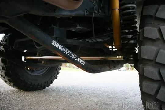

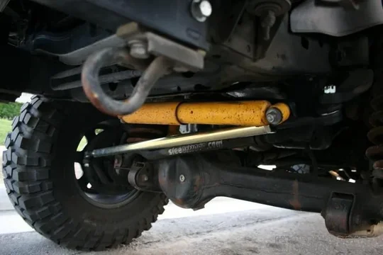

A a word of advise. For the cost of having a shop swap out your TREs you could buy Slee’s HD Tie & Relay rods. Hell it may even be cheaper then having a shop do it and you get sexy gold bling for your ride.
If you do it this way it’s way, way easer.
Most people struggle to remove the old TREs.
https://forum.ih8mud.com/80-series-tech/274418-when-tres-tierod-become-one.html#post4271890
I did it myself and it only took a couple of hours.
